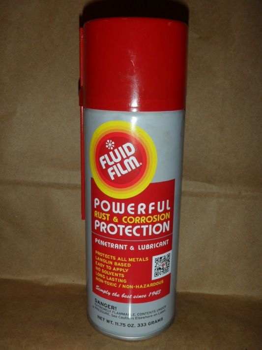

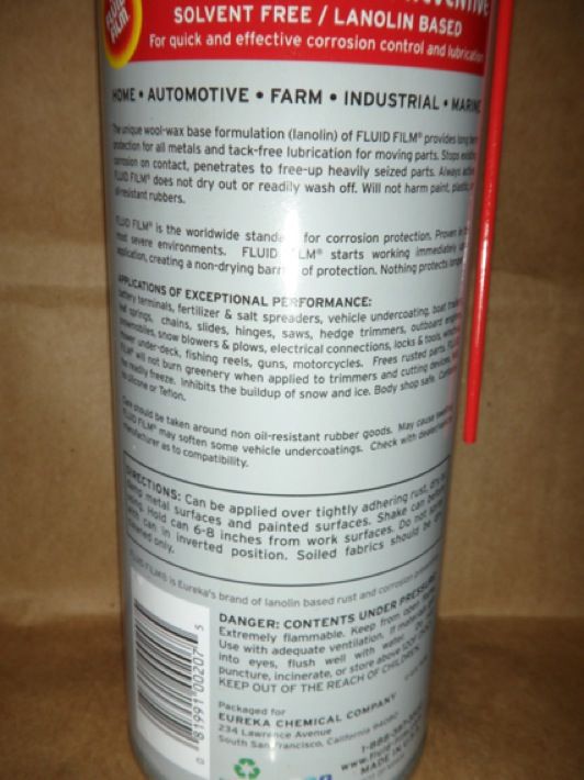

I thought I'd share another tool for the toolbox:
At the local NAPA auto parts store, I found Fluid Film lanolin based spray lubricant. The partsman said that it was used by a lot of local farmers for corrosion control on equipment.
Being that it was paint safe, I thought I'd try it- especially for my classic trucks. Using it where I'd normally use lithium spray (i.e., latches, door hinges & tailgates), it penetrates quick and seems to have good staying power. The label states uses from guns to snowmobiles to inhibiting snow and ice buildup.
Reactions: KE4EST and Titanium
Actually I don't think Fluid Film is what I would call paint safe...
I've used it in the past to remove paint on parts that require press fitting etc. Just spray on and leave for an hour or two, and the paint scrapes right off... Really handy for removing paint without having the bare metal rust from moisture/air contact when using harsher chemicals or heat.
It IS a great lubricant and rust penetrant. Just be careful where you spray it!
Thanks for the info. Thus far, on automotive enamel, it hasn't harmed or softened the paint on any of the areas I've used it. But will take extra precautions in the future.
