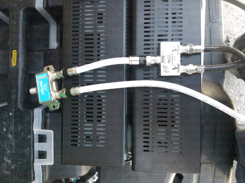

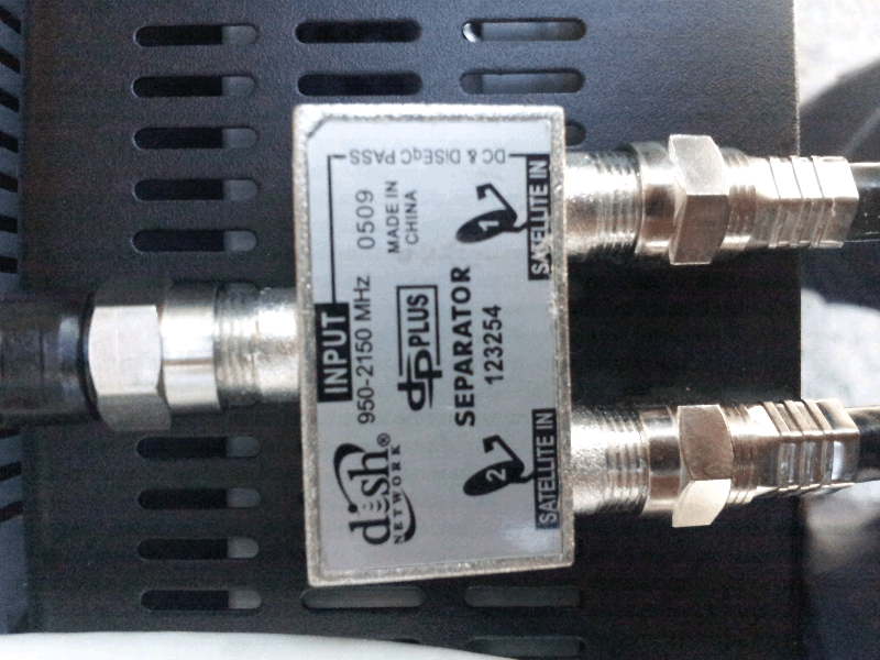

A separator is not exactly a splitter. You cannot use a splitter in it's place, it's it's own animal. The separator allows one coax to go to a dual tuner DVR. It takes that coax for input, and outputs two coax that are plugged in to the receiver. You can run a separate coax from the dish or switch to the second DVR. If the second unit is also a dual tuner, you use another separator there.

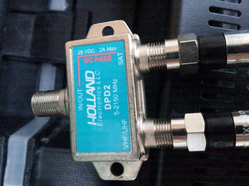

You need diplexers buddy. Connecting a cable from your tv directly to your lnb will not get you anything but a headache.
Sent from my SAMSUNG-SGH-I727 using SatelliteGuys

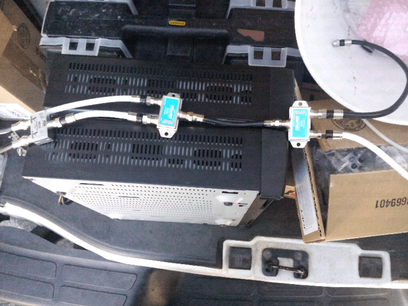

These are pictures of parts you need to make a dual tuner work on two TVs using only one cable for signal path from dish location to reciever location. And the proper way for them to be connected in the cable and on the reciever. I am currently on my phone or I'd describe what each picture represents
I'm sure somebody else on this forum can do that.
