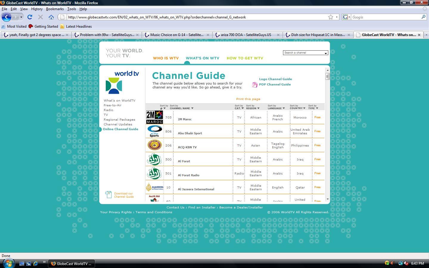

also Globecast's site shows it free on 97W

actually you gave me 2M frequency in 97W, i need to know if it's still available on 30W
I beleive it was not there last sunday as I had to re-locate the Hispasat dish for a friend. I remember I saw TV Marti and the Arab channels but 2M Morocco had a black screen on his receiver. Other TP's were also working ok. I did not re-scanned again anything as the Spanish channels were all working. I guess they removed the channel recently then.
