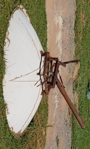

Ha, well, I've not heard back from the owner yet, so...I don't know if I'm getting it...or any answers for the mount question. Judging by the one pic included in the listing, I'd say that it in effect has no mount as it looks unusably rusty.

Since you brought up the mount...and its mount is screwed up and will need to be replaced, may I have a recommendation? How have you(+others) mounted yours?(I'm going to run to the search bar to look for posts)
If you can take a picture of the back of the dish so we know what's there. It's somewhat easy to fabricate a stationary mount, but if you want a polar mount it is a bit more tricky. I just used the mount that came with the dishes, but one of mine is a bit of an odd put-together of various parts that were kicking around.
Before worrying about the mount, do a string test on the reflector. If it is bent or warped, there might not be any point in trying to fix it up. Tape two strings over the edge 90deg apart so they cross in the centre of the dish. If they (just) touch or have a very small gap <1/8" then you are likely good to go. If the gap is larger then the focus may not be accurate. I'm afraid if the mount is messed up, damage to the dish may have occurred as well.

I'm not sure that it's bent or anything like that...but, it sure looks to be unusably rusty. The dish may be in ok shape(literally)

Hmmm... that doesn't look too good, sitting on the ground with that heavy pole weighing down on one side. The mount might be ok, is it bent from pulling it up? Otherwise it might just need to be disassembled, cleaned, re-painted, and re-assembled with new hardware (bolts etc). The dish you won't know until it is separated from the mount, or the whole assembly turned over (very carefully). Best to remove the pole first. It's likely rusted into place and bolts seized, some heat and penetrating oil required.

Yeah, it looks ugly. I'm new to this, so I'm doing a lot of guessing. I'm guessing that they left the mounting pole top open, rain entered, the pole subsequently rusted through, and the dish then fell. Plus one(I agree) on that penetrating oil(I will try Liquid Wrench™). I'm bringing an impact wrench too. I like your idea about stripping the rust and repainting...but, if it's a lost cause, I'll be open to buying a new mount(and stainless hardware...I HATE rust)
I don't know for certain, but I doubt if new mounts are available for that dish. If I were you I would do everything possible to recondition the existing one -- unless too much of the metal is rusted away and its lost its strength and won't hold the dish's weight.
But a new pole should be obtainable from a metal pipe company.
