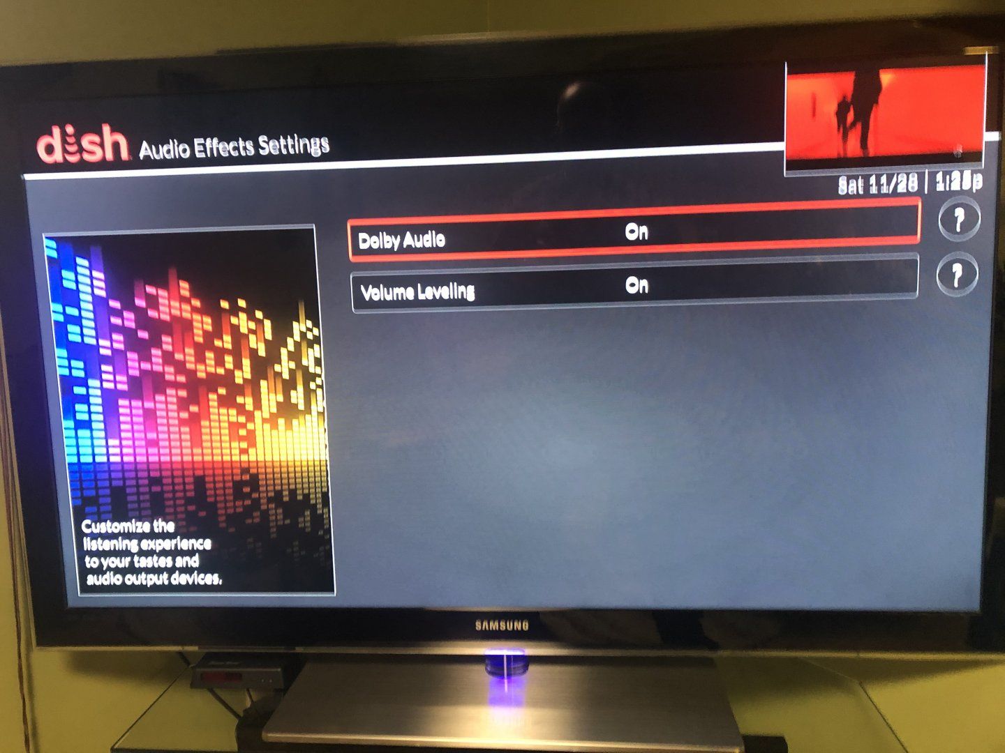

If the HDMI Pass through setting you are referring to is the setting in the attached photo, then yes.
I tried swapping out HDMI Cables, swapping inputs on my AV Receiver, rebooting hopper and Joey. Swapping this Joey for another. Checking all settings on my AV Receiver. It is set to "Auto- Decode".
Any thoughts or advice would be greatly appreciated.

That is the setting, yes. We do want to keep that "on". Thank you for taking a look into that. Have you tried to change the Volume Leveling to "off"?
Yes, tried that before and received no joy. I just went in again and switched it to off and then rebooted Joey. Magically, I have joy. Hopefully I'm good now.
seems as though the VL off + reboot did the trick. Go figure. Thanks.
