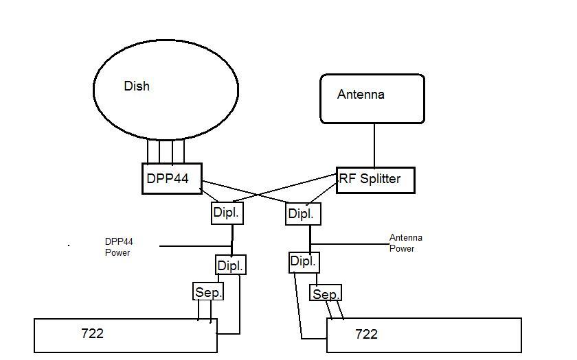

I realize this thread is a little old. But, I am planning on installing a Dish 1000Plus w/DPP44 and amplified OTA antenna. This will feed 2 dual tuner receivers.
From what I have read above, and elsewhere, it seems the Holland blue diplexers will pass the DPP44 power OK from the supply. But, I'm wondering exactly how to feed power to the OTA antenna amp.
I have attached a crudely drawn diagram of what I think might work. Then again, I wonder if using two different power supplies, one for the DPP44 and one for the OTA amp, in the same setup will even work. Is it possible that the DPP44 PSU can power both?
In any case, if some of you installation experts can take a look at my horrible diagram, and let me know if it would work or if it needs correction, I'd appreciate it.

The OTA power inserter should be upstream of all the diplexers. Most diplexers don't pass power on the ANT side.
If you can get it above the OTA splitter, you can avoid possible trouble having to correctly install a power passing splitter.
