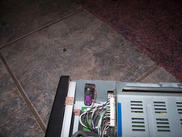

I wasn't referring to changing the "original" battery while plugged in. But, more towards how mine is set up in the pic of post #9. I have a holder but no spare.
Well, I assume what your plan is that you will keep it plugged in and then swap out the battery. If that is confirmed to work, then I agree, we don't need a spare holder and we can swap things out carefully while the system is "hot".
I have the impression that you have precious seconds to have that battery replaced or the 4DTV will be a doorstop.
I would prefer having the receiver unplugged while changing the battery for the first time (especially while soldering). I think I would change the battery while the receiver is unplugged for now on. Better safe than sorry...
