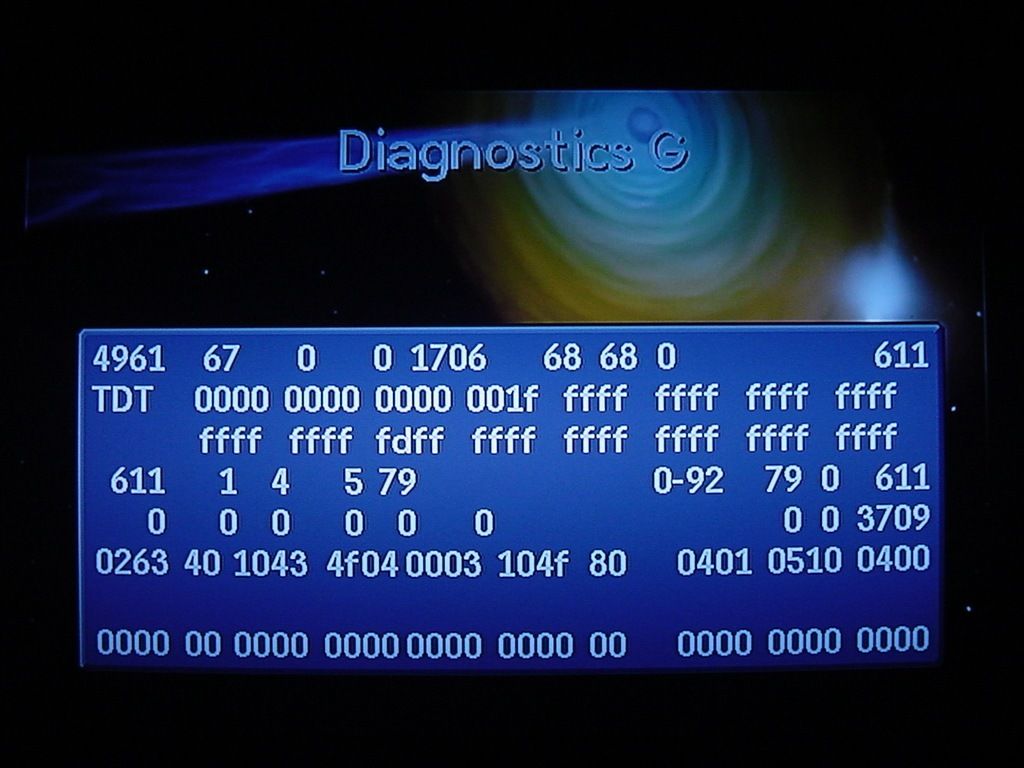

I broke this off to a new thread from the DMX discussion. Stargaze thought it was impossible to have a TDT over 1920. But mine is 4961 and has no issues. Can the 922 go higher than other models?

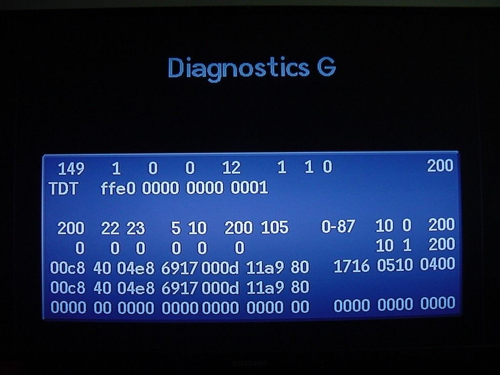

I hooked up a spare DSR410 from WSnet and it had only 149 mapped in from W5. Which is about what I would expect.

1920 is max. Yours is 1706. It's the middle 4-digit number at the top of the screen. :)
Thanks for clearing that up. I was making the mistake of looking at the number above TDT. :rolleyes: I learn something everyday.

According to the picture from Corrado in the post above here they were on channel 611 on their 922 receiver and they had a TDT count of 1706 as tvropro has stated.
On the 410 receiver their TDT count was 12. This is because the 410 does not receive all the satellite maps that the 920/921 or 922 receivers have in them (which includes the generic satellite mappings)
