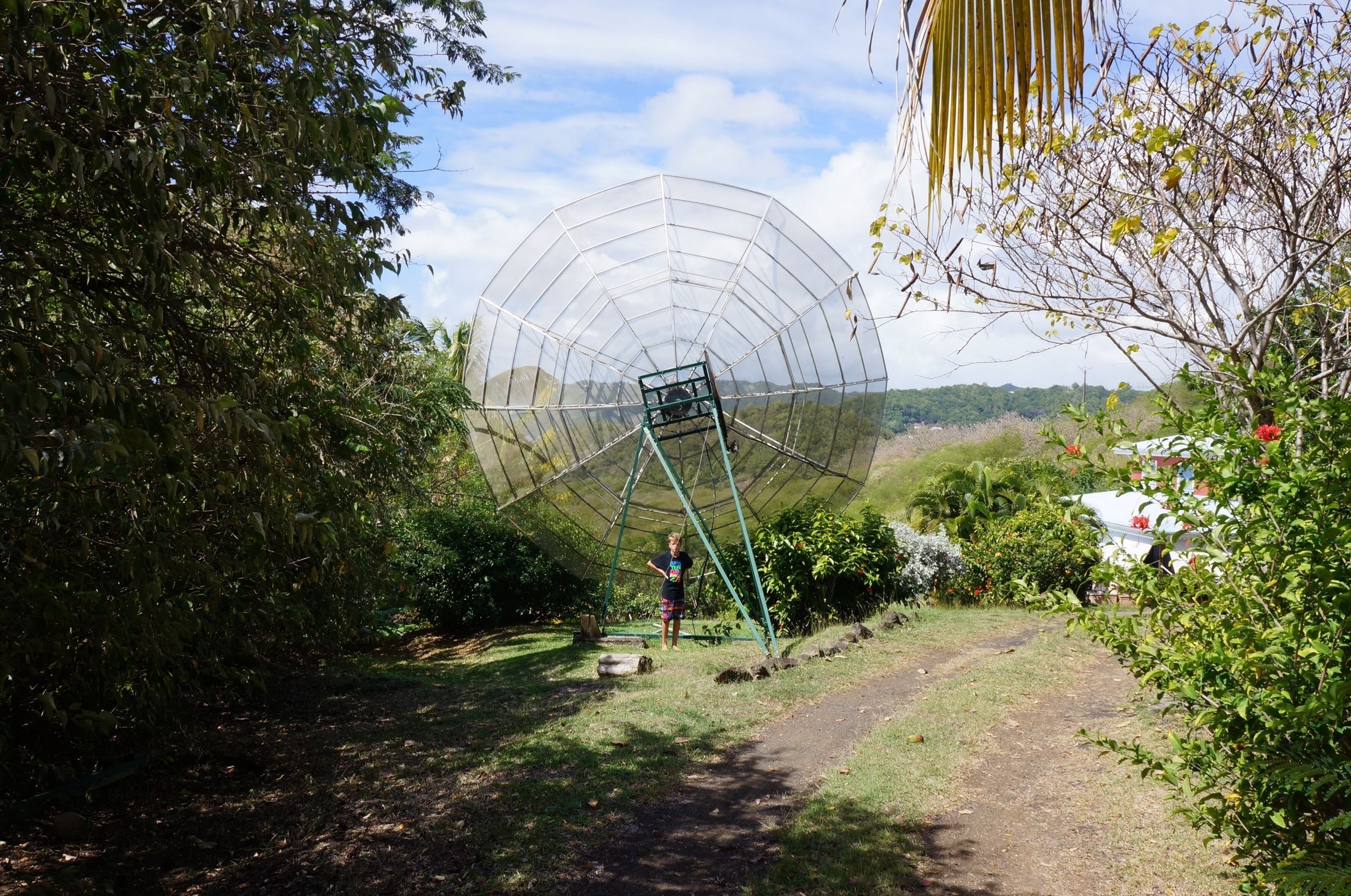

Boy, how about some pictures??
LOL, 22 feet... maybe that's how far it is from the house. If it's the diameter of the dish, how 'bout some pictures?

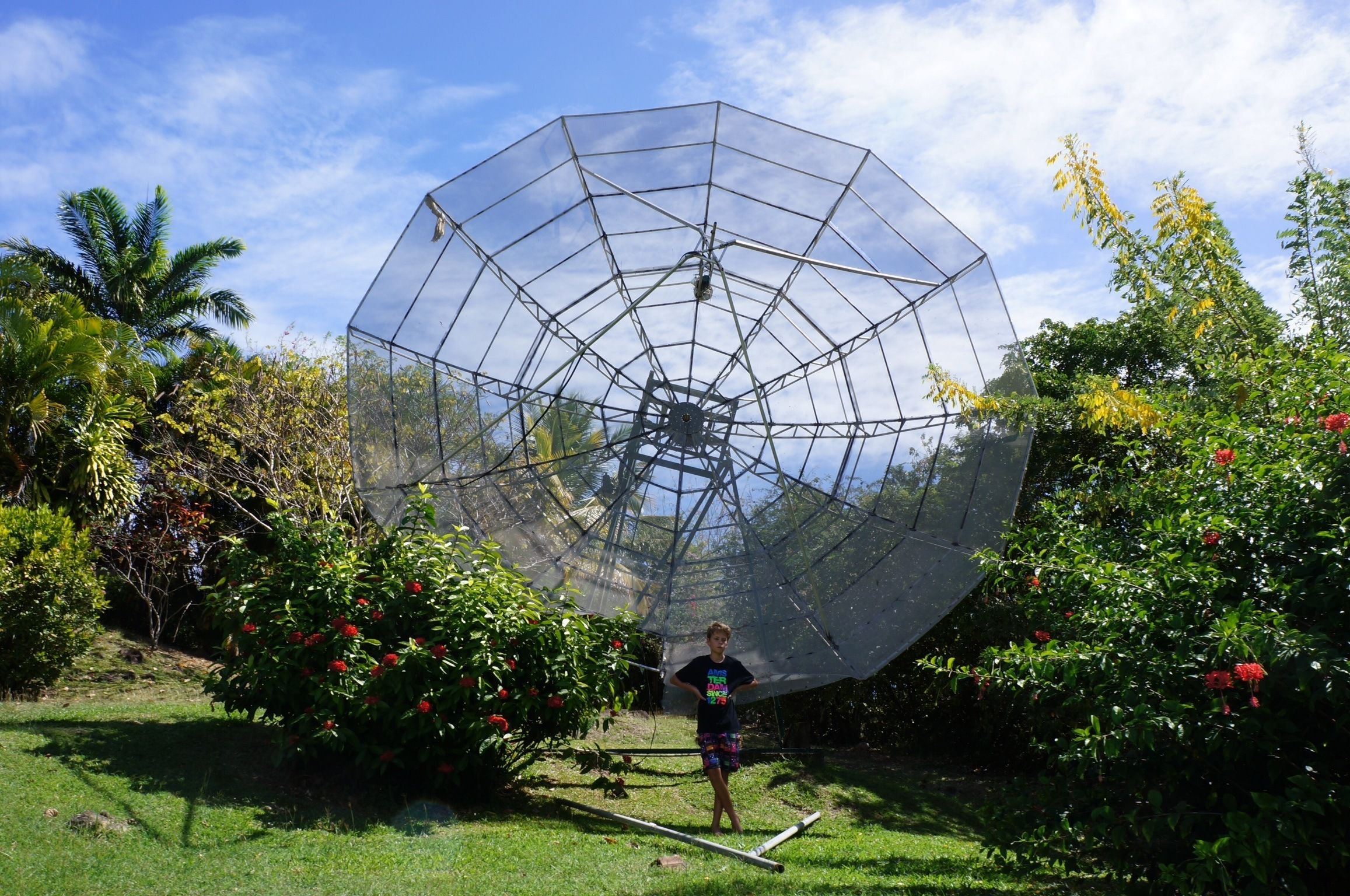

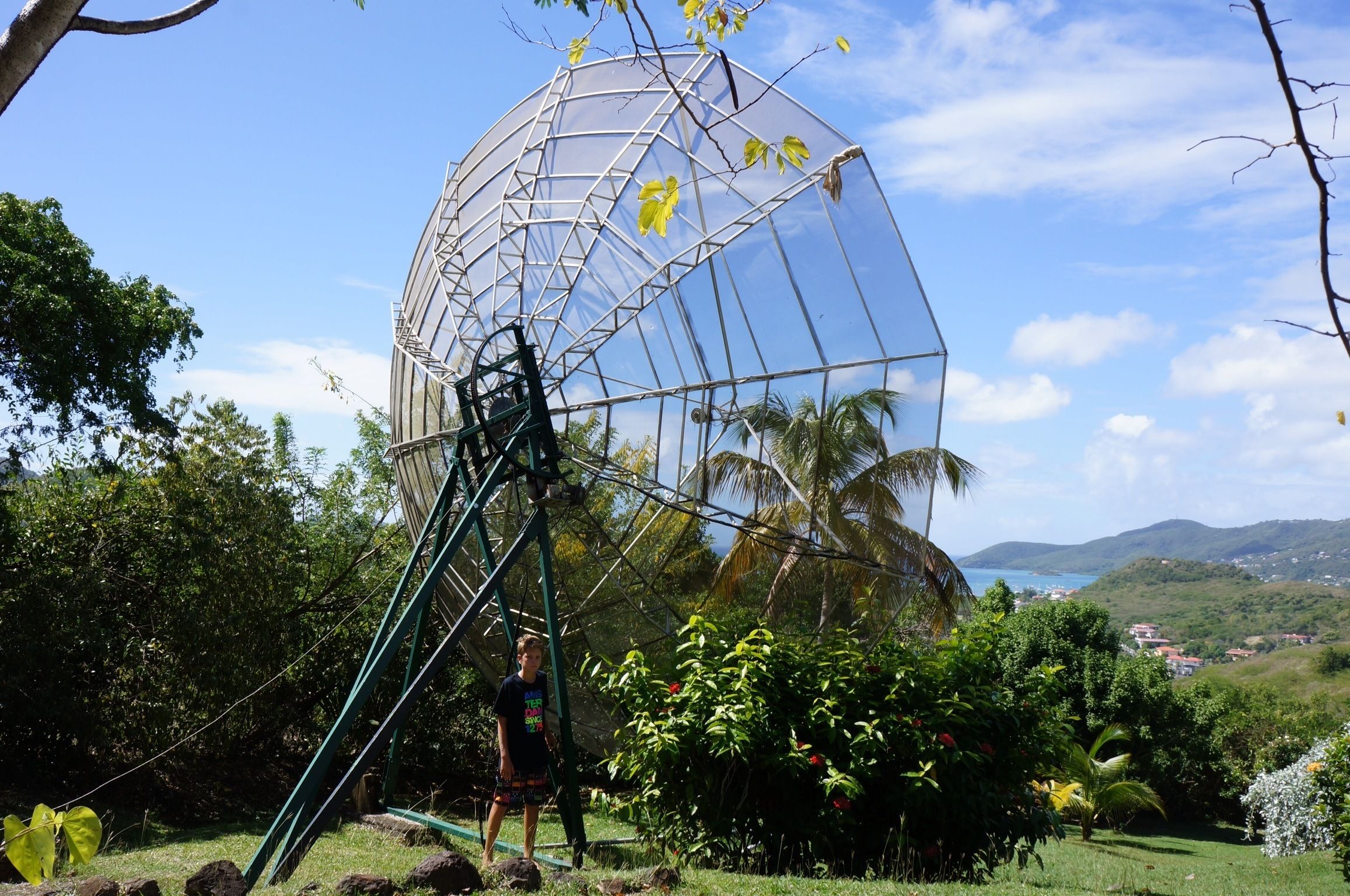

The bud is cband only mesh with some scratches from hurricanes.Ill post pictures as soon as possible.

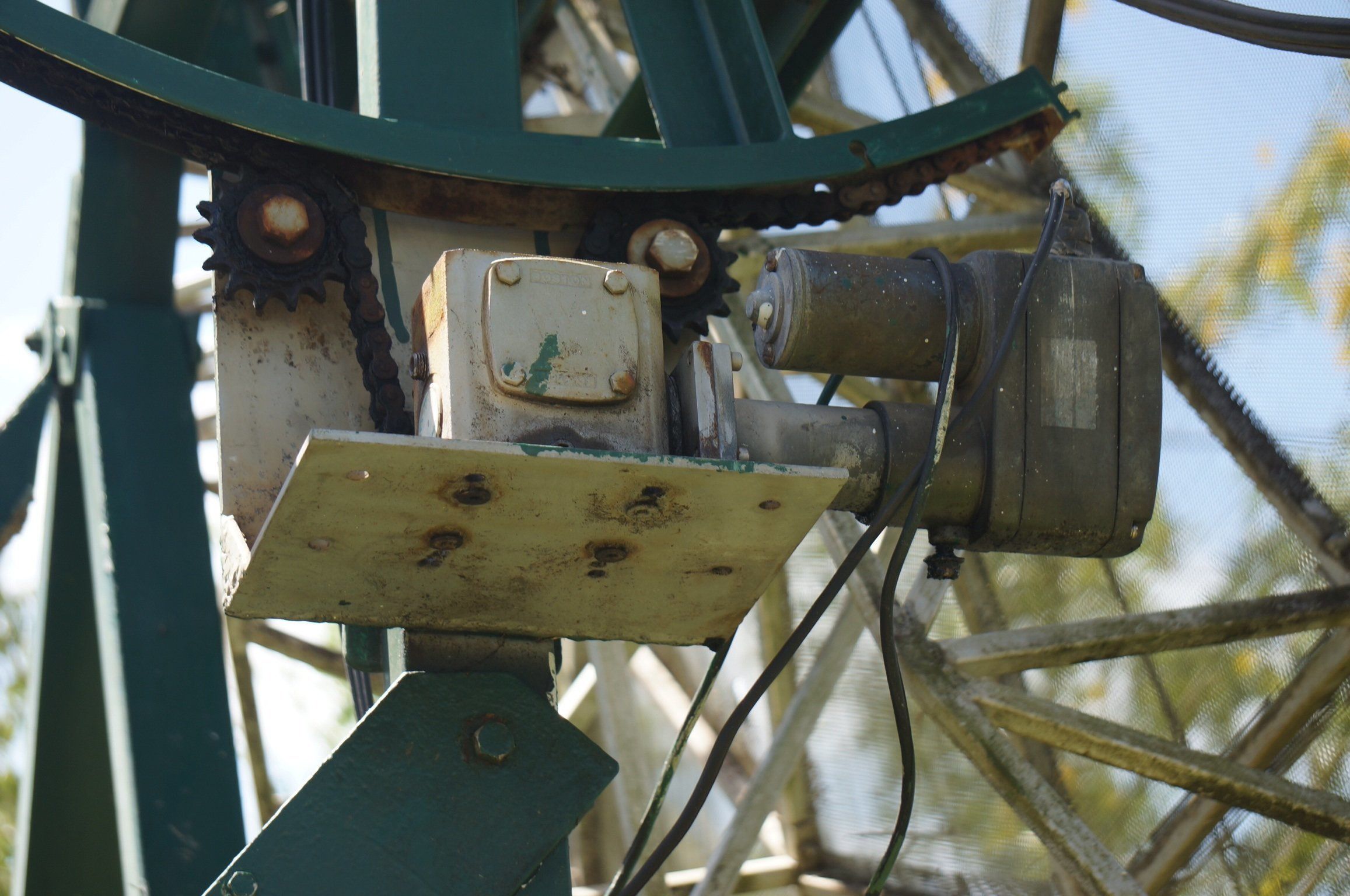

BEAUTIFUL Dish! (And scenery) HtoH no less. (Ya think I could fit it in my luggage?) I'm sure a V-Box will move it for you. Motor appears to be a standard 24 to 36 volt actuator motor/gearbox assembly. If it's higher voltage, which I doubt, there are solutions.
Only problem is, that I see, is you were using the DCII to operate the polarity servo. There's solutions for that also.

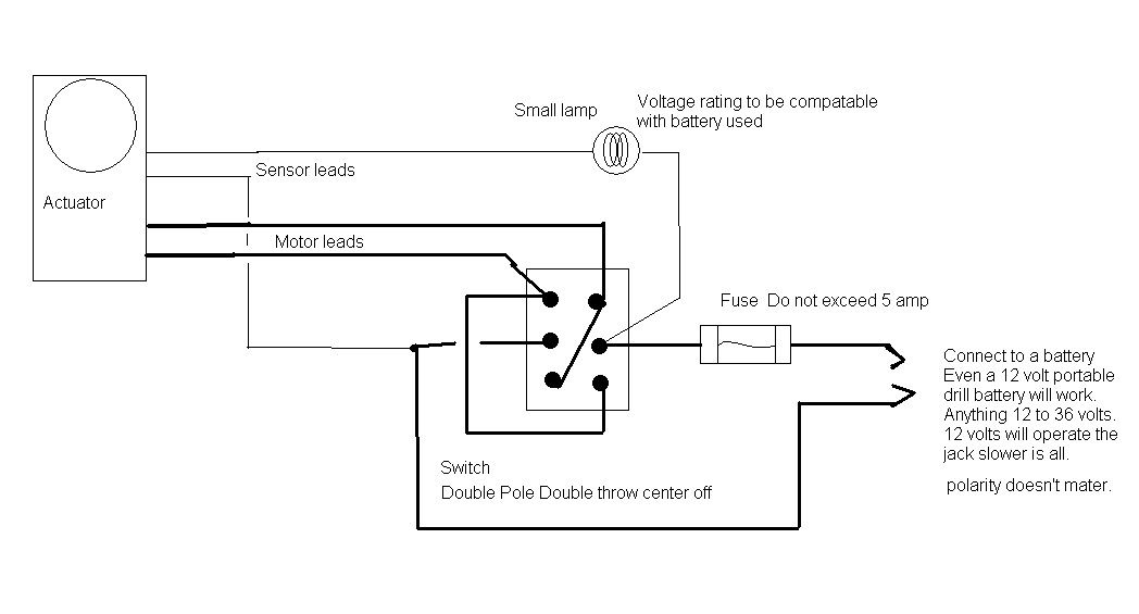

To move the dish in the meantime:
(The lamp is only necessary if you want to 'see' it moving)

You are right it is H-to-H (10W to 135W) Motor gearbox 36v
