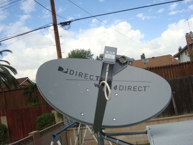

Hi All,
I set up my dish ( 36" DirecTV WorldDirect ) using lnb holder described above. I am only using one lnb and would like to make use of the extra opening, 6 degrees apart, for a second lnb. The dish is set up at optimal settings for AMC4 101.
I don't know if anybody has a similar set up, but what satellite, if any, would I hit if I simply inserted a second lnb in opening available? Thanks.

You could try and get 95ºW and 101ºW since they are 6 degrees appart from each other, since 107ºW Ku doesn't has a lot of feeds.
Cheers
M.
Maybe he could even target:
89-95-101ºW using another LNB in the other side of the dish.
89 has been having a fair amount of baseball feeds from spring training as of lately (I've seen: Angels, BoSox, Yankees and some Seattle i think it was, wildfeeds).
Cheers
M.
