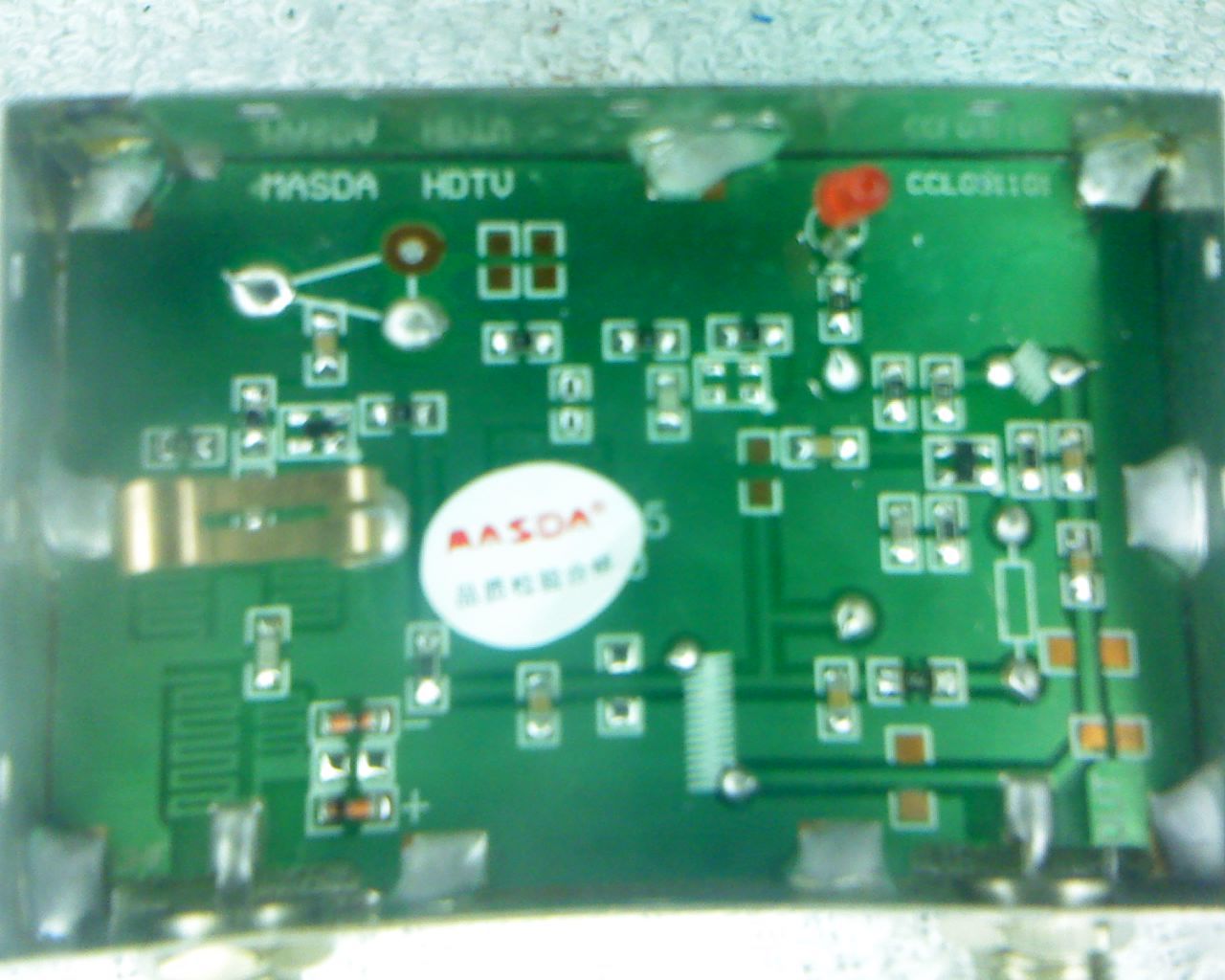

MASDA Antenna Amplifier

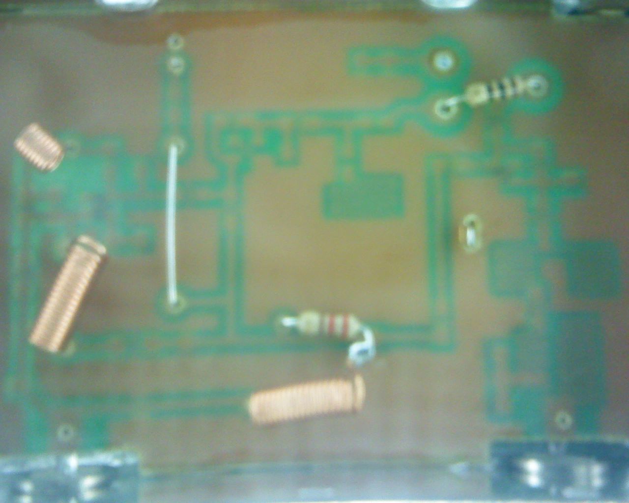

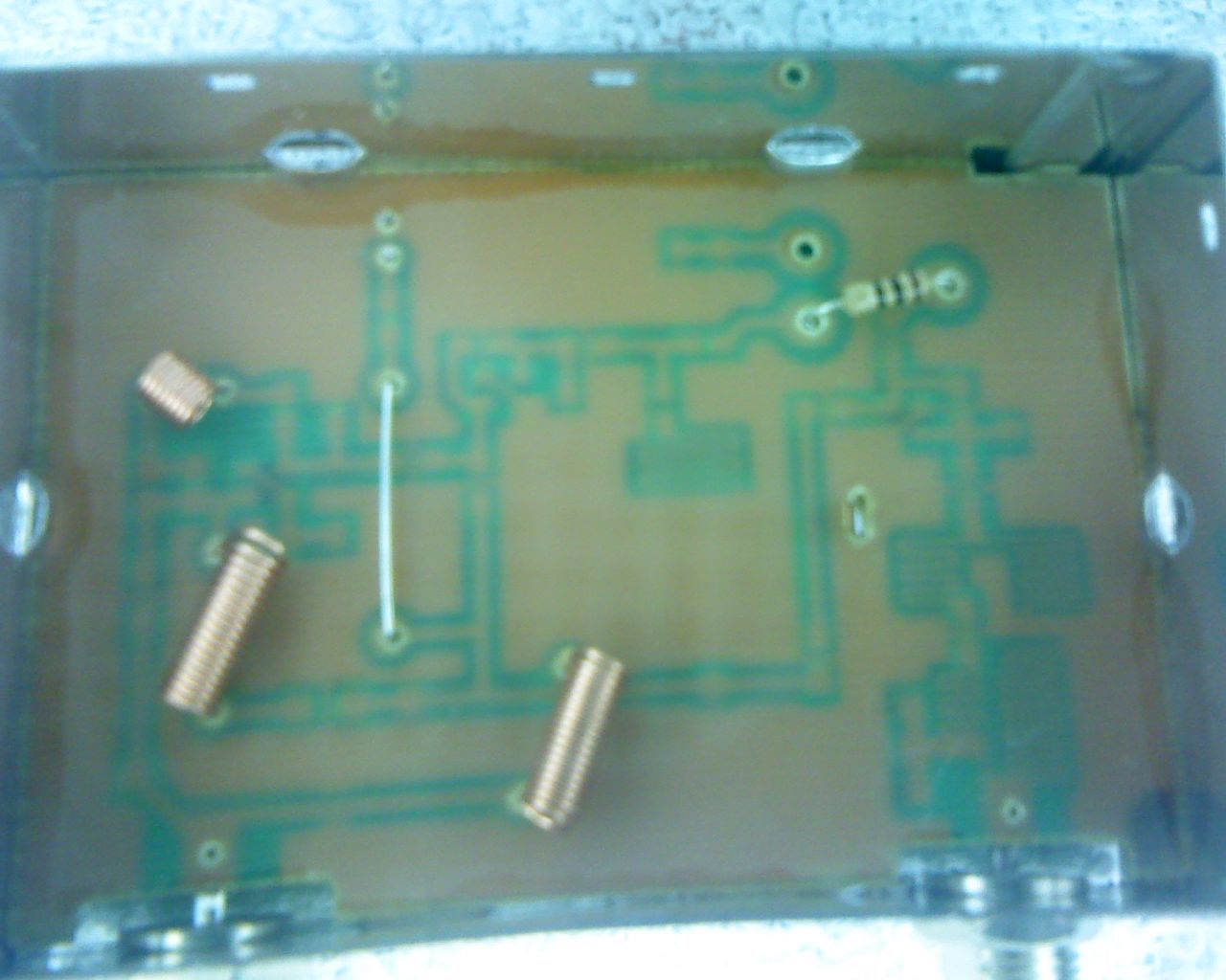

The sunwalleytek 30db UHF amplifier can be powered from the Rotor100 motor using this modification.
Open the amp. up and put a 220 Ohm resistor in series with the choke that supplies power to the amp. (see pics.) The Rotor100 is designed to shut power off to the antenna if the load cannot support 18V at 50ma. The amp. runs at 12V at 40ma. The resistor drops the 18v and provides the correct 8.5V to the MMIC amp. Cut one leg of the LED to further reduce the current draw in the amp.
On a strong signal strength of 72 on the ATSC box the signal is raised to 85 by the amp. but does not overload the input.
The amp. negates the 3db cable loss and the 3db insertion loss for the Rotor100 as well as its own insertion loss while providing substantial signal gain >20db.
