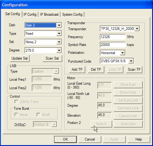

Here is my setup for the Free To Air VUHD channel on Nimiq2:
