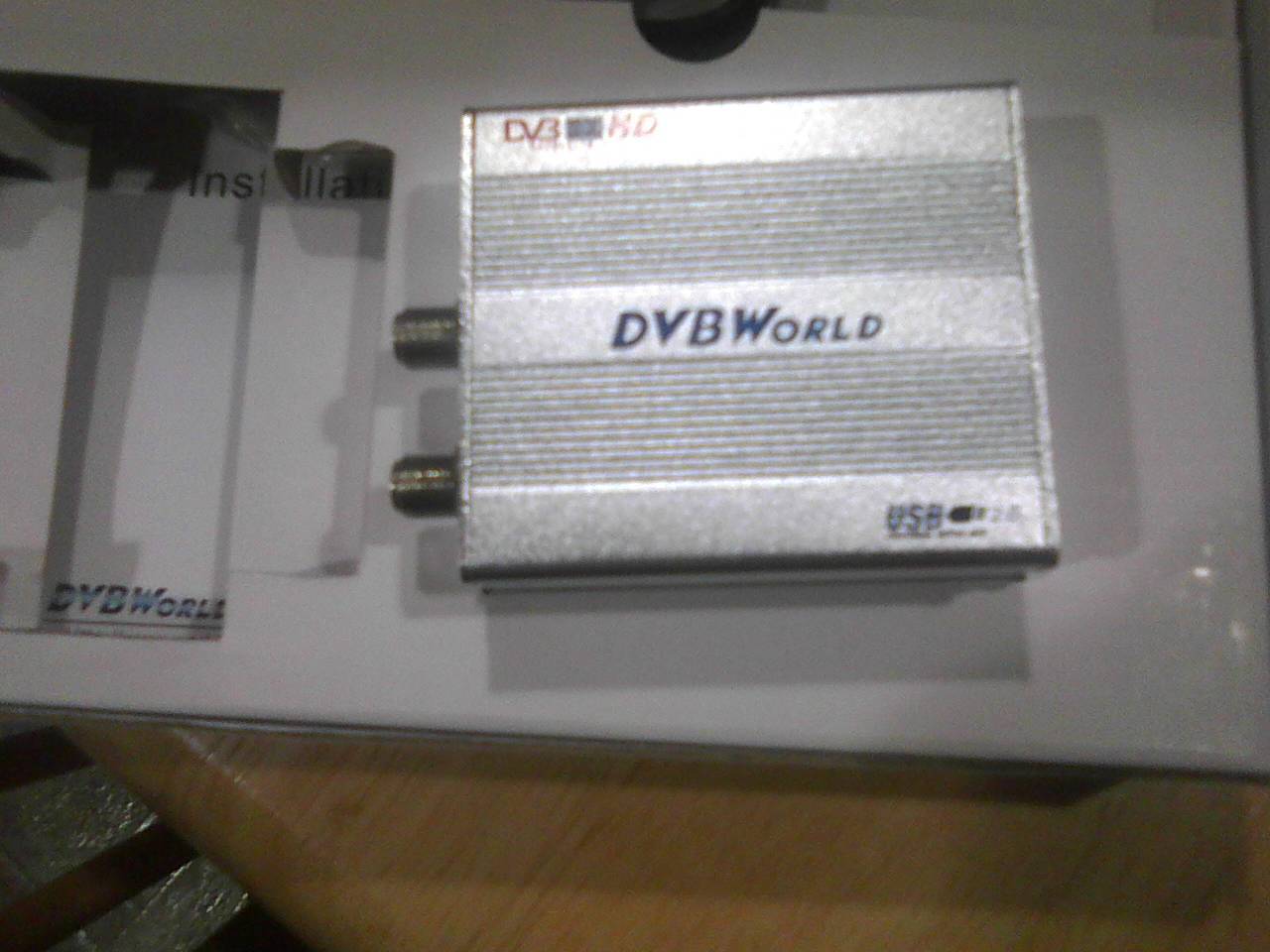

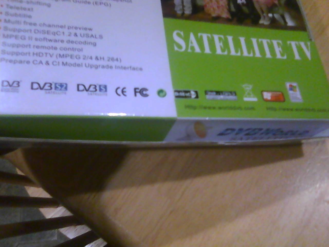

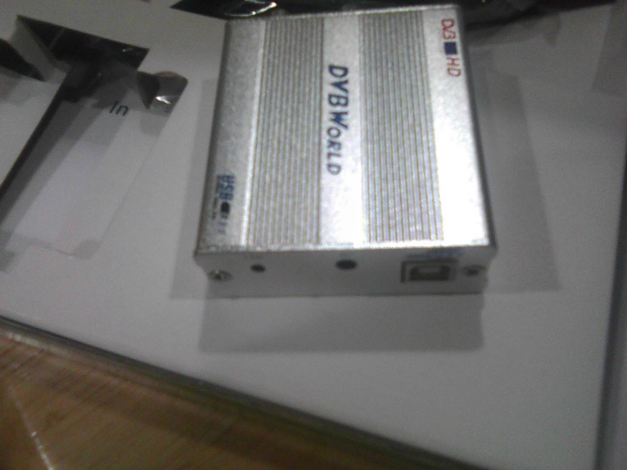

Sad to say, I got the wrong one too! I will be getting intouch with them tomorrow.:o:(:mad:

what kind of operation is Sadoun running? I mean it is ridiculous
I have to call tomorrow during business hours...tried to call at like 8pm and someone picked up (think it was Sadoun, if that's him in the youtube video) that told me to call back from 9-6pm
I dunno what to say this isn't cool at all how we all got hosed
You guys are scaring me. I have one enroute. It had better be a D model which my order form clearly shows. They messed up my last order.
Ok cool I called up they're sending me the right one too...with a return label. No timeframe given though, hope it's the right one this time!
