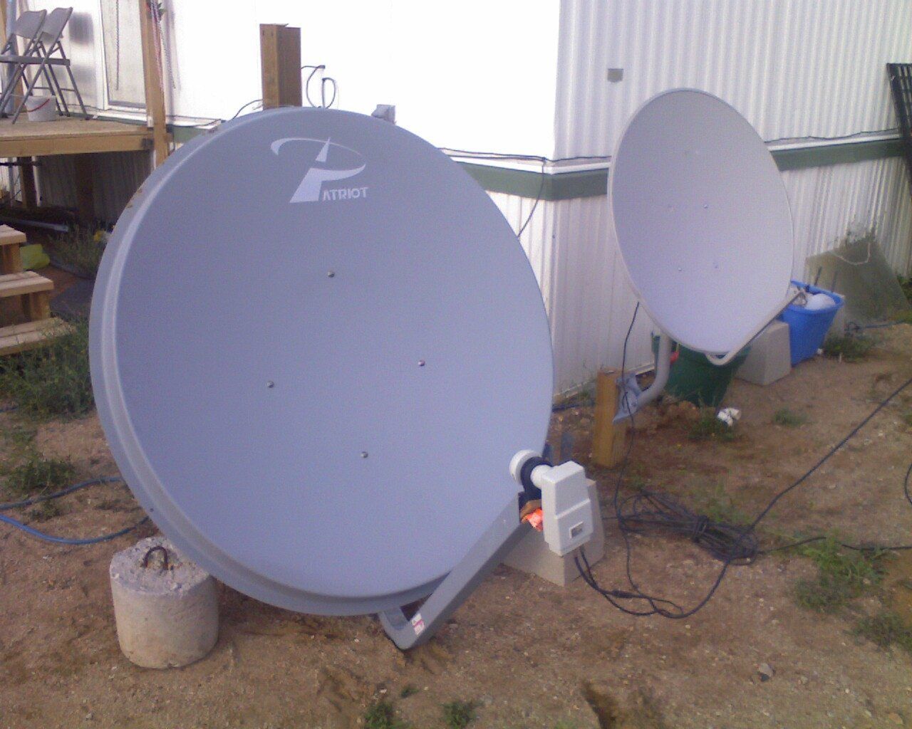

Dee-Ann, if all your interested in is getting ThisTV, you might want to look around for an unused 1.2m KU band dish. I have scored two of them in just a couple of months. I used one as a mini bud aimed at 99w for the Caribbean mux with great sucess (until I scored a 10 footer). If you go that route, it's a lighter dish, smaller pole, and I used an old analog lnb without a ring. Just stuck it on there and played till I got the signal, no motor, nothing connected except through the diseqc switch.
This picture was before the pole was planted, just aimed the dish till I found a signal, then replaced the KU lnbf with a C Band lnb. It worked, so I dug the hole and mounted the dish.
