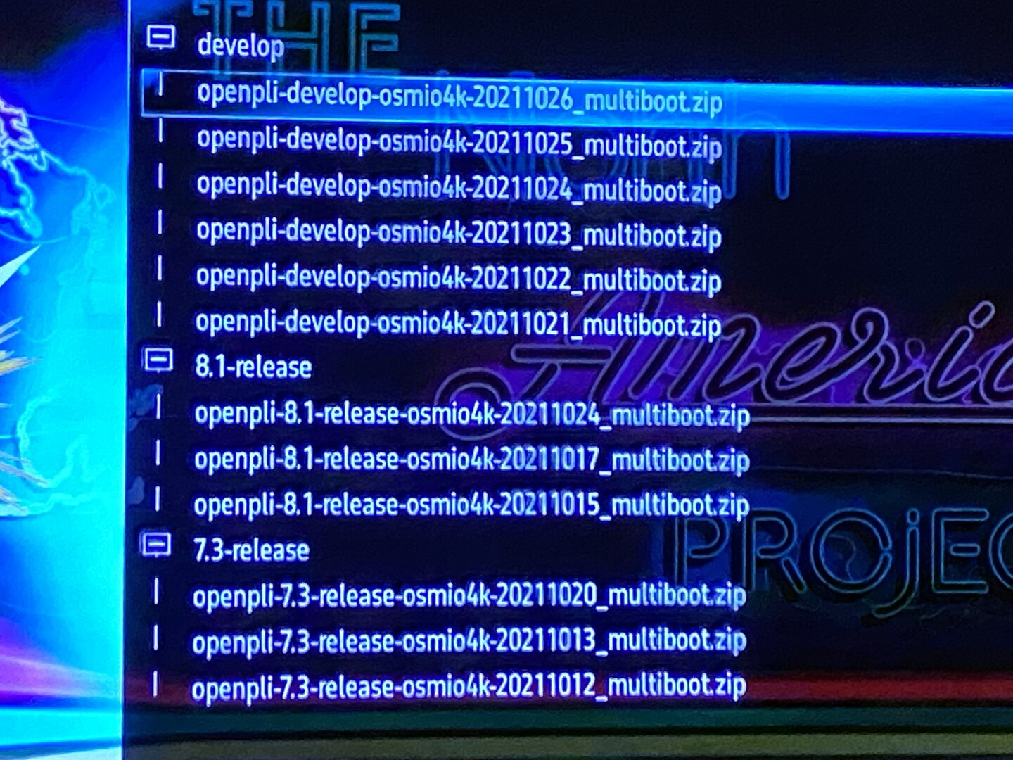

With internet access on the stb, I followed your instructions (Menu > Setup > Flash Image > TNAP-4.1 (click on the +) > TNAP-4.1-osmio4k_20210911_multiboot.zip) but saw no TNAP 4.1.
I enclosed a picture of my screen following your instructions.
John

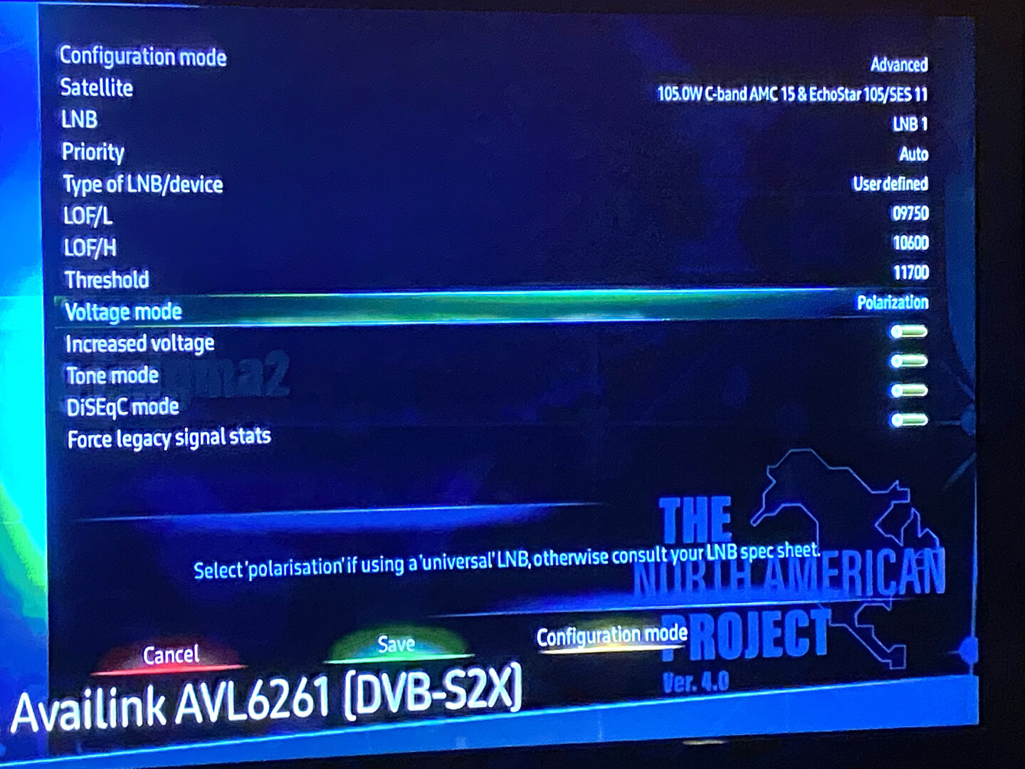

cyberham,
Here's an image of my 105w set up screen.
John
I'd recommend changing Type of LNB/device to "KU UNV 9750/10600". Now that they've added this menu item, perhaps configuring as you have with User Defined is no longer acceptable (though it was in past).
ADDED: Should be C-band config per primestar and FTA4PA below. The reason for my comment was that this is the Ku configuration error I made previously which triggered the error message reported by JFOK.
cyberham,
This is a c band satellite Im using.
John

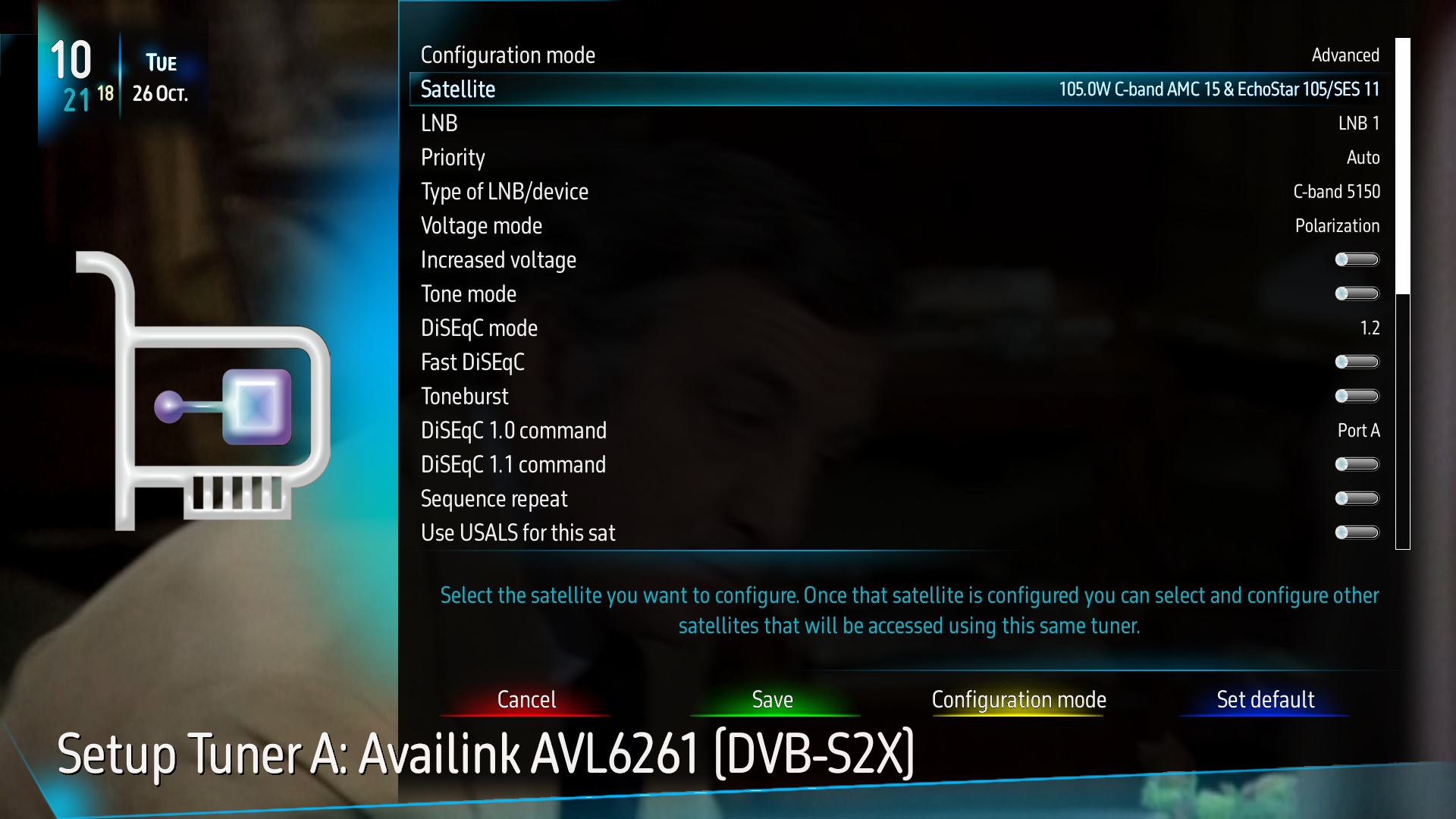

Yeah, so WHY is it configured for a universal KU lnb? Note below I have a diseqc switch, and c-band is on port 1. So change that if you don't have a switch inline right now
Reactions: FTA4PA and cyberham
