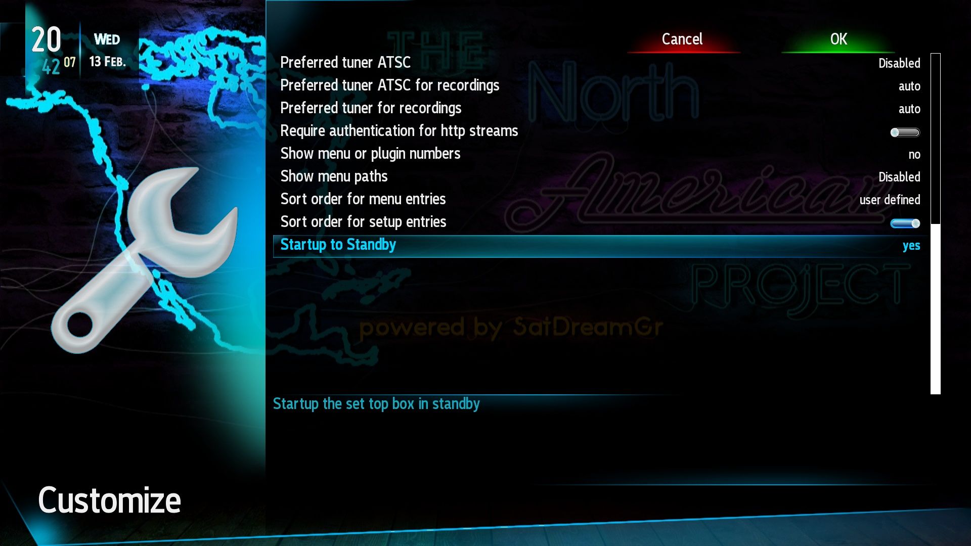

Read starting here, and EB's post after mine. Set your power off settings the same, and you should then be fine.
New Mio Owner
Basically, set "Startup to Standby" set to yes.
MENU - Setup - System - Customize - Scroll Down to find it, flip it to YES, hit Green button to SAVE.
PS: This leaves USB alive, but video goes down for sure, though WebIF remains alive. Also any G-box or V-box, etc should shutdown into Sleep Mode. If you set timers, it'll wake up, move, record, then do whatever afterwards that you set in the timer screen
New Mio Owner
It appears you are using a different version TNAP than me. I do not have the issue you talked about with the GBox. When I turn off the Edision the LNB power goes off and stays off. Unlike my other receivers when I switch to the ATSC tuner the LNB power shuts off then too. :) It was the HDMI circuit becoming active after shutting down for a short time I noticed. The menu screenshot you posted has different selections than mine. But I'm not doing any timers or recording yet. I do have a HDD installed and tested working :)
That's odd. It was the same in the RC version I had when EB posted that fix, as it is in the FINAL image, which is in a different slot.
Oh, YES, the FINAL image has some additional add-ons on that screen that my RC version didn't. I just was lazy and re-posted the older image from the RC version. However the Startup to Standby feature is still there on the second page, a little higher up on the choices.
