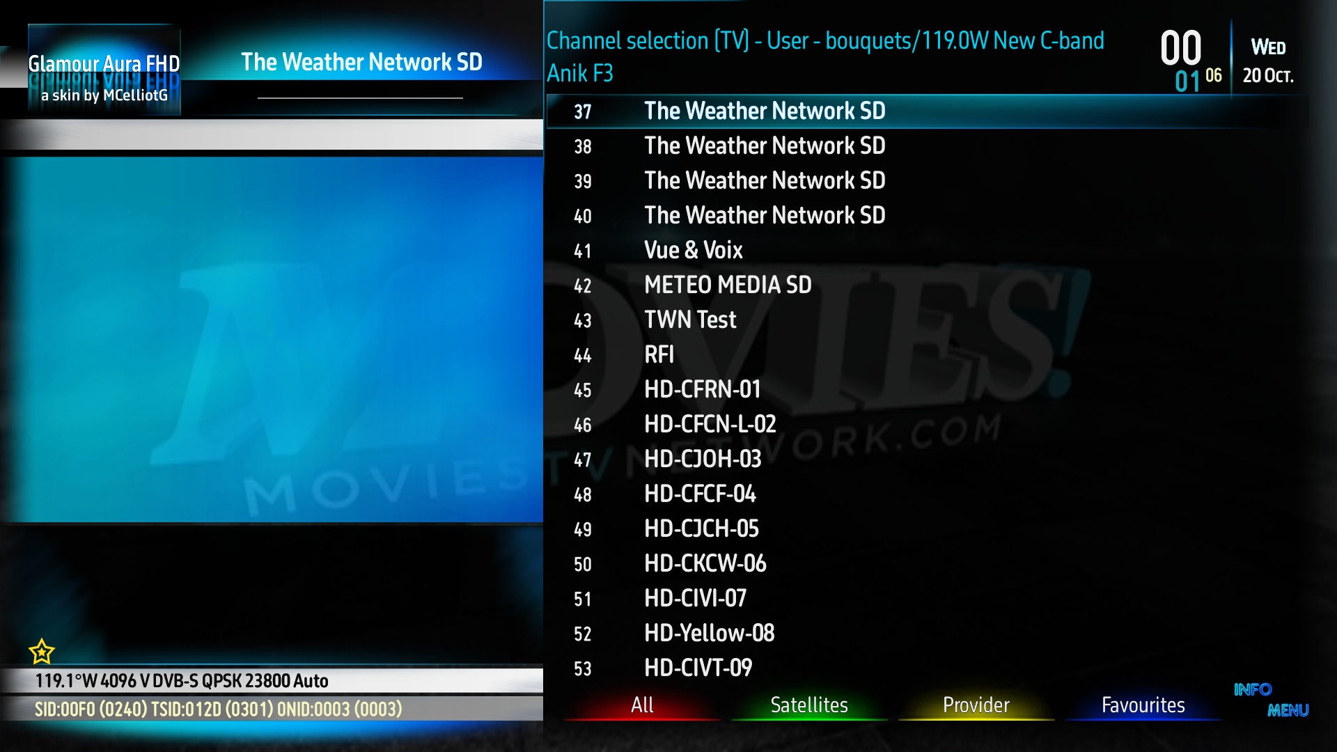

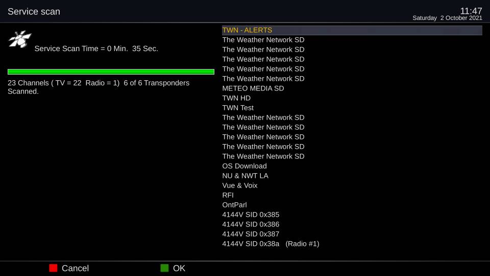

looks like 119 is back to normal... This is what I just scanned:
< 'DVB-S2 16APSK 3760H / 30001 / 9/10 MIS 1' > Tp# 1
< 'DVB-S2 8PSK 3800H / 30001 / 3/4 MIS 1' > Tp# 2
< 'DVB-S2 8PSK 4020V / 30001 / 5/6' > Tp# 3
< (1)HD-CFRN-01 /> 1:0:1:1:3:1:9698FB4:0:0:0:
< (2)HD-CFCN-L-02 /> 1:0:1:2:3:1:9698FB4:0:0:0:
< (3)HD-CJOH-03 /> 1:0:1:3:3:1:9698FB4:0:0:0:
< (4)HD-CFCF-04 /> 1:0:1:4:3:1:9698FB4:0:0:0:
< (5)HD-CJCH-05 /> 1:0:1:5:3:1:9698FB4:0:0:0:
< (6)HD-CKCW-06 /> 1:0:1:6:3:1:9698FB4:0:0:0:
< (7)HD-CIVI-07 /> 1:0:1:7:3:1:9698FB4:0:0:0:
< (8)HD-Yellow-08 /> 1:0:1:8:3:1:9698FB4:0:0:0:
< (9)HD-CIVT-09 /> 1:0:1:9:3:1:9698FB4:0:0:0:
< 'DVB-S 4096V / 23799 / AUTO' > Tp# 4
< (10)TWN - ALERTS /> 1:0:1:D3:12D:3:9699000:0:0:0:
< (11)The Weather Network SD /> 1:0:1:F0:12D:3:9699000:0:0:0:
< (12)The Weather Network SD /> 1:0:1:F1:12D:3:9699000:0:0:0:
< (13)The Weather Network SD /> 1:0:1:F2:12D:3:9699000:0:0:0:
< (14)The Weather Network SD /> 1:0:1:F3:12D:3:9699000:0:0:0:
< (15)The Weather Network SD /> 1:0:1:F4:12D:3:9699000:0:0:0:
< (16)METEO MEDIA SD /> 1:0:1:122:12D:3:9699000:0:0:0:
< (17)TWN HD /> 1:0:1:127:12D:3:9699000:0:0:0:
< (18)TWN Test /> 1:0:1:12B:12D:3:9699000:0:0:0:
< (19)The Weather Network SD /> 1:0:1:154:12D:3:9699000:0:0:0:
< (20)The Weather Network SD /> 1:0:1:155:12D:3:9699000:0:0:0:
< (21)The Weather Network SD /> 1:0:1:156:12D:3:9699000:0:0:0:
< (22)The Weather Network SD /> 1:0:1:157:12D:3:9699000:0:0:0:
< (23)The Weather Network SD /> 1:0:1:158:12D:3:9699000:0:0:0:
< (24)OS Download /> 1:0:1:1BC:12D:3:9699000:0:0:0:
< (25)NU & NWT LA /> 1:0:1:1F4:12D:3:9699000:0:0:0:
< (26)Vue & Voix /> 1:0:1:1FE:12D:3:9699000:0:0:0:
< (27)RFI /> 1:0:1:208:12D:3:9699000:0:0:0:
< 'DVB-S2 QPSK 4116V / 3399 / AUTO' > Tp# 5
< (28)OntParl /> 1:0:1:1:1:1:9699014:0:0:0:
< 'DVB-S 4127V / 7500 / AUTO' > Tp# 6
< (29)4127V SID 0x01 /> 1:0:1:1:1:0:969901F:0:0:0:
< 'DVB-S 4144V / 21002 / AUTO' > Tp# 7
< (30)4144V SID 0x385 /> 1:0:1:385:47C:0:9699030:0:0:0:
< (31)4144V SID 0x386 /> 1:0:1:386:47C:0:9699030:0:0:0:
< (32)4144V SID 0x387 /> 1:0:1:387:47C:0:9699030:0:0:0:
< (33)4144V SID 0x38a (Radio #1) /> 1:0:2:38A:47C:0:9699030:0:0:0:
< 'DVB-S2 8PSK 4181V / 6538 / 5/6' > Tp# 8
< (34)DVIDS SD 1 /> 1:0:1:1:12D:1839:9699055:0:0:0:
< (35)DVIDS SD 2 /> 1:0:1:2:12D:1839:9699055:0:0:0:
< (36)DVIDS HD /> 1:0:1:8:12D:1839:9699055:0:0:0:
< 'DVB-S2 QPSK 4196V / 2800 / 3/4' > Tp# 9
< (37)Radio Nueva Vida (Radio #2) /> 1:0:2:1:1:1:9699064:0:0:0:
< (38)K-LOVE - Rocklin (Radio #3) /> 1:0:2:2:1:1:9699064:0:0:0:
< (39)Air1 - Rocklin (Radio #4) /> 1:0:2:3:1:1:9699064:0:0:0:
< (40)Virtual Channel 3 (News 3) (Radio #5) /> 1:0:2:5:1:1:9699064:0:0:0:
< (41)Virtual Channel 4 (News 4) (Radio #6) /> 1:0:2:6:1:1:9699064:0:0:0:
< (42)Virtual Channel 2 (Aux Room 2) (Radio #7) /> 1:0:2:7:1:1:9699064:0:0:0:
< (43)Virtual Channel 1 (Aux Room 1) (Radio #8) /> 1:0:2:8:1:1:9699064:0:0:0:
< (44)K-LOVE Christmas (Radio #9) /> 1:0:2:A:1:1:9699064:0:0:0:
< (45)K-LOVE 90s (Radio #10) /> 1:0:2:D:1:1:9699064:0:0:0:
< (46)BOOST Radio (Radio #11) /> 1:0:2:E:1:1:9699064:0:0:0:
< (47)K-LOVE 2000s (Radio #12) /> 1:0:2:15:1:1:9699064:0:0:0:<
Blind Scan Completed in 2 Minutes 24 Seconds.
47 Channels ( TV = 35 Radio = 12) 9 of 9 Transponders Scanned.
(getting 14.6 dB on the CTV mux with a 10' dish)
