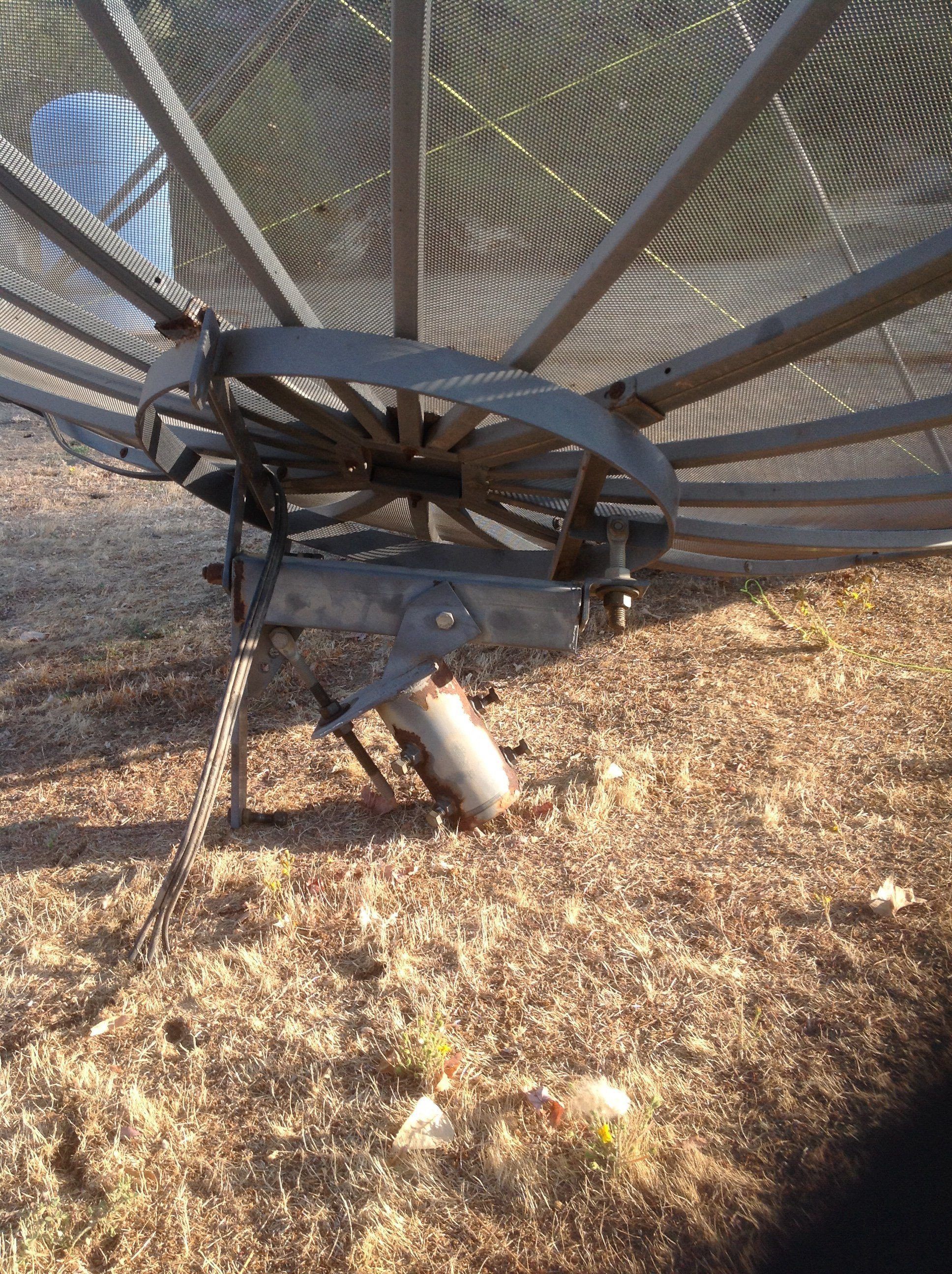

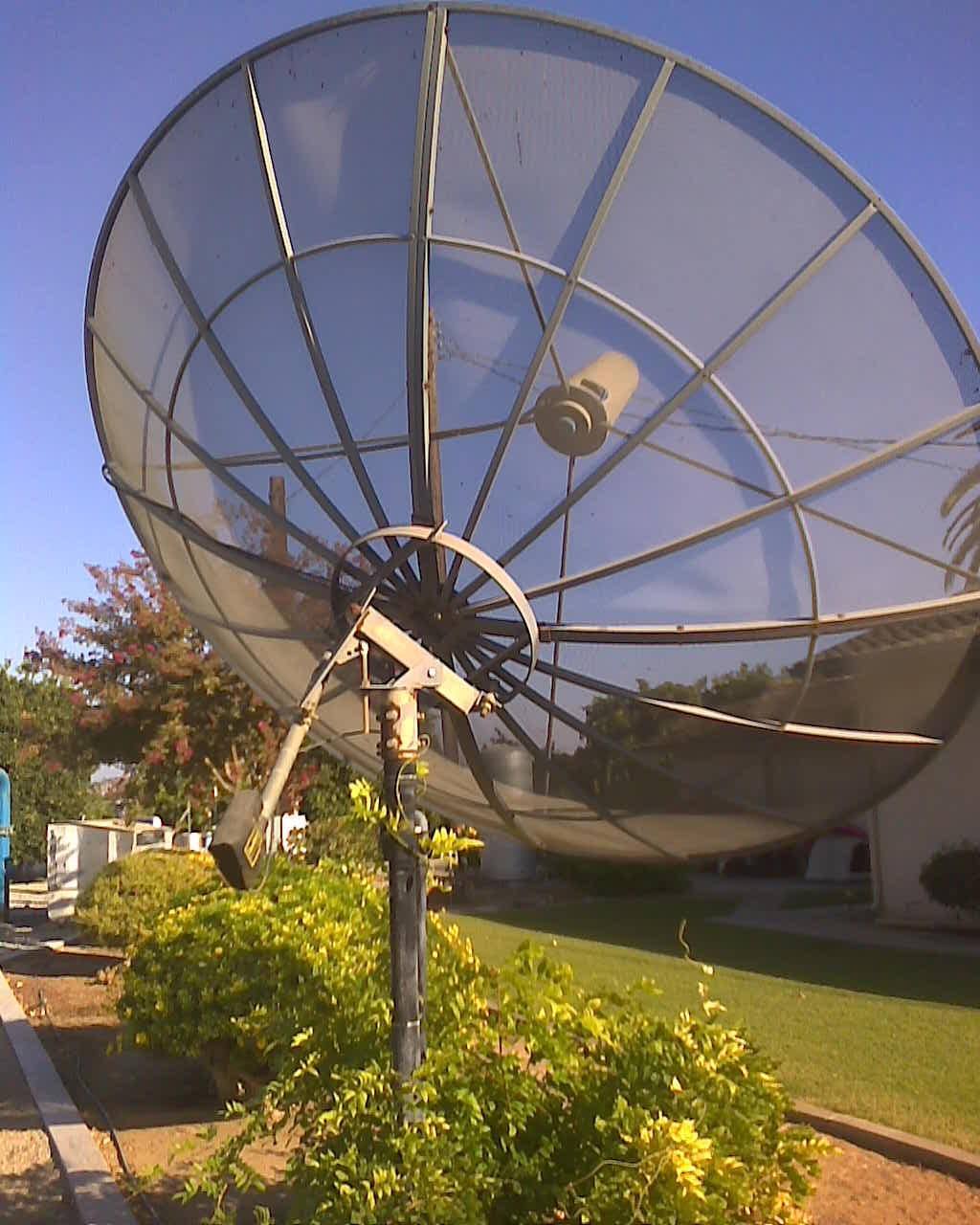

P.S. Give me a pic of the dish polar mount. and the back center of the dish. Maybe I can id it.
Thanks for the statistics. Fun? Fun? Oh yeah, I remember now. Thats when it all comes together again.
the picture of the dish on the pole is before I removed the dish from the Craigs list seller, and the picture on the ground is here on the ground.

Ok, it would be easier with a pic of the top polar bar aimed from the back on the dish, but from what I can see, it's a dead ringer for a "Perfect Ten" dish. "Perfect Ten" polar bars are very narrow and long (compared to everybody elses), and really should have been beefed-up a little better.
If it is a PT dish, Phlatwound end of last year sent me a pristine full size 11x17" assembly manual for those that covers the 7.5, 10ft, and 12ft versions, and I imaged it full-size, and uploaded it here. That manual has everything in it you need, and if that IS a Perfect Ten, you'd be wise to follow the directions exactly the way they lay them out (I tried doing it MY way, and it just wouldn't work right. Follow their exacting directions, and it all falls into place nicely). IF you set everything absolutely according to their directions, you will have a superior working dish, that's well worth the trouble.
Here's the manual: http://www.satelliteguys.us/downloads.php?do=file&id=329

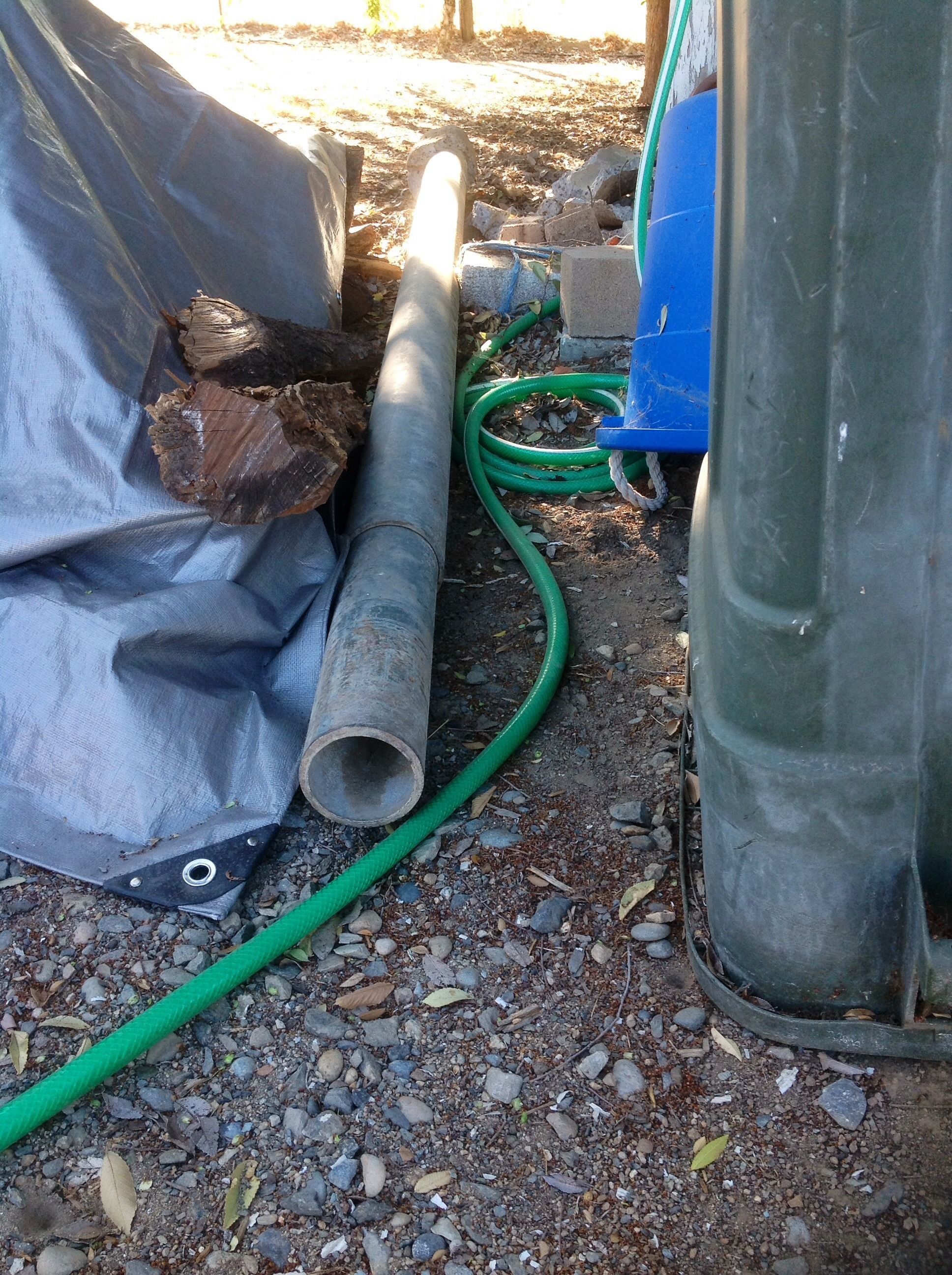

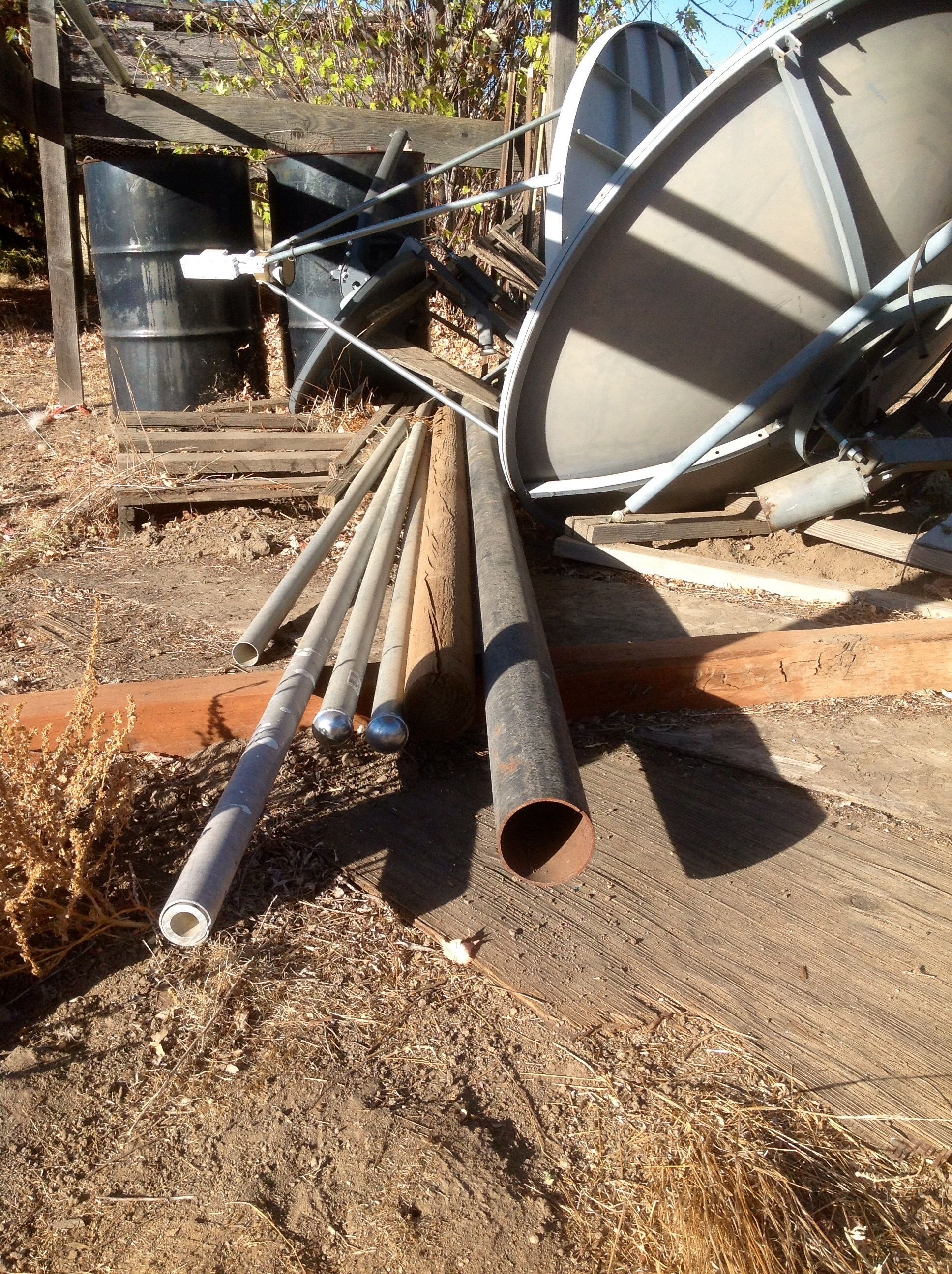

Okay, new question:
I have two pipes that could be used for my ten ft C band dish, a 9ft long 1/4" thick heavy pipe, and a 12ft 1/8" thick,pipe.
which one is recommended for a ten ft dish, or does it matter?

How is your wind load out there? High winds frequently? 4 ft in the ground, and 6 feet above for a 10 ft dish gives you about 1.5 foot clearance between the ground and the absolute lowest you could aim it with a motor.
Can you live with only 1~ foot clearance, and stay away from it with lawnmowers and such? Any critters that can jump that high? I used to have a cat that could jump 6 feet straight UP when she had a mind to do so. Not that a cat could cause much damage. It's things like deer, livestock with itchy skin, and larger you'd have to watch out for.
p.s. Yet of course you don't want it so high off the ground, that you can't reach the feed or lnb's with a stepladder.

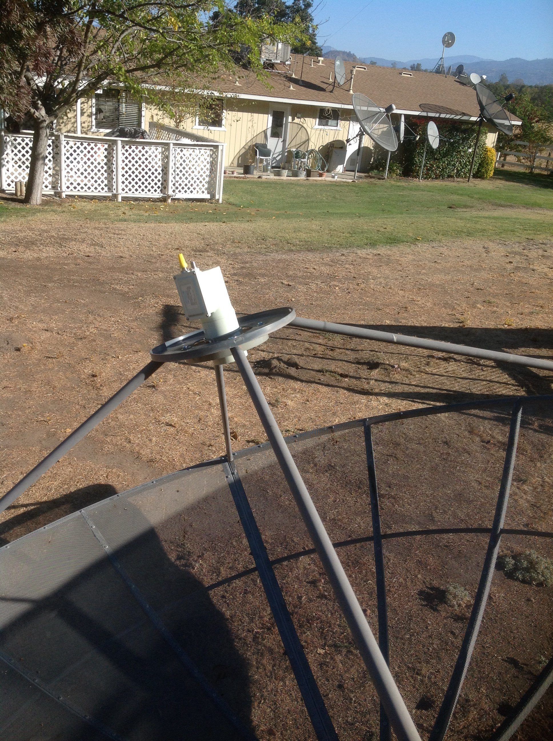

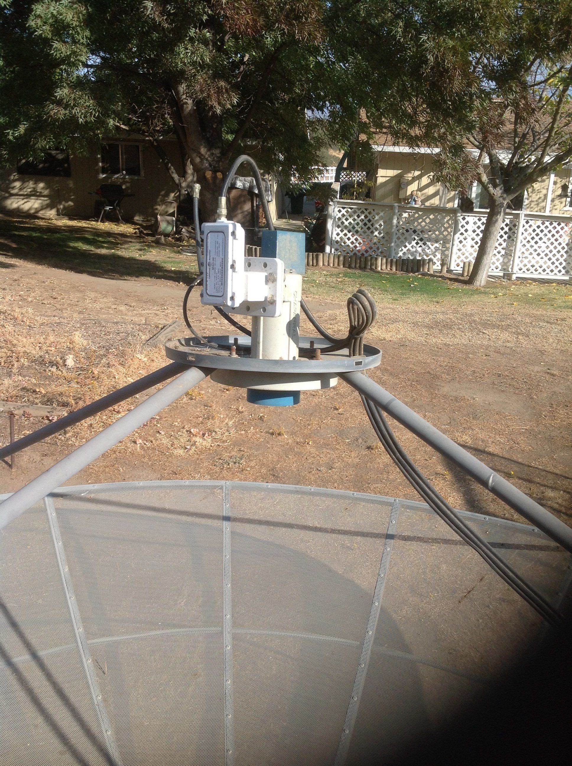

Okay, I removed the old LNB and feed horn and as stated above, previously measured the focal length of the existing before I did so. But it was off by an inch, so I set the new one to the exact measurements in the PerfectTen manual recommended.
its now set at 44 5/8" + 1/8" thickness of face plate on dish + 1/4" insidethe LNBF=45"

Ok, let's clarify that: the measurement from the face of the middle plate, to the outer edge (what the arrow in the drawing is pointing at) of the feedhorn should be exactly 44-5/8".
Is that what you meant? Because if not, it's not set right.
That measurement already accounts for the thickness of the middle plate AND the fact that the actual focal point is slightly inside the feedhorn.
