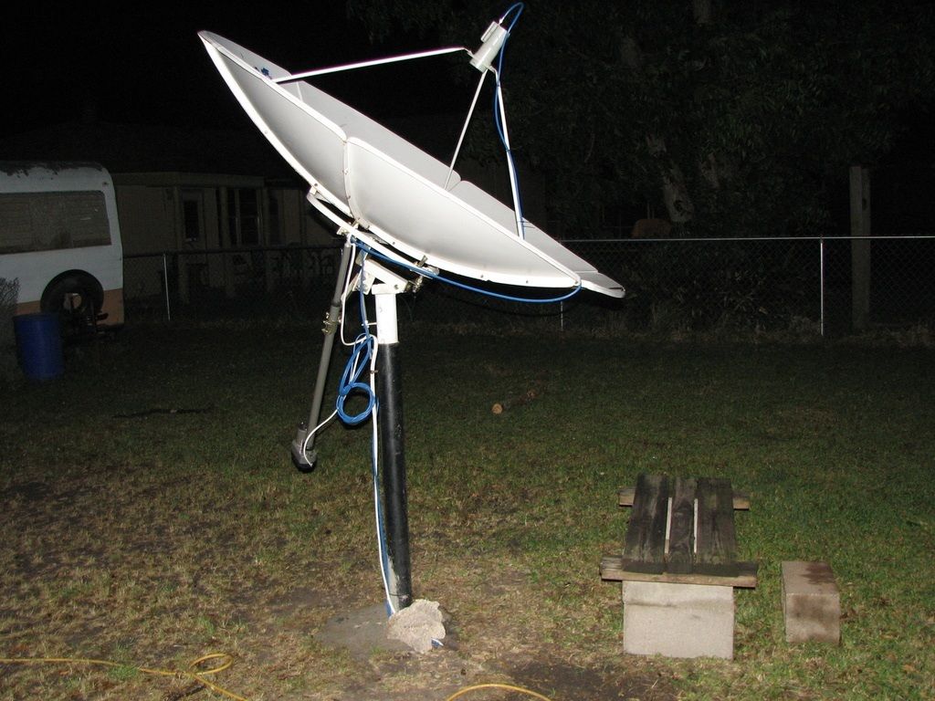

So. I went out back with my camera and snapped a few pictures.
And then after I shut off my camera and was playing with the dog in the sharp North wind, some joker started snapping pictures of me. I saw a flash go off when I was looking down messing with the dog so I didn't catch the point of origin of it but it was blatantly obvious that someone was hiding somewhere taking photos of me. And that creeped me out big times and made me feel very, very unsafe in my own fenced in yard, German Shepherd or not. So I shut it all down and we went inside. There is one guy in particular that lives behind me that gives me the creeps and for good reason but I won't bring that up here. I can't prove it was him but I'm pretty sure it was. He's the sort of creep to do something like that.
ANYWAY........

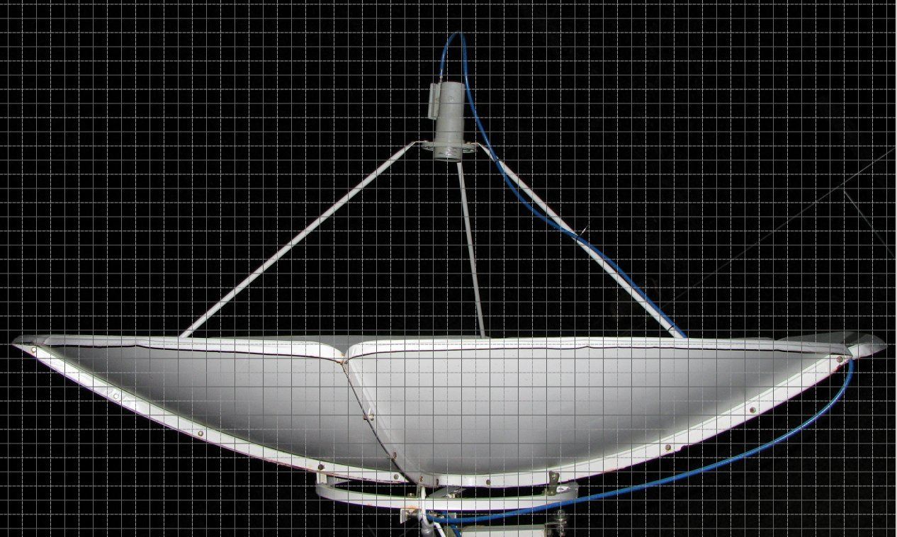

This is the dish and stuff after I put the new scaler ring on it. I ~thought~ it was fairly straight but I can see by using my grid that this one too is wonky like the other though not nearly as bad as before.
So, as is obvious, I still have work to do tomorrow. Perhaps a little tweak and I'll hit the jackpot?
Oh and to answer an earlier question, yes, I did try adjusting the skew and I tried moving the lnb in and out of the ring, I had no choice of course when I totally removed the old ring and put this new and much smaller one in it's place. But I didn't get too far with my experiments and bailed out early. But this is a definite step in the right direction, definite progress. Never leaps and bounds, more like an ant tip-toeing through a mine field. :o
I'll get it. I won't quit until I do.

So changing the scaler ring was the right thing to do. It came with the lnb so I guess the lnb was designed to work only with that one.
I thought it looked CHEAP and flimsy so I figured I would put that big, hulking, heavy ring that I had found on an old lnb, way back from the days of "Made in the USA".. I don't understand the ring stuff exactly, but from what I've read I think it's like a combination of a funnel and a shield. How it can be either is beyond me so all I can do is take you guy's word for it and just work with it none the less.
So after changing it out and seeing from my new photos last night that the lnb is slightly wonky still, I am going to go try to tweak it today and see if I can get the ever elusive thisTV. If I can get both MeTV and thisTV on the same dish, same satellite, I will be as happy as a clam at high tide!

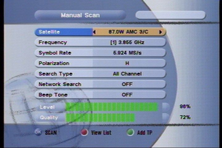

Ok, I got some screenies of the coolsat here.

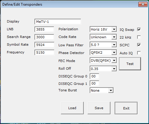

AND, I got the most amazing thing yet, I got my Birdog meter programmed specifically for MeTV!!
It took me ALL DAY and endless tries and hours of googling but I finally figured out how to get the stupid thing to work for C-band! :D
I connected the dish directly to the Birdog in the house and hooked the Birdog to the pc then using the editor app I made liberal use of the "TEST" button..
Also, I read in multiple posts and in the Birdog manual that you exchange the Frequency and the LNB settings when you are setting up for C-band. (Just so people don't trip out over that.)
NOW that I have the Birdog figured out I am going to set it up for several specific channels on several satellites and see if I can FINALLY get my money out of this paper weight. I've never really found it to be of any real use before except to provide power to the squealy meter.
I'm taking a little break for now but in a bit I'm going to take the Birdog out back and see if I can tweak MeTV in a little better. I've still not had any luck at all finding thisTV yet.
But I think this breakthrough I had with the Birdog may be the turning point in this game of cat and mouse.
Oh, and BTW, I have no idea what any of that stuff on the Birdog means. All I know (assume) is that I should try for bigger numbers, right??

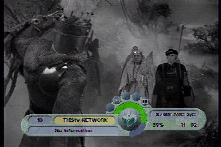

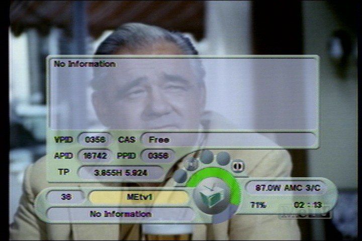

Woo hoo!!!!
GOT IT!!!!!!!! :D
OMG! This was HARD to do!
I was sure that after spending ALL DAY on this thing that I had really fouled it up beyond repair..
I gave up, folded up my little tripod and went in the house to have supper. Just for fun I decided to have the pc scan and bingo! It turned up thisTV AND MeTV....... HUH??? :confused: How did that happen???
So, I AIN'T TOUCHIN NOTHIN!!!!!!!!
Leave it alone!! I'm sure it could be tweaked better but for now, I don't care, I'm leaving it alone and I'm gonna enjoy it for a few days before I go mess with it again.
WHEW!!!!!!!! Man, this stuff is HARD!!
But I finally, finally got it!
:D

According to the coolsat, on both transponders for MeTV and thisTV, I am getting an average Level of 92% and the Quality bounces back and forth between 69% to 70%..
Tomorrow I'll put the Birdog on it now that I figured out how to make it work and report the readings it gives. Perhaps those are more technical than the coolsat readings? The Birdog has some weird symbols on it, maybe some math symbols, I don't know, maybe you guys will know what they mean. I sure wish there was a meter that would tell you which direction to tip the lnb, skew it, move it into or away from the dish, etc..

1 - 3.761 - 29.200 - H - S 94%, Q 6%
2 - 3.830 - 14.000 - V - S 94%, Q 69%
3 - 3.830 - 3.520 - H - S 93%, Q 64%
4 - 3.834 - 2.734 - H - S 92%, Q 63%-64%
5 - 3.855 - 5.924 - H - S 90%, Q 25%-63%
6 - 3.874 - 8.681 - H - S 91%, Q 60%
7 - 3.965 - 3.023 - V - S 92%, Q 79%
8 - 3.974 - 3.024 - V - S 93%, Q 75%
9 - 3.986 - 6.667 - V - S 93%, Q 75%
10 - 4.001 - 28.112 - H - S 95%, Q 69%
11 - 4.062 - 28.000 - H - S 95%, Q 6%
This is what a blind scan turns up.
Now, I did manually enter the transponders for MeTV and thisTV.
If I didn't, it would have trouble finding them. Also it would find a transponder that is so close to the same as the thisTV transponder but comes up with the wrong stuff. When I would try to correct it or add the correct info it would pop up an error message and say "SAME TP EXIST!" and this would prevent it from finding the right thing.
So to prevent it from finding the wrong stuff I put the two transponders in manually and let it blind scan the rest.
Also, the numbers MAY be slightly wrong, on the LCD tv the picture is not all that great and it's hard to tell a six from an eight. The picture coming out of the coolsat leaves much to be desired..
