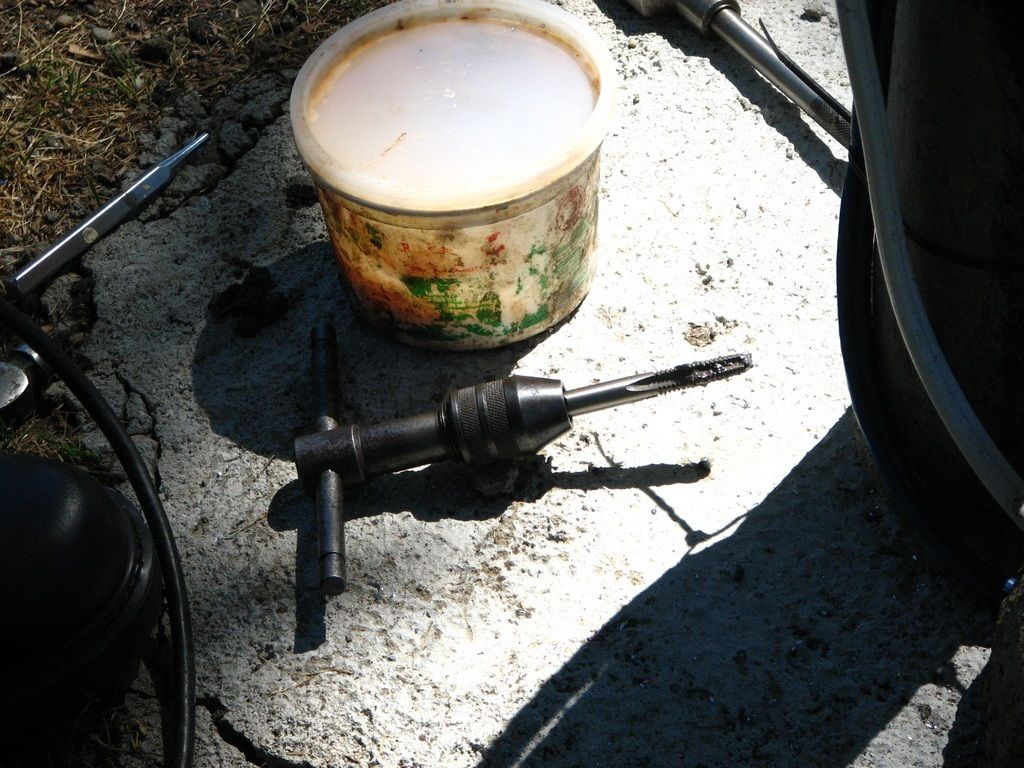

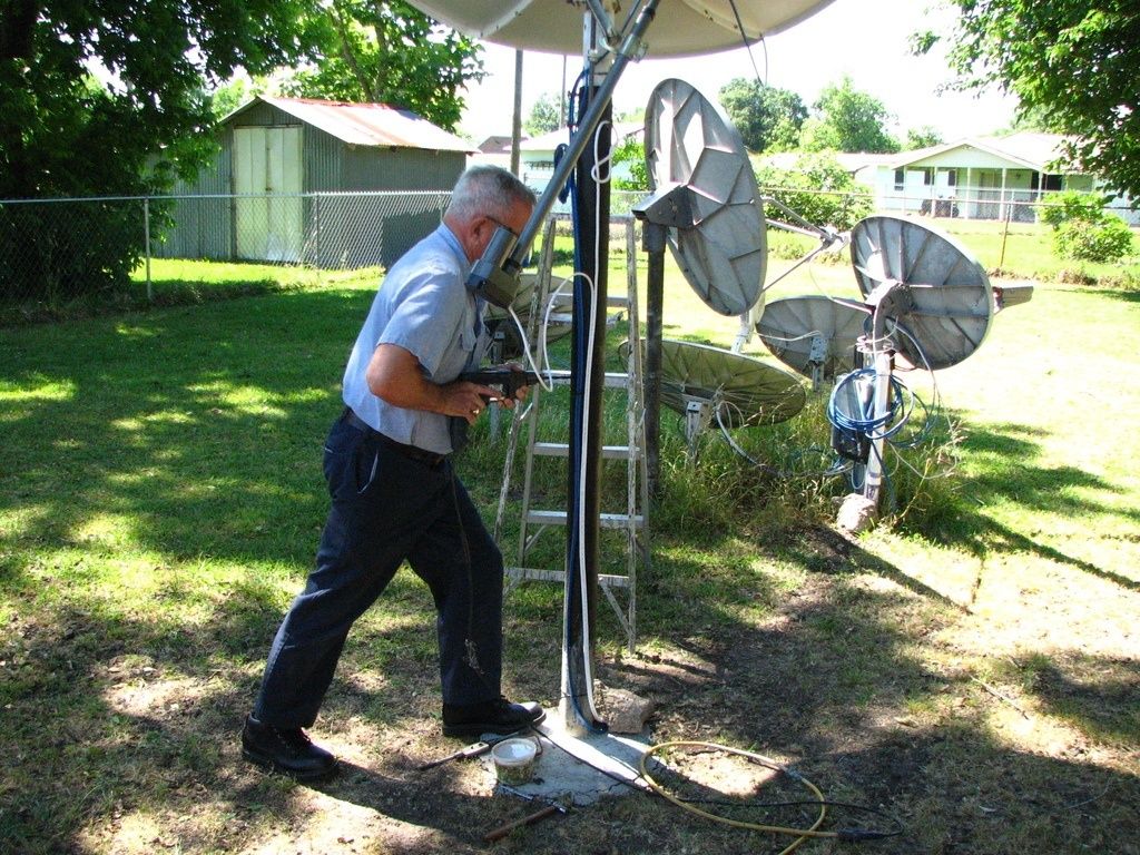

Then my dad came over. He was going to help me (more like DO while I watch) cut down the poles because they are waaaay taller than I had thought/expected/planned for.
He started out by drilling new holes in the 6' dish pole then he used a tool called a tap and put bolt threads in the holes. The bolts make the adapter he made stay locked in place.
He got that much done but before he could get the saw (he has a hand held pipe saw) out of the van, my mom called and he had to go home for something she had going on. Oh well. Not a big deal.
So dad will be back sometime this weekend, hopefully, to cut the poles down and bring the dish(es) down to a height where I can work on them without having to be way up on a ladder like I was.

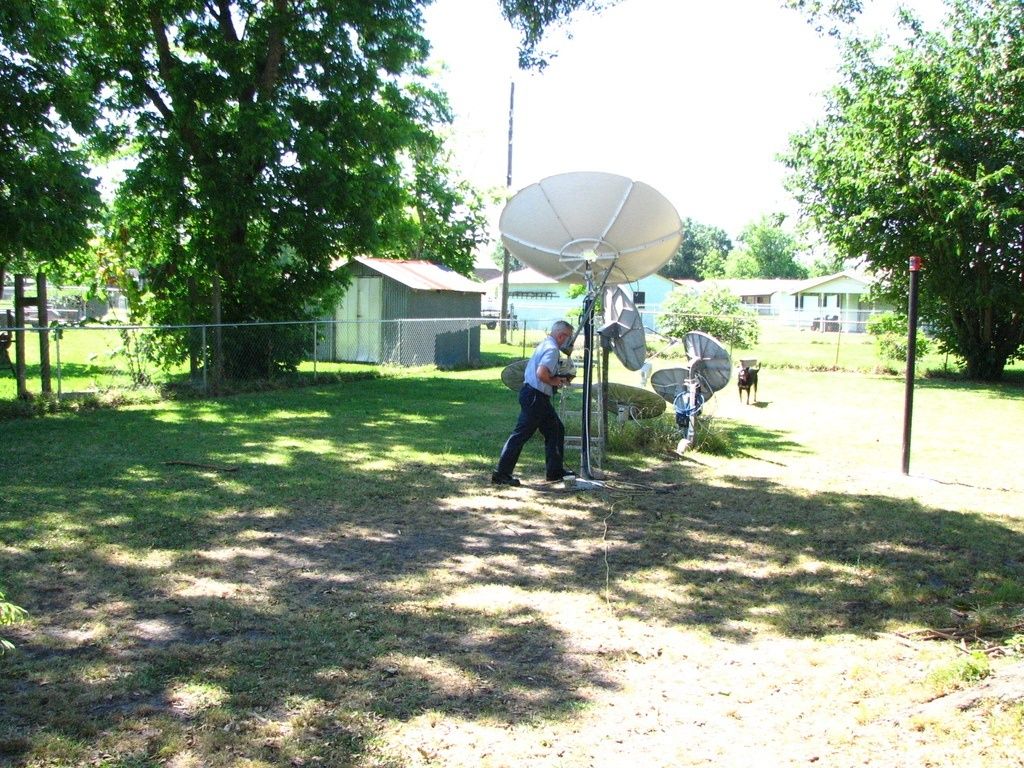

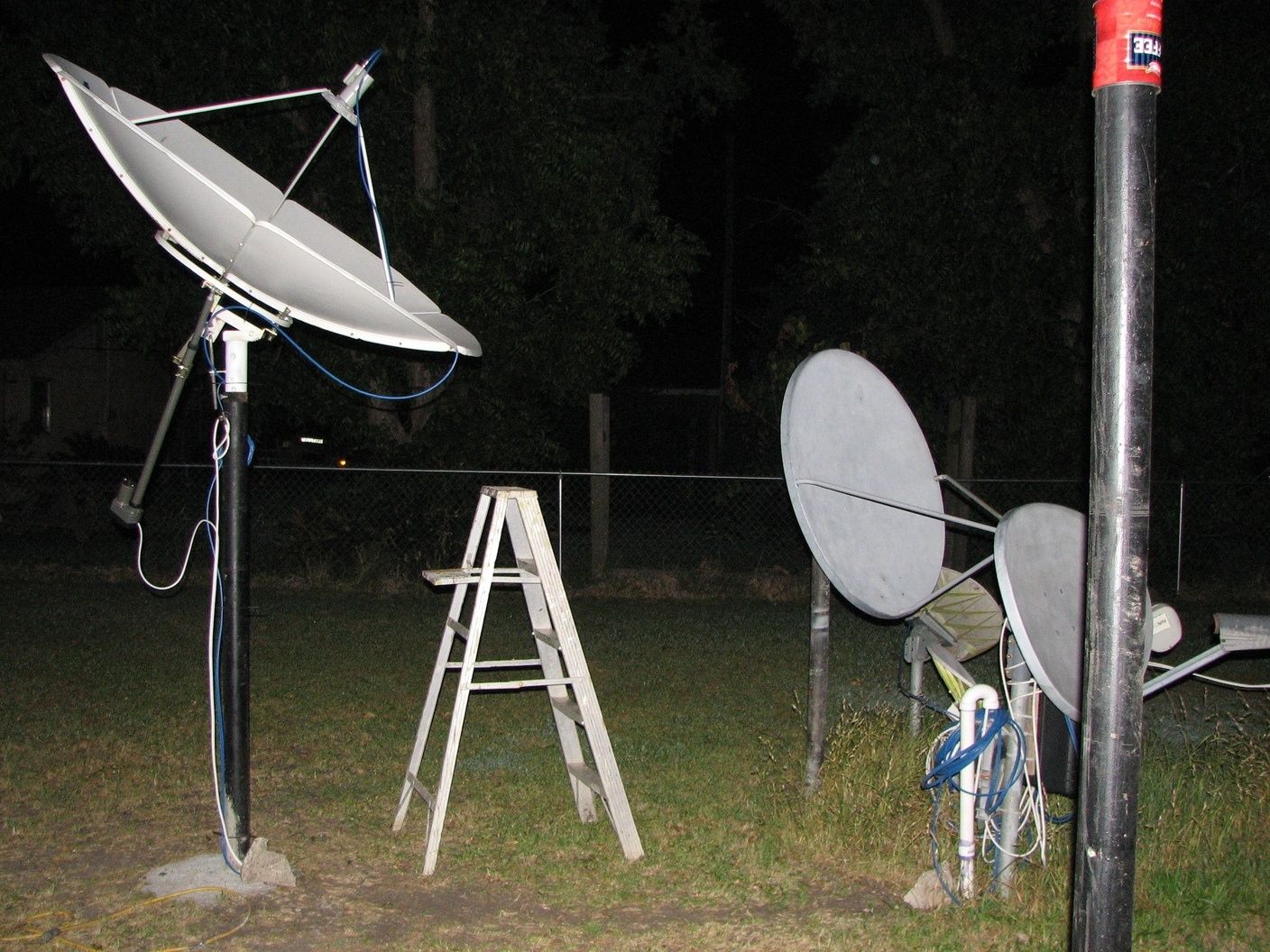

Your Dad is drillin' or tapin' pretty low.
That'll be a real treat to work with. ;)
But, will that big round Primestar Ku dish be in the way?
Hard to tell from the angle the picture was shot.
No no... They are a little over 8 feet apart. I'm pretty sure, well, I'm hoping, that I will be ok on that.
I did however just realize that I won't be able to get my Deere through there. I sit pretty high on that thing, it's a BIG mower.
I guess I'll have to dig the push mower out and get someone to help me make it run. I think it has bad gas in it. I got a weed farm going under those dishes, how shameful! Oh, and NOT weed, ~weeds~ as in the weedeater variety. My push around weedeater may have bad gas too, it's been sitting up for months.

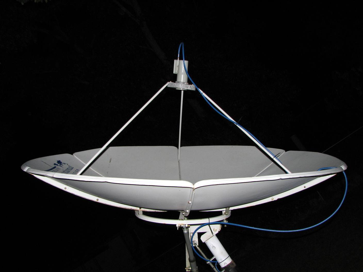

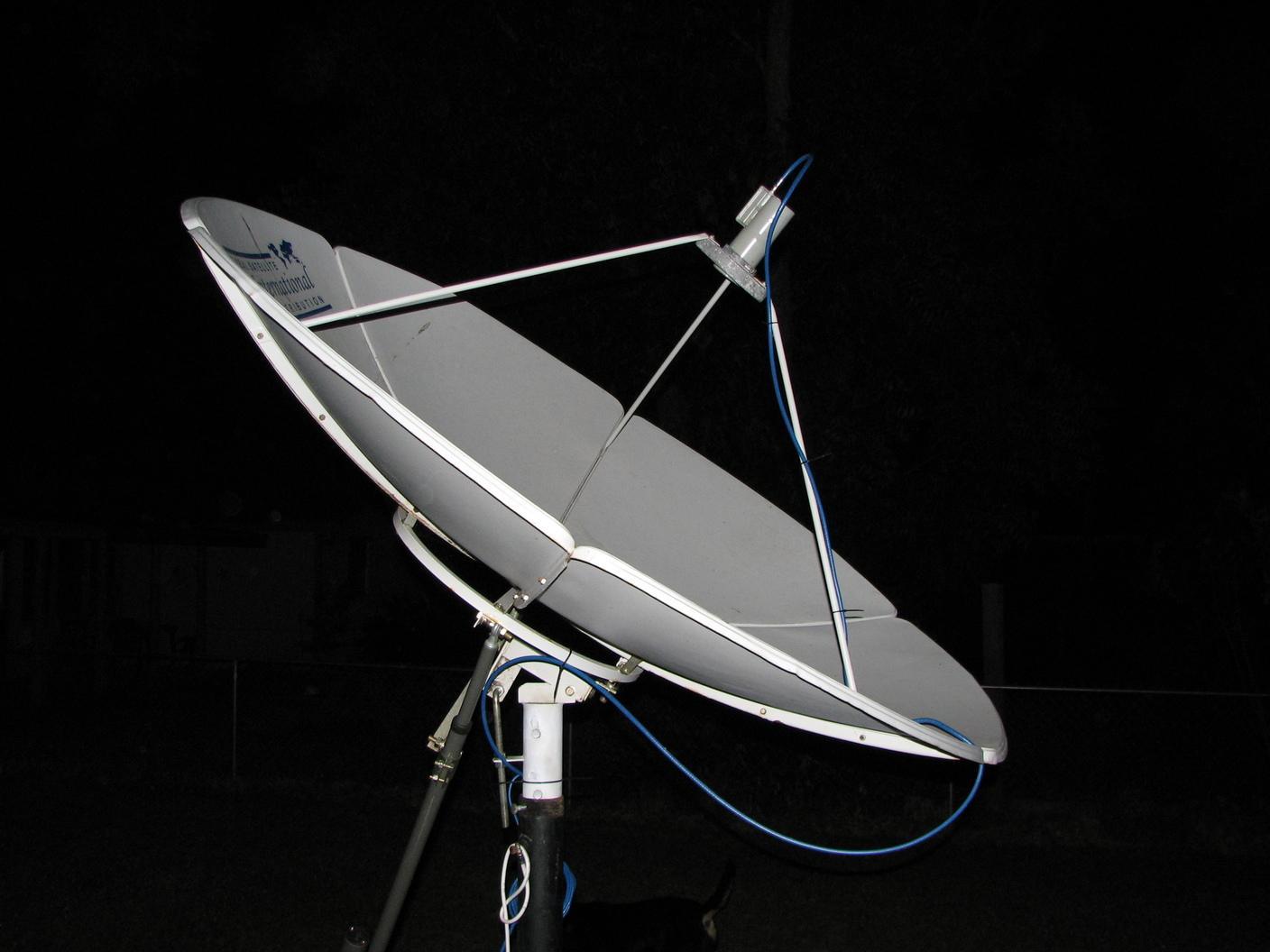

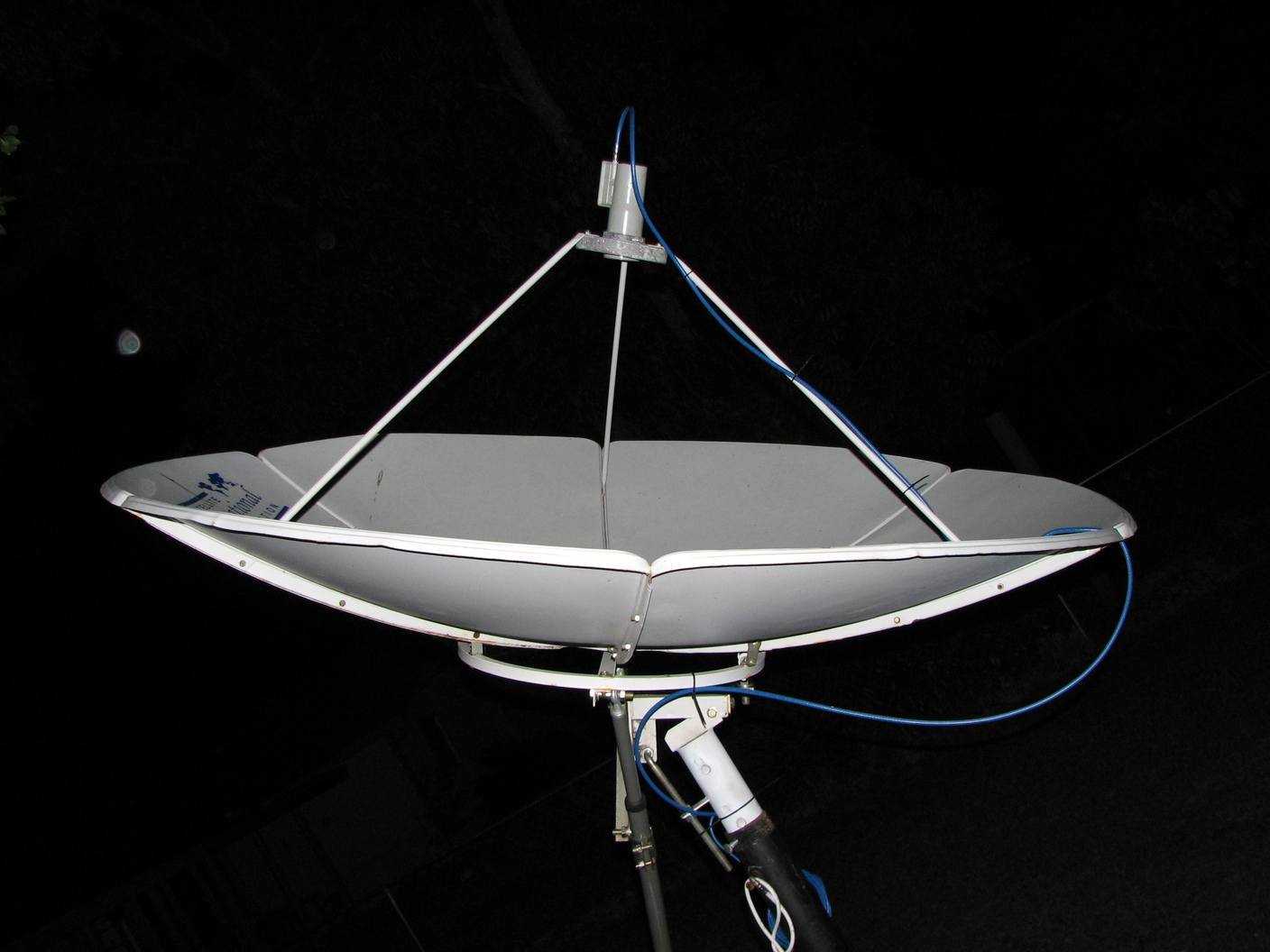

Oh yeah! I was out back with the dog a while ago and I took a look at the dish and WOW! I can see things are waaaaaaaaay out of whack!
The ring for the lnb is all wonky like really, really badly. The lnb though seems to be "square" with the dish in comparison to the ring.
Scarlar ring, right? I need to post a photo of this train wreck. No wonder I have so much trouble with this thing!
I snapped a pic of the dishes from the side to show the clearance. I wasn't really thinking ahead too far when I planned out where to plant these things so I sort of had a little panic attack when y'all mentioned clearing each other... So looking at this now I think I will be ok, with just enough room to walk around it. But not by much. Mowing will be a pain.
Also I moved the ladder over to the side and took some photos of the dish so you can see how the ring is all crooked. I tilted the camera over, there are grid lines on the display of the camera so I lined the dish up with the grid so you can see exactly how crooked it really is.

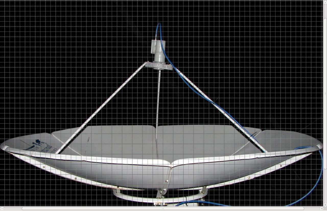

I also loaded it into paint and made a grid over it to show how messed up it really is.

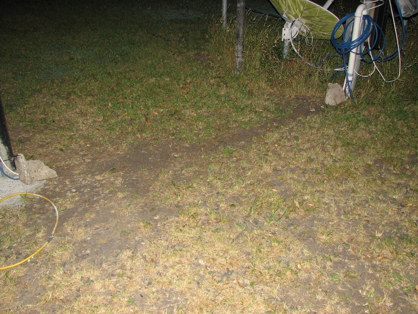

And lastly a snap of the ground where I dug it up and buried the wires from the switch box to the dish. I had to put some chunks of old cement on the wires to hold them in place and protect them from the mower and the weedeater. I need to come up with a better solution to that though for sure.
Looks to me like I have a serious mess going on with the lnb.... :o

Yes it is off. Time for a little tweak via big hands and muscles. Obviously that adjustment is not as critical as some. So if you can get it to look decent it should be pretty good. I had the same issue with my dish. I just grabbed it and twisted it into shape.
Unless that cable is designed to be buried I'd get some PVC pipe to lay the cable in, remember all it's going to take is a small cut ( or dog ) plus water to give you problems down the road.

From a close look at your grid, I'd say it's aligned excellent with the face of the dish.
Yes, the scalar ring is way off parallel to the dish face.
But, the LNBF is not as far off being perpendicular to the dish.
Worst point is, the LNBF is neither located-at, nor aimed-at the center of the dish.
Zoom in on the picture, and you'll see what I mean.
And people wonder why I always request photos...
I know it'll be hard to get the LNBF relocated properly, prior to lowering the dish.
I'd be inclined to suggest you wait 'till ya cut the pole, 'cause everything will be much closer to the ground.
Just be sure you don't cut off too much. ;)
Once the LNBF is centered-on, and aimed-at the middle of your dish, I suspect you'll find you need to adjust the elevation just a wee bit.
But, that could be just what the doctor ordered.
Is there any chance you'll be able to look up through the hole in the center of the dish to see if the LNBF is centered?
I won't suggest rigging up a cheap laser pointer at this point, since it might be more like the tail wagging the dog.
But whatever techniques you develop for this little dish, will go a long way to ease the alignment of your big BUD, later down the line!
