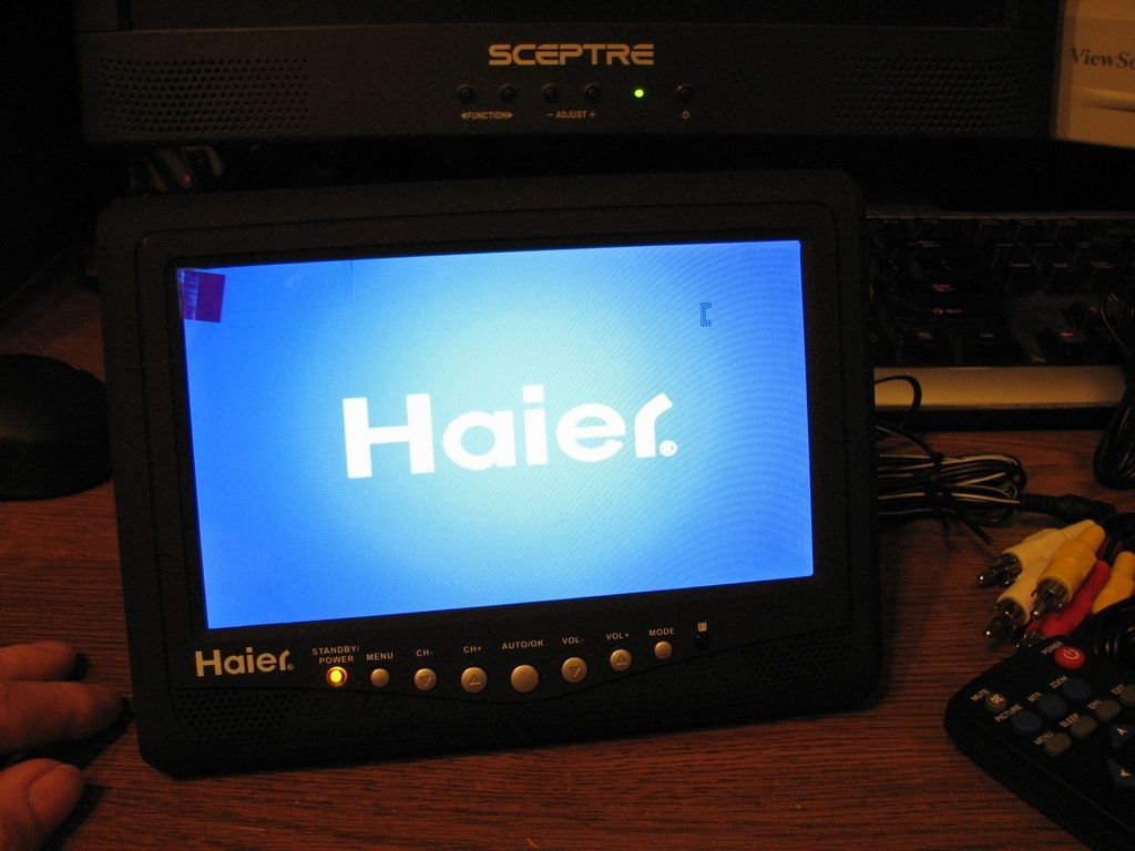

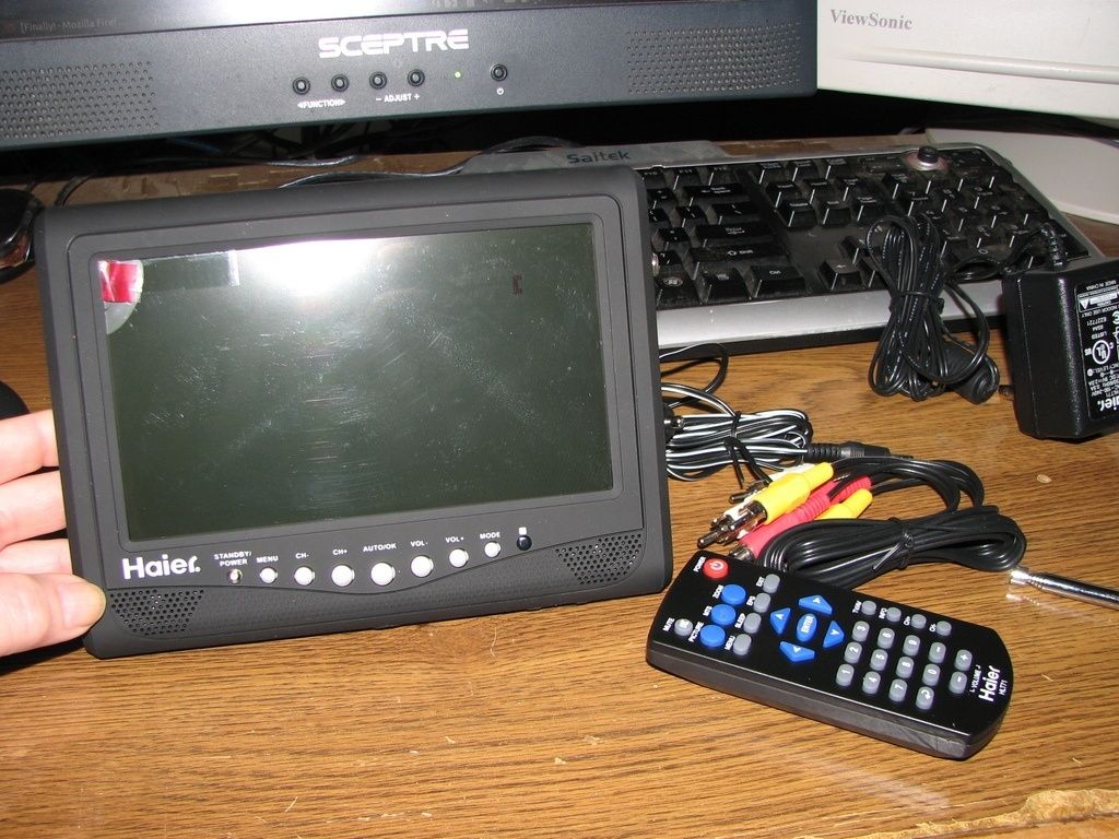

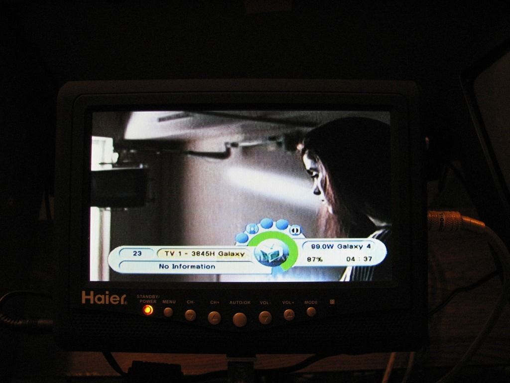

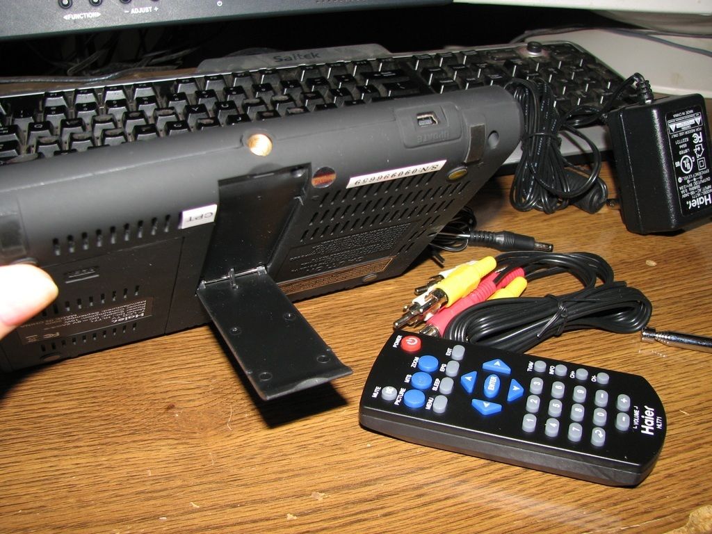

So.. I got that little tv set in. I haven't taken it outside yet but I will soon.
I did hook it to the coolsat and while the picture leaves much to be desired, it is very readable. I will have no problem at all reading the screen (provided I remember to take my glasses out with me!)..
A friend of mine on facebook told me about an app called VNC. I was able to use it on my desktop work computer and my iPhone to see the coolsat when I plugged the video wire into the pc capture card. I had an old capture card in my work pc for converting old video tapes and forgot about it. So that VNC app let me see my desktop from my iPhone but it's awful small and I'm farsighted so that doesn't work so well. I did try it a little and I was able to move the dish around enough to get a much better signal on WVXF than I had been.

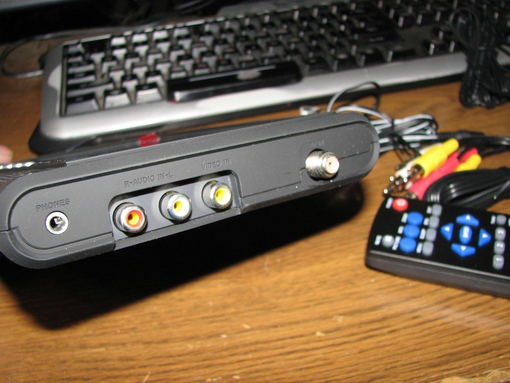

So anyway, this little tv, it has a tripod mount on the bottom, THAT is seriously awesome for me, I have several professional tripods, one of them quite large and sturdy, it cost me about $2,000 in the day..
I have an unused wire that runs from the house to the "dish farm" as you guys are so fond of calling them. So, I can connect that wire to the video out of the coolsat and out at the dishes, connect the other end to the little tv set. I have several of those remote pyramids that let me change channels from anywhere in the house. I can take one of them out in the yard with the tv and operate the coolsat and the Gbox without having to take all that stuff out there. Just two items, the tv and the pyramid remote thing. :D Everything else stays inside...

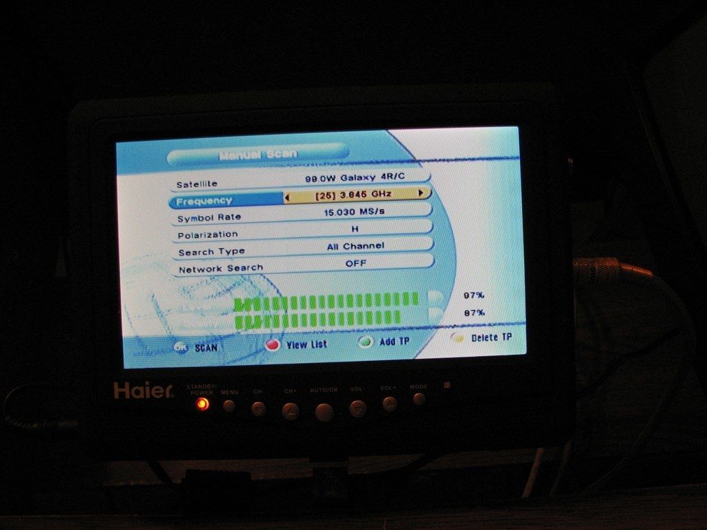

Just before I gave up on it all and took a break, I messed with it one night (yes, I sleep during the day and I'm usually out in the yard standing 8 feet up in the air on a ladder at 3am messing with that stupid dish).
As I mentioned earlier, I was able to get a very strong signal of 97%, up from 63% on WVXF.
I also located several other satellites. The signals on them all vary and are usually chirpy and weak and all blocky.. Terrible. When the signal is weak it makes these horrible chirps and squeaks that pierce my brain like an ice pick! I can't tolerate that noise so if I can't get tv without that, I won't watch it at all. Even 1% of the time doing that is intolerable to me.
Here's the satellites I have been able to locate and can go back and forth to using the Gbox controller.
87, 91, 95, 97, 99, 101, 103, 107.3 and 113.

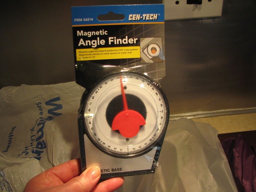

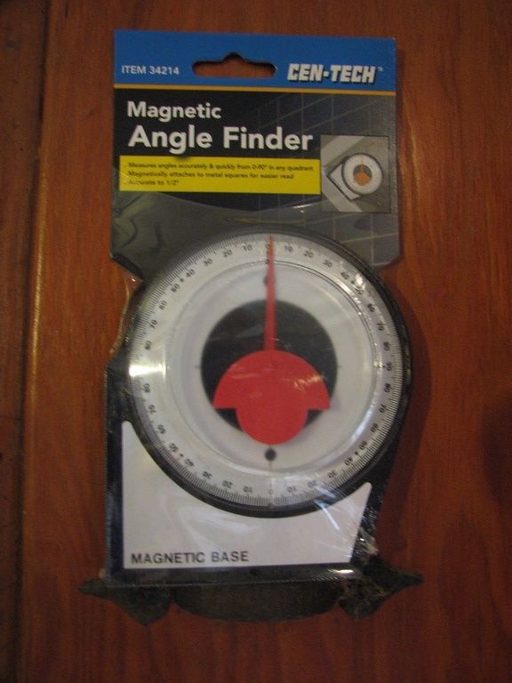

So I have a brand spanking new tilt meter that is all mine.

Good find on that TV - I have the exact same one! I agree PQ is not great but it will more than suffice what younkers and will make you're doing a damn site easier.
So you've amassed a fine collection of tools eh?! I love reading this thread, not just to see how're you getting on, but to read how're you're doing it all.
Keep up the good work!
WOW I did not read that last reply before posting!
The tv...is a great little TV ideal for what you're doing and will make it easier for you to tweak.
Your setup with the spare cable to the farm that will let you hook the tv up outside and IR pyramids is pretty cool, I still use another person shouting out PQ numbers!

I've got one of those little TV's too...they work great for aiming the dish and are alot easier to take on the roof than a 13" TV :)
cept for s2 signals, my coolsat beeping function connected to an fm transmitter and my walkman has aided me a lot.
