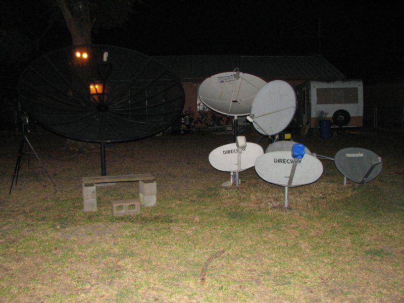

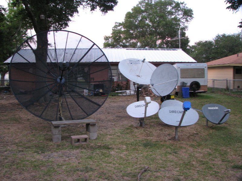

because ~~ I ~~ got that BIG dish assembled, put up and ~~ working ~~ today....
I told you guys I would do it. I said I would make it work even if it hairlipped the devil.
So I'm sitting here watching MeTV and it's coming in really, really, really strong and clear.
It was NOT easy. I spent the past few weeks cleaning all the metal parts with acid (something called ospho) and wire brushes on a drill then painting everything several coats.
I cut the pole down. I watched Dad do the first one back some weeks ago so I figured I could do that. And I did. I borrowed his saw and I cut it down all by myself and didn't even get hurt doing it. I just took my time and when it got close I took the saw away and pushed the top part off and let it fall.
Dad welded the ring properly and brought it back. I bolted it onto the dish, that was pretty hard to get that ring in place by myself. My back is telling me right now that I went a little over my limits.
I dragged the dish out to the pole and bolted the big heavy bottom part to the dish ring. Then I mounted the motor to it so that it can't tip side to side.
At this point I was stuck because it's waaaaay too heavy for me to lift up onto the pole. Yeah, I did try. No, I could not.
So I called my dad and he said he had a meeting to go to this evening and could stop over on his way.
Mom and Dad popped in a few hours later, my dad and I were able to lift the dish onto the top of the pole. With two of us, it wasn't a big deal at all. Mainly my dad lifted and I steadied it while he tipped it just so until it fell down onto the pole. It took less than 2 minutes. Done deal.
Mom and dad left and I went in to cool off awhile.

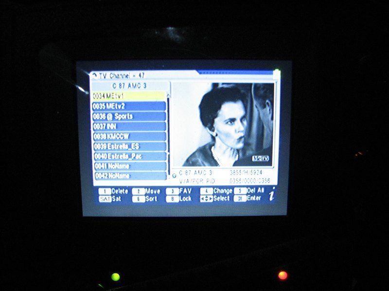

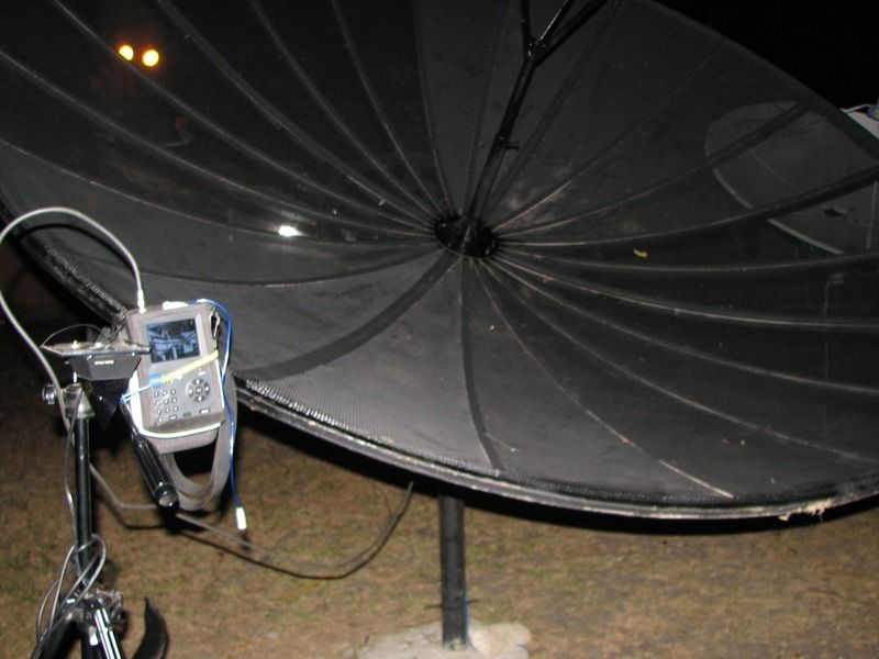

A few hours later I took my little meter and went outside. I took a wild guess and turned the lnb to about the position it had been in on the other dish when I had been able to find MeTV and tightened it down. It was a wild guess, I was hoping to get anything, I didn't care what, I just wanted it to give me an indication that I was in the general area.
I took the tip-o-meter thing and set the angle to 30 degrees exactly. The other setting, you can't change easily. There are three bolt holes and I could see it used to be on the middle hole so I set it on that. It's one of the x-clanation settings. I still don't get that stuff. But whatever.
So turn the dish in the general direction of 87 AMC 3, hook the meter up and wait while it booted. I expected "NO SIGNAL". Um, NOPE...... FIRST THING that pops onto the screen is NASA. Something to do with the space station. WOA.. Really??
So I turn the dish a little on the pole east and west for the best signal and tighten those bolts.
I'm thinking that's gonna be it, just like the little dish where I could get NASA and nothing else.
I almost didn't do it but at the last second I decided to check and see what else I could get. I hit blind scan and bingo, MeTV and thisTV show up in the found channels along with a lot of other stuff. Woa........
Not bad for first shot, wild guess with no tweaking.....
ThisTV shows a weak signal though and doesn't come in, yet. I'll get it later.
I'm sure that when I go out and put some real effort into it and carefully tweak it, I can get all the good stuff on AMC 3.

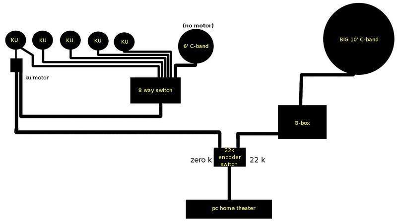

I have a little switch I bought last year for 22k, I think it's an encoder. I have no idea how to make it work. Yet.
My goal is to have the encoda switch between the big dish and the ku dishes.
I don't know how to explain it so I'll try to illustrate it.
I understand that I can't put the motor after the switch, that it has to be before the switch or it will burn the switch out. So I'll run the wire to the motor, from the motor to switch and then a wire from the lnb to the switch. And the big dish won't be on a discque switch. The encoder switch will switch over to the Gbox and the Gbox will be able to move the big dish.
Now I have no idea how to set all that up. I can connect all the wires up, that's easy. But I don't know how to make the pc understand what I want it to do. Yet.
I'll figure it out, one of these days. I'll keep reading and scratching my head and trying and trying until I get it.

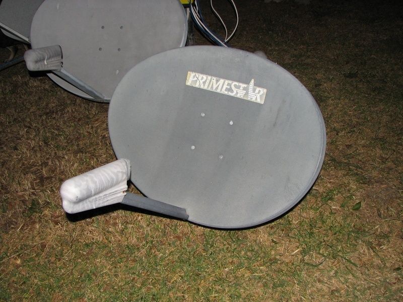

I knew that little 6' dish was too beat up to ever work right. I had waaaay too much trouble with it, what with me being a beginner and all and it being damaged from my clumsy assembly and handling methods. I knew there was no point in continuing to frustrate and aggravate myself over that thing so I just quit on it and put my efforts into the big dish.
And on the very first try with no tweaking at all, I got my channels... THAT, is good. If I had that much success straight off with it then with some effort I should be able to do far better and get ALL the goodies. I'll work on tweaking it over the next few days.
And I'll keep at it on the other stuff, the motor controllers, until I figure them out too.
I can't help it, I'm too hard headed not to.
So there... :p I did it. :p I said I would and I did.... :p Meh.............:p:p:p:p:p:p:p

sweet! Very nice job! You have advanced quickly with this hobby. You learned much faster than i did. congrats-the big dish looks awesome.

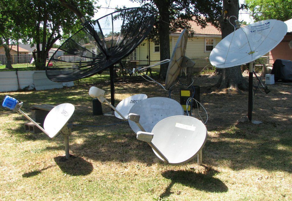

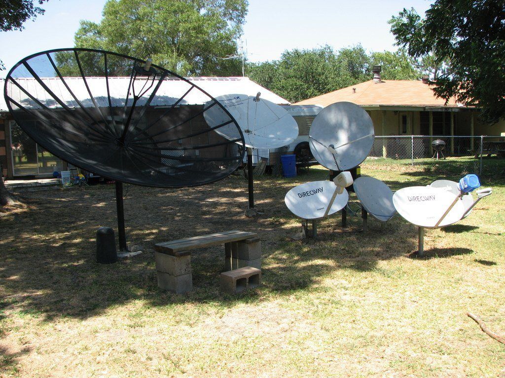

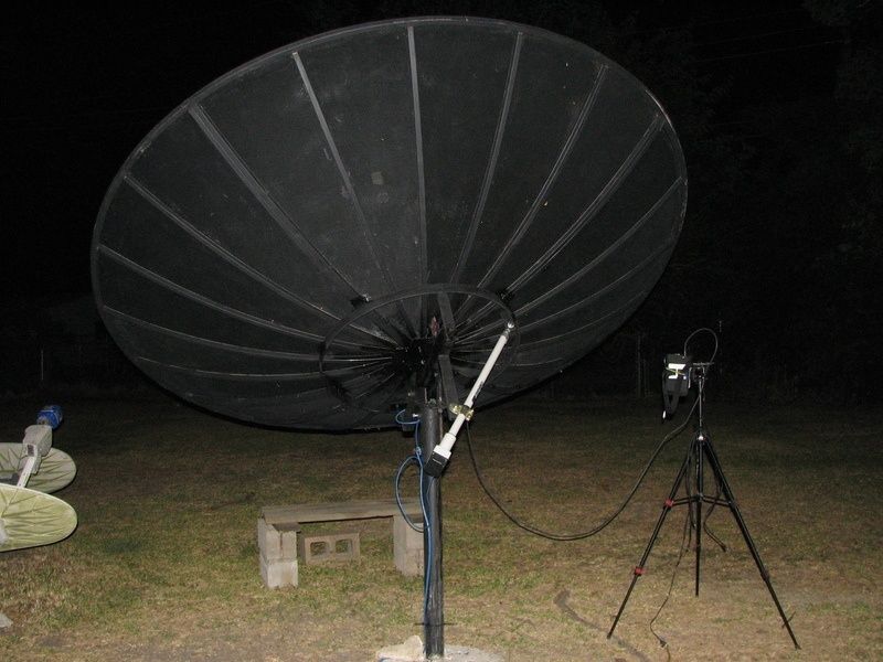

So, I went out today with my nifty new meter and tweaked the big dish a little. Reaching the lnb is very difficult on this big beast, platform or not, it's a looooong reach over to the darn thing. Since last night when I got massively lucky and found MeTV on the very first try, I went out today and used a paint pen to mark the lnb right where it was.
Then I loosened it up, set the meter for the transponder that has thisTV and turned it a bit. About three tries and I hit thisTV.
I tweaked it to get the best I could then checked to see if the other channels were working. Indeed they were!
I confirmed with 100% certainty that I was getting MeTV, thisTV and NASA. I was. I tightened the lnb back down, reconnected the cables and went inside.
I put the encoder switch on and tried it out. I was getting all the ku satellites without problem but not the big dish. I checked the pc settings and after some googling I figured out that there was an extra zero in the 22kz command. I deleted the extra zero and hit scan. BINGO! All the channels scanned in like a charm!
So now I have the big C-band dish pulling in almost all the channels I want, it's on the 22kz switch so that I will be able to add the Gbox on it later and the ku satellites are on the zero side of the encoder switch and they all work fine too.
At the moment I have none of the motors wired up to work but I do not care right now. I'll get to them later. For now, I'm going to take a few days to relax and enjoy all my lovely, lovely, wonderful new channels!
I'm pleased as punch that I got the flippin thing working.
For now I'm not worried about the little Cband dish, I'll aim it at the satellite with the Leasea (whatever that is) church channels so I can get Green Acres and stuff. Eventually.
It's hard to get good pictures right now because of the partial shade causing extremes of contrast. I'll try to take a better picture later when the sun drops a bit.
OH, and speaking of the sun, I did not have ANY fading out issues when the sun came up this morning like before. MeTV stayed strong and solid all day long. Nary a single fade, drop out or glitch. I couldn't ask for better.
Oh, and I painted the big dish with latex outdoor paint. I had them mix a dark charcoal grey, it looks pretty nice in real life, you can't really tell by the pictures. I need to get a brush and touch up some holidays but I can do that anytime.
I'm set... I got my channels! :p

Size makes all the difference with C-band. 8ft minimum is my rule. You're set now, with a 10 up. Good job Dee-Ann! :D:up Now relax and watch some TV! :popcorn
Ah yes, so it would seem, bigger is better.... I'm chillin now to some Hawaii 5.0 which I haven't been able to do for quite some time.

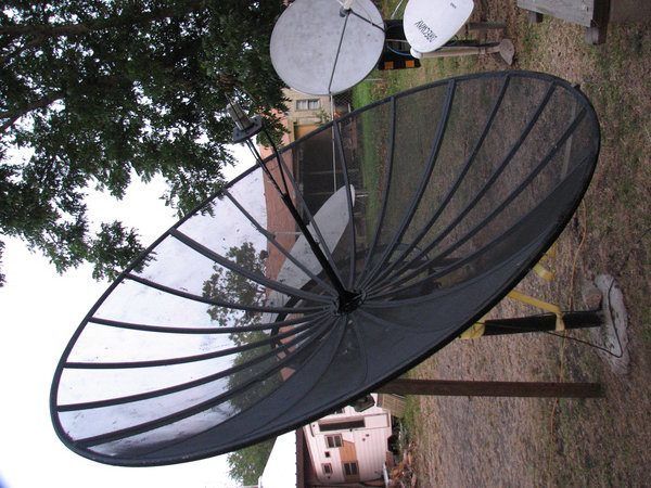

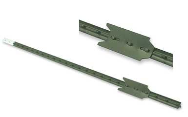

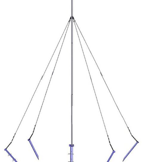

Chewie, the poles were cut down to 4 feet tall, each one. However the 6 foot dish has a weird custom adapter my dad made so that it could be bolted to standard size US water pipe (I think that's what it is) so that one is a little extra taller, with the 4' pipe and the adapter he made, it comes out to be just under 5' tall.
In retrospect, I can see that it would be no problem at all if they were both cut down to three feet tall, it would actually make working on them sooooooo much easier and I think it would make them safer in high winds. Hurricane season just started here so I'm really worried about that as we've been hit quite a few times in the past decade or so...

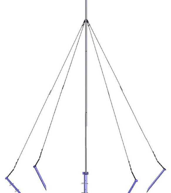

One of the guys suggested buying some fence T posts, driving them in at angles and tying wires to the poles and fence posts like you see on giant TV towers out in fields. I very much like that suggestion and need to get that done asap. The only problem is that we are having an extreme drought and the ground has turned to concrete! My yard has died and is turning into a desert dirt field. I don't think it's possible to hammer anything into the ground right now. I'll have to wait until we get a good soaking rain. That may be a long way off from what they are telling us. It's not looking good at all for rain. Heck, the gas in my John Deere is going to go bad from just sitting!

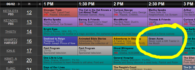

Like Dee I too like watching "Green Acres" and looked for it on Leasea's website before I would take the time to adjust a dish back to Galaxy 16, but didn't see it listed on their schedule anymore.
Can someone please confirm if "Green Acres" is indeed still on Leasea's channel, so that Dee and I can get our "Green Acres" fix? :)

Some weeks ago when I was fighting with the 6' dish I checked the Leasea (sp?) channels on that satellite and I indeed did watch one episode of Green Acres before going back to the muddled up mess on 87 and then losing everything.
I went to their website, Lyngsat, The List and Titan and was able to get the right info to add them into Titan and get proper, correct listing for their programs. :)
My only problem is that it comes on during People's Court. Sigh....

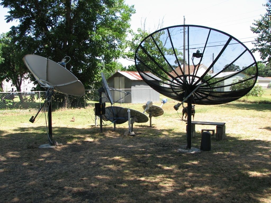

Dee,
I can see why that 6ft gives you trouble. In this photo it appears that the lower right pannel is deformed (at about 5 oclock)
This dish being undersize for C-band would have to be in perfect condition for reasonable performance.
Dee,

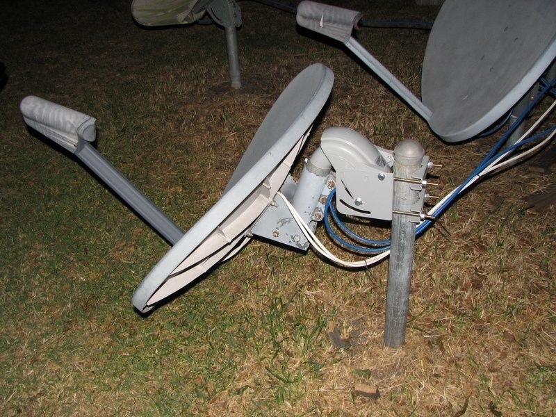

Yes, actually most of the leaves are bent, some more than others. It's in pretty bad shape.
When I assembled it it had been raining a lot and we had severe mosquitoes going on so like an idiot, I attempted to assemble it in my kitchen.
Things went downhill from there. I bent it several times during assembly then more as I tried to get it out the door to the back yard and more over the months and months it languished in the back yard collecting leaves and rain water, rusting away as it spent it's first months as a bird bath and frog pond laying on the ground. It got moved numerous times and each time, got bent. I tried to fix the bends but apparently I failed at it. And when it finally came time to pop it onto the pole, it got bent even more.
I would suspect that if it had been properly assembled by a non-idiot and put up by a non-idiot, it may have worked just fine. Many of you guys have said that you have the same dish and that it works just fine for you. I do not doubt that at all. Iceman showed screen shots of several channels that he gets with the same dish and it works fine for him.
