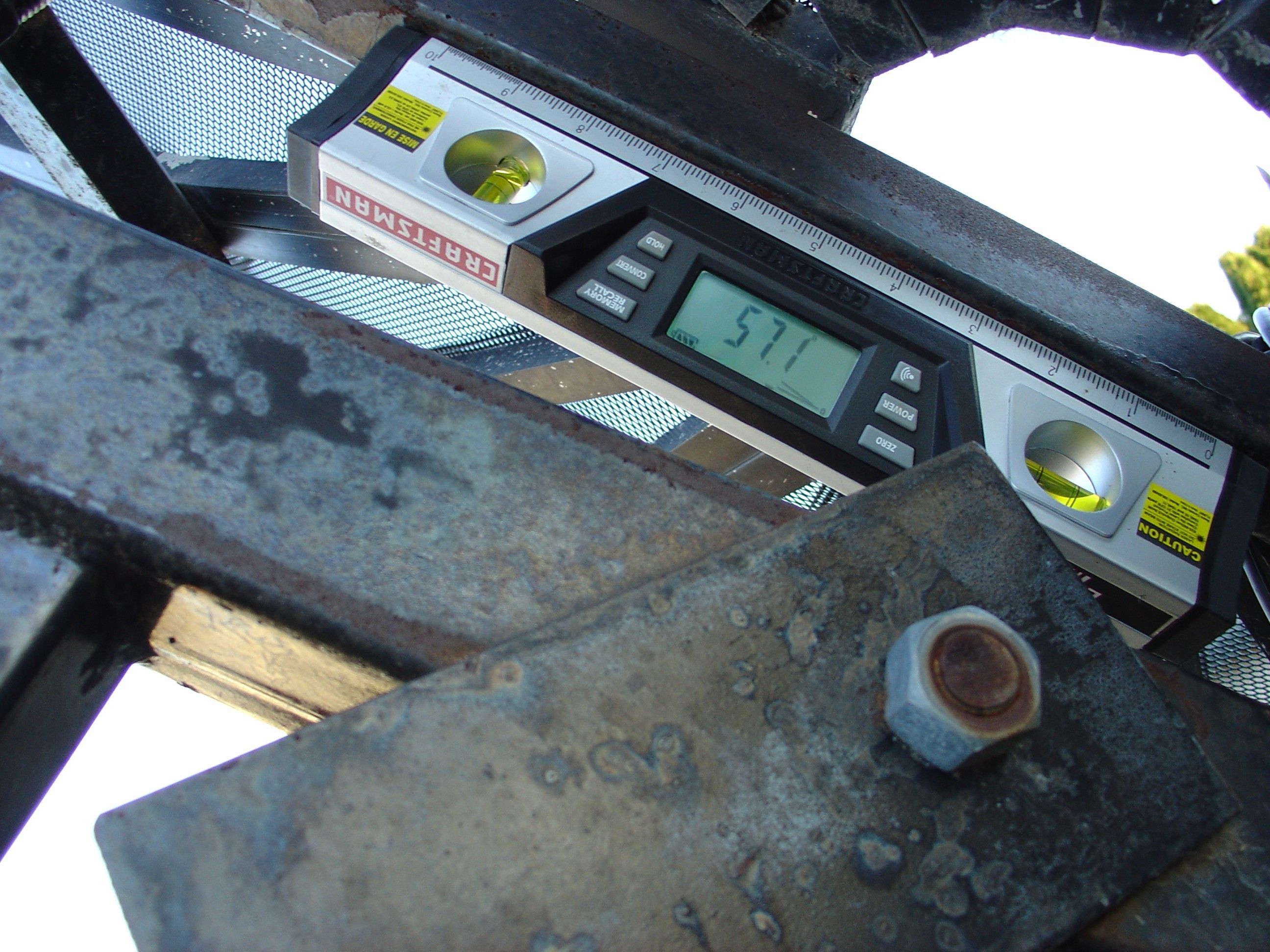

1) Readjusted Declination using the Sears Digital Level, when all was done Final Result was 57.6 to 57.1, see picture. Remembering that the Ideal or Objective for my Location is: 57.18 - 50.57 = 6.61 degrees Declination re Linuxman's Chart: http://www.satsig.net/ssazelm.htm in my previous Post here.

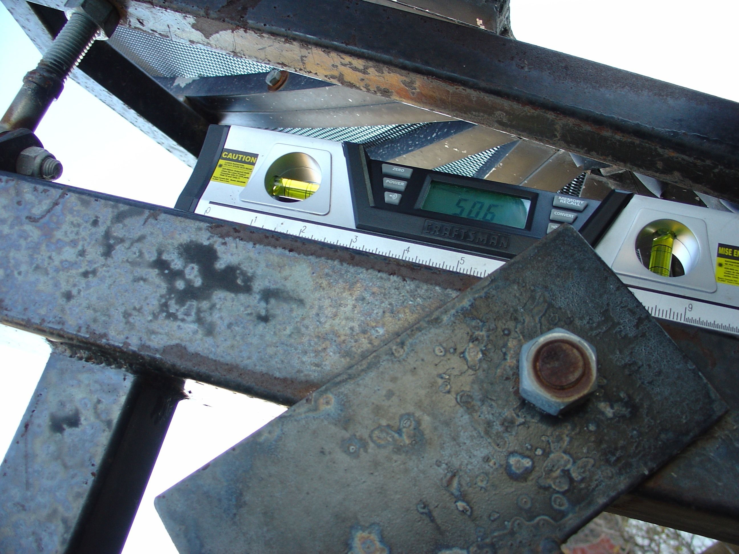

2) Readjusted Inclination on Big Bar (Polar Mount) for Best Signal Quality when finished left it at 50.6, - see picture. Adjustments were made to the Declination Bar and Polar Mount via Pictures 3 & 4 in the first post here.

Worst Tp is 11706 S = 66 Q = 56. So there has been a great improvement on some Tp's such as 12090 - as much as 26 Points. One thing I can say is that $50.00 Sears Digital Level is worth it's weight in gold, without it I would NOT have had this improvement!! It would be even better if it went to 2 decimal places instead of only one. The Declination Bar's Nuts were extremely hard to Loosen had to use 2 hands on the 1&1/8 wrench while on the 6 ft Ladder.
Now need to adjust for Both Sides East & West to see if I'm in the proper Satellite Arc. Thanks all for the help. And yes fine tuning a 12 Footer is definately worth it!!
