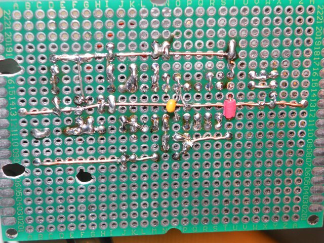

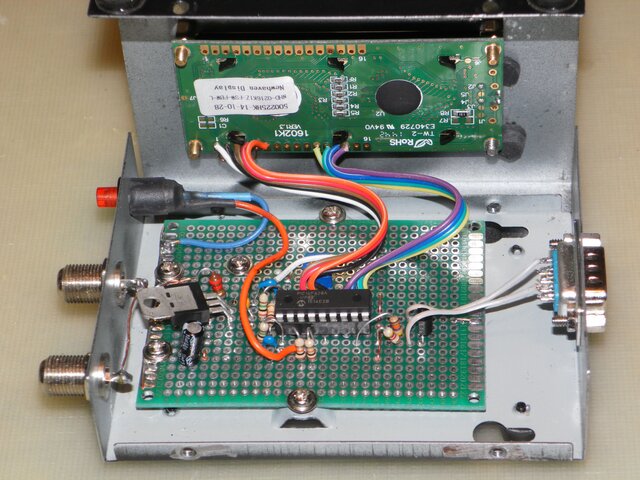

A more detailed look inside :
View attachment 111632 View attachment 111633

I had two of the signal combiner boxes and when I put a blue display in the ASC1 it gave me an extra 4x20 display. I checked through my parts and found everything to build another except the PIC16F628A. I had a 20 pin DIP socket instead of an 18 pin. Many moons ago when we had a RadioShack and they still sold electrical components I bought a resistor assortment. I'll never use them all up I thought. But I have actually ordered some of the ones I've run out of. I strip old electrical devices of components and terminals and have built up quite an assortment of stuff that comes in handy. The box of old satellite stuff that was given to me yielded the two cases, they each had F terminals, also from the box of stuff the two serial connectors. The DIP socket I had from long ago projects. The voltage regulators and caps are salvage items and left overs. The tiny momentary closed switches are not as easy to find as you might think. Auto parts stores have lots of switches but they are all huge. The switches I used are from my scrap pile in my toolbox. They are Valet buttons from old Subaru security systems. The programing button from those systems would be even better but they unfortunately are often broken and why I had none. So if looking for some small switches, check shops that install those security systems. The fixed inductive choke (2.2UH) I reasoned being part of a portal and power supply for these FTA projects and would be needed in many applications. I bought a bunch of them :) but only have 4 left :eek
So I built unit B, same size box but it's bigger on the outside and smaller on the inside ;)
