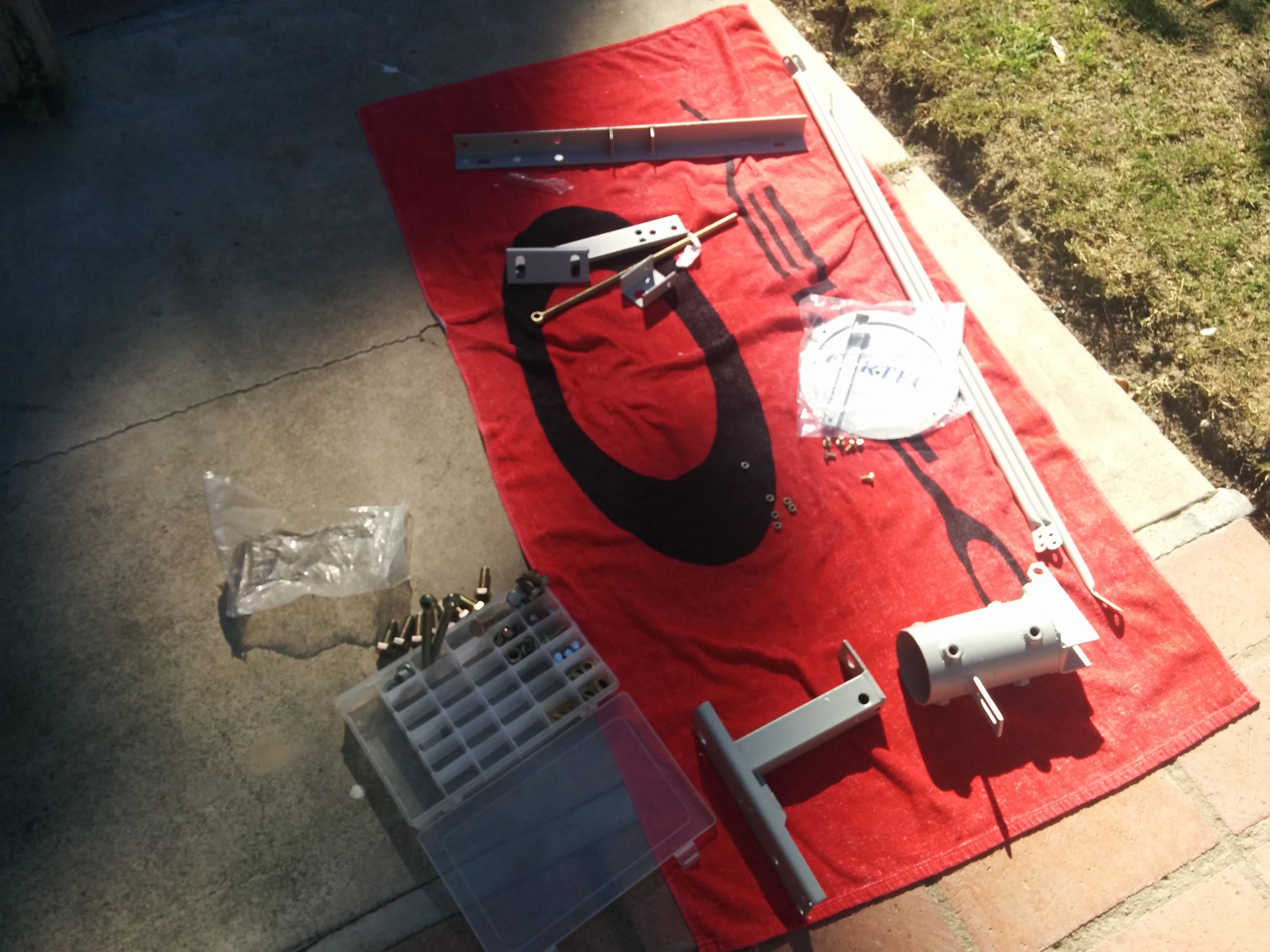

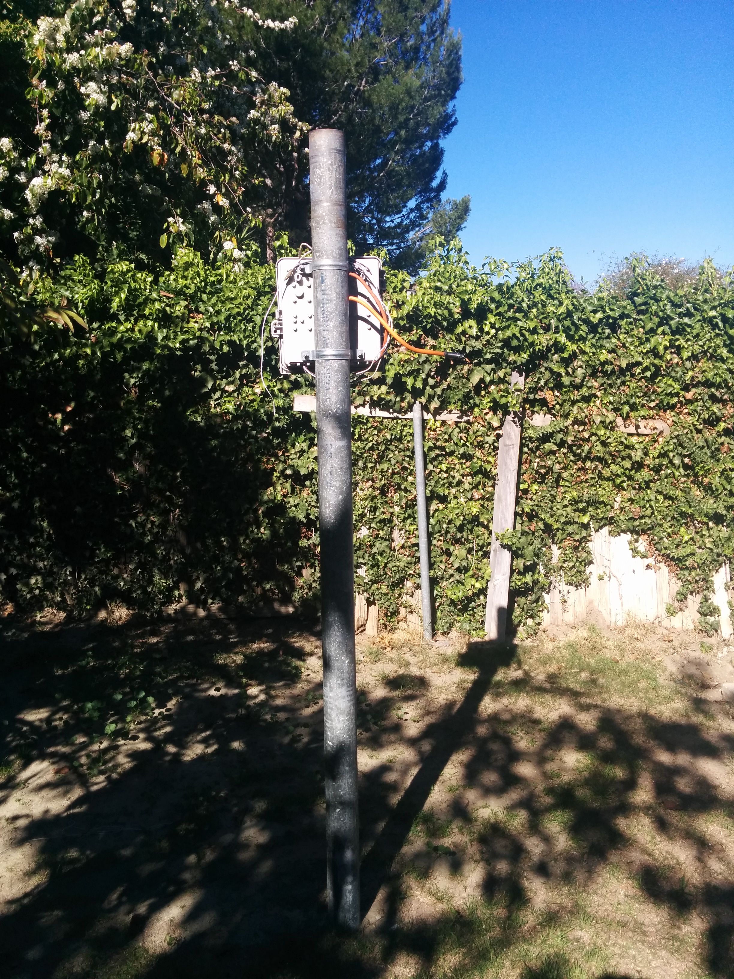

so far so good

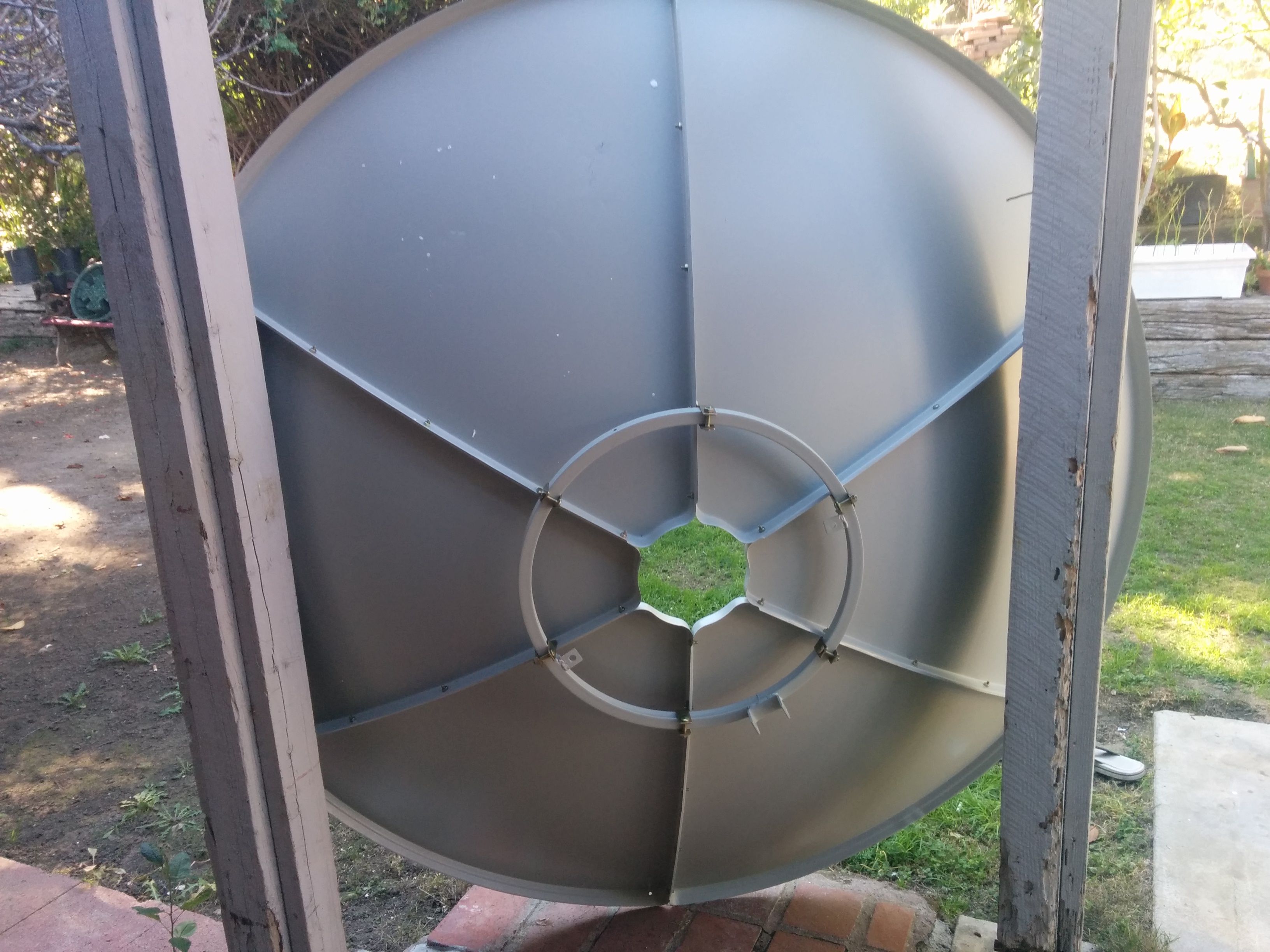

the only think i have to make a adapter for the 3.50od pole to fit the 3.125id of the mount
but i think it should be strong by next week

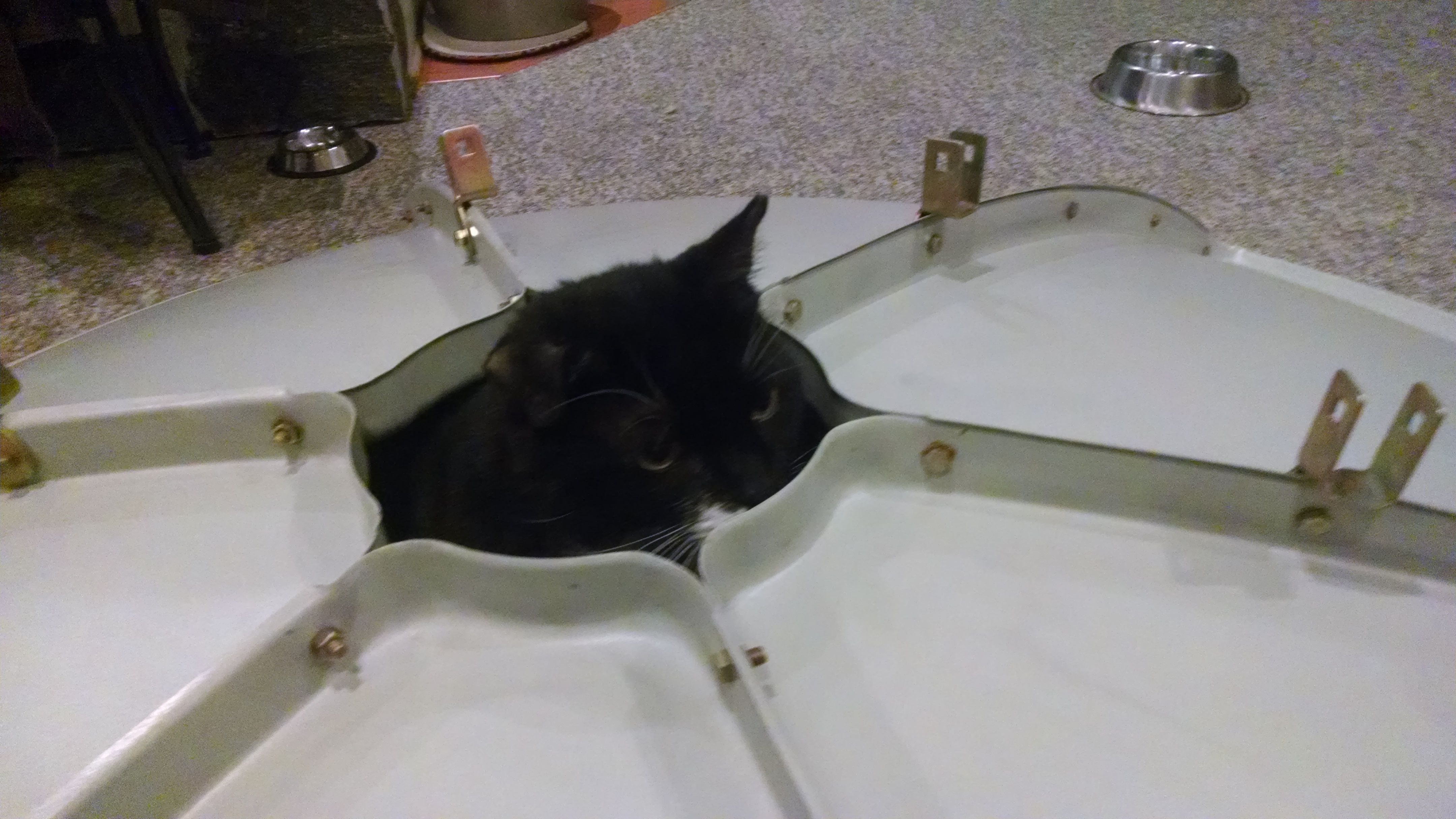

Lookin good . I am assembling mine this weekend.probably mostly inside the house, its cold here.
When I bought one a few years back, I did the same thing. If you have a standard door it will fit just fine assembled right though the door. :)
Reactions: fred555

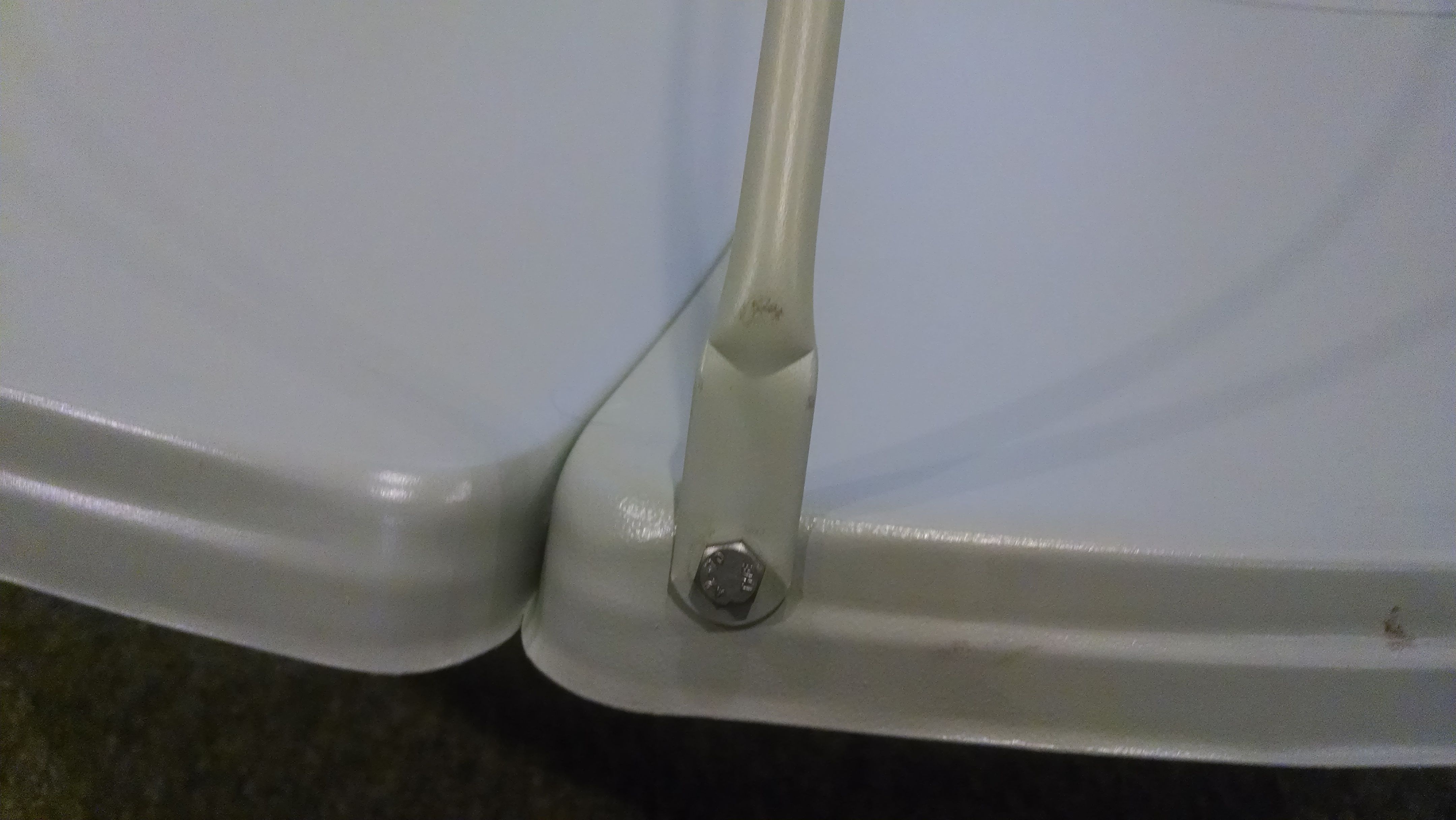

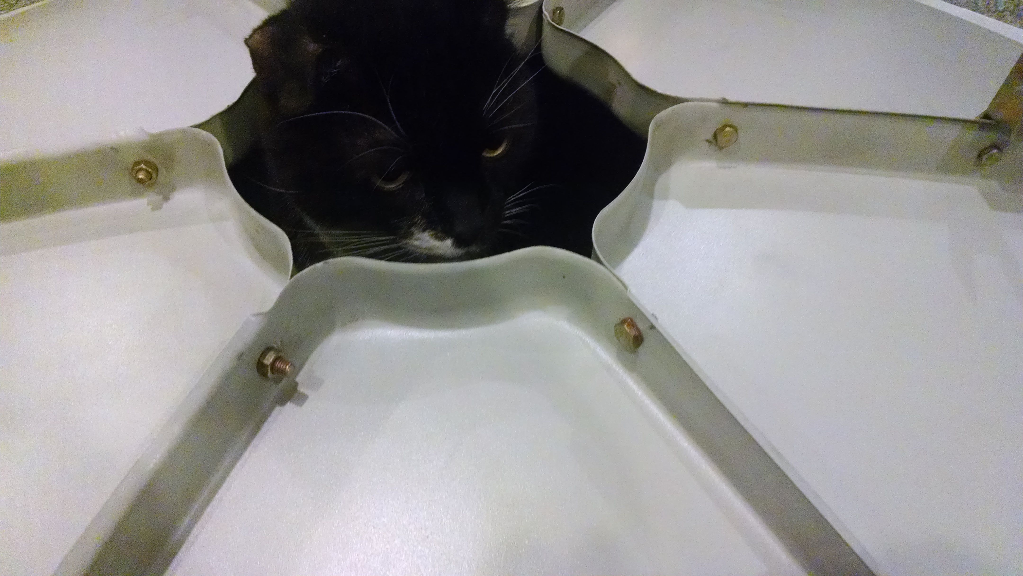

A few years ago I bought that $69 WSI special which this looks a LOT like.
It was cold and rainy outside so I thought I would be really clever and assemble the dish in my kitchen. BAD IDEA. I bent it and warped it in ways that it never recovered from.
Be really careful. I would suggest assembly outside.
I had help carrying it out.

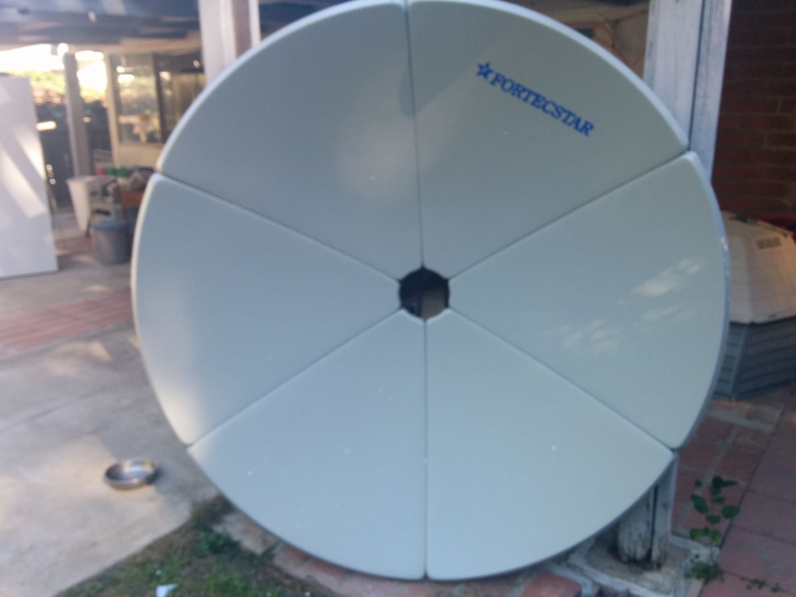

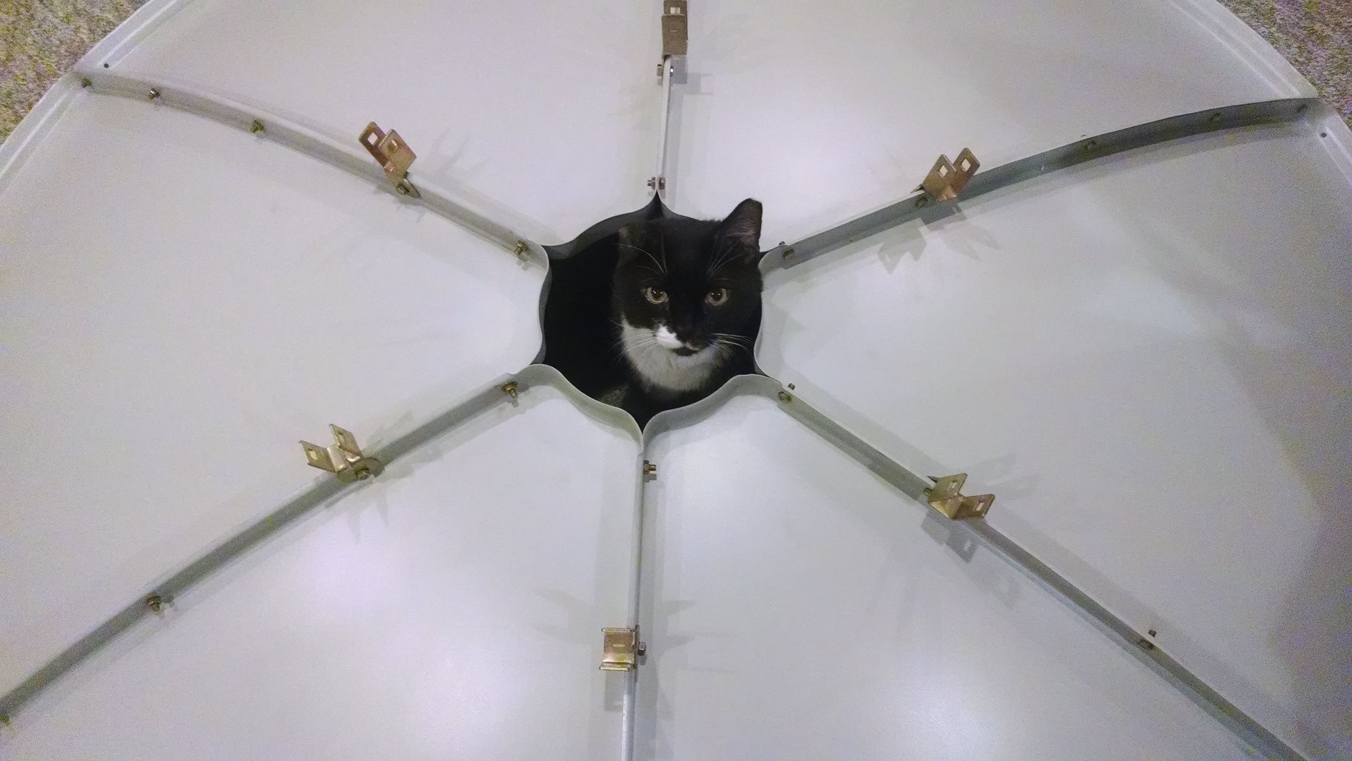

While I still have the dish in the house, I completed the string tests and all is good. I also measured diameter and depth.
Factory specs are
Focal Length = 26.85 inches (~26 7/8'')
FD Ratio = .38
My calculations: (Measured Diameter 5'11'')
Focal Length = ~27 7/16 inches
FD Ratio = .385
