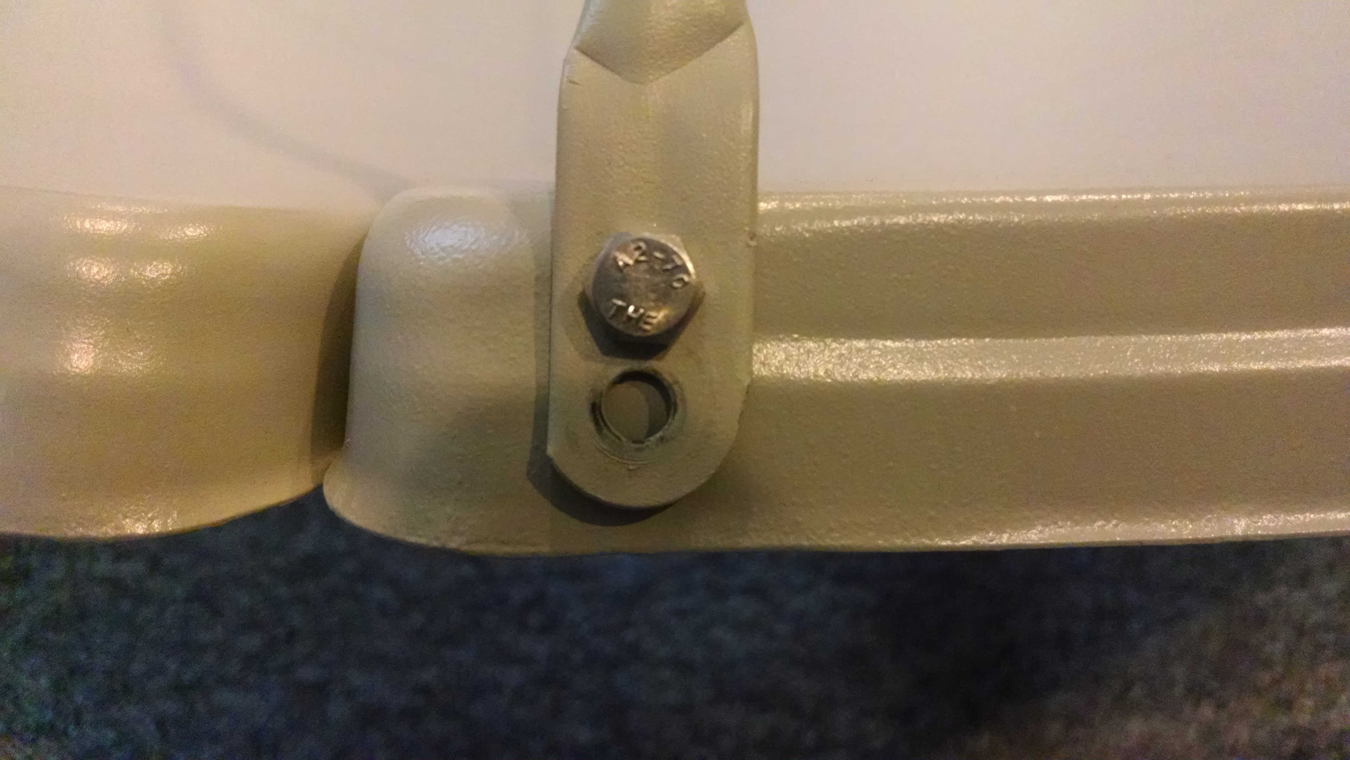

I have set the focal length to 27'' by drilling a new hole about .425'' (center to center) above the old one on the arms:

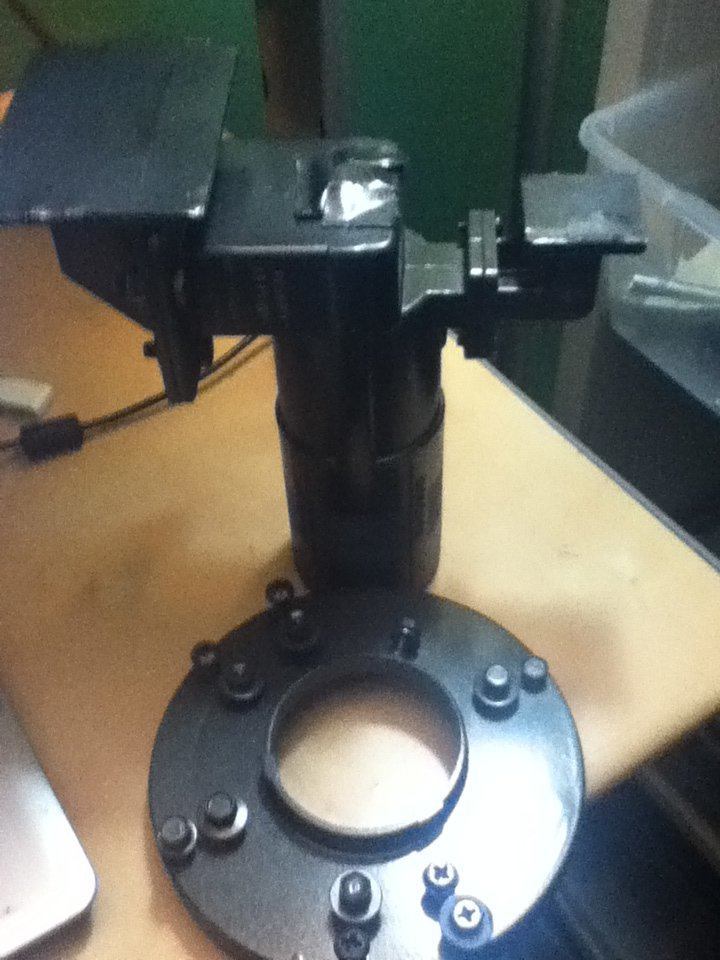

i still need to make an adapter for the pole i have
i rather make a pole adapter than taking down the whole pole with wires in it
its very close tolerance on it so ill be good
this is just an example
i've still learning my measurements for all of it

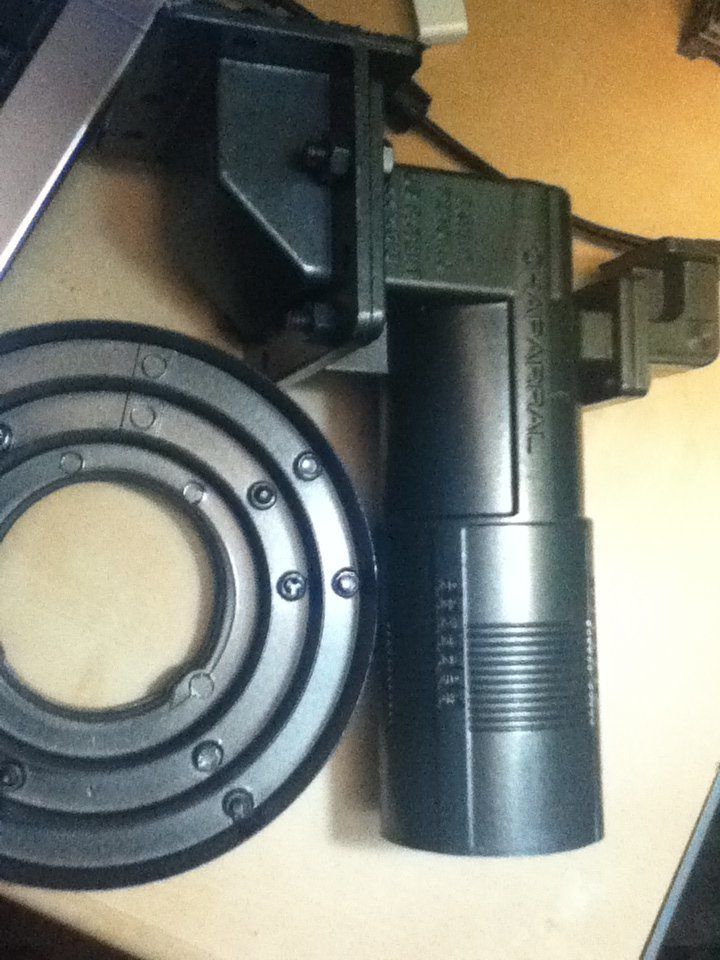

and in the mean while i also repainted my chapparal lnb

Black will be ok if it will be be installed inside a cover. If the feed will be left exposed to the sun, repaint it white.
Black absorbs heat and white reflects. LNB performance degrades as temperatures rises. The black color will likely increase the possibility of thermal frequency drift, decrease the longevity and performance.
Other than that..... It looks pretty! :)

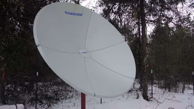

Its ready to go up. Pole was set a few weeks back before the arctic blast hit. May set it today or tomorrow.
Simon Bolivar 78W is my Southernmost sat. I will start there fixed, then steal the motor and vbox off the Quadstar parts pile and play with the motor.
Lots of antiseize and grease was used.
Reactions: Jason S and FTA4PA
Good luck getting her up and running! :) (Calling for 4-6" snow here :snow so no dish work except for cleaning the snow off tonight :rolleyes:)
The snow is about to start here any minute. I am going to set it on the pole in a few minutes.
Temps are above zero finally, a warm +22F now!
Stay tuned....

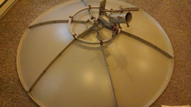

Forget what I said earlier about +22F feeling warm. I am so glad I built the dish inside the house. I also preset the F and FD inside. I could not imagine doing it very accurately in this weather. All I had to do is put in the three bolts where the arms connect to the dish.
Behind me where I was standing to take the picture is a small workshop. I think I can put a TV in the window and tune in the snowstorm. Hopefully today or tomorrow I will post the signal from SB78W. Then maybe the one iBoston found on 89W, hehehe:coco...
Stay tuned....
Conditions have deteriorated. Snow is coming down fast now, dish is covered. Did get a blip of a signal, have a mark on the pole, and have a good starting point for tomorrow.

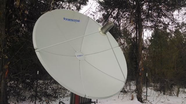

Using a $14 meter I found 91w in about 5 minutes by peaking the meter to something then blind scanning. Have to fix a pipe at a rental but will work to my zenith this afternoon I hope.its easier when it's above freezing and not snowing.
Reactions: FTA4PA
My Zenith sat 78W is in the trees and I cant get to it.

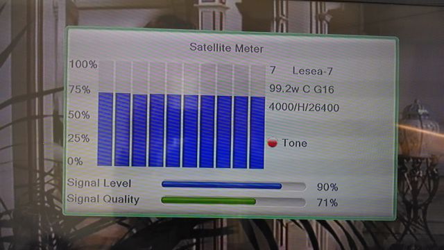

So I checked out all C band birds from 87W to 101W manually.
101w has H&I, Movies! and Decades, so I locked it down here.
Did not and probably won't put the motor on this one, I will save it for the 10 footer.
The focal length and FD set inside the house was dead on, I messed with it and ended up back where I set it. Thanks mc6809e for the advice on this. Glad I drilled new holes in the arms inside!
Did have to tweak the skew since I set it to 0, thinking I was going to motorize it.

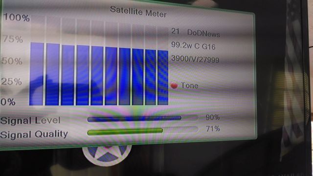

Here are a few pics:
COZI - Fantasy Island !
DOD News
I am under the impression that the Q on a Micro HD only goes up to 75?
I have never seen a Q higher than that on Ku or C.
I get MeTV OTA, but is MeTV and MeTV2 still on 101W?
(Could not get a peep out of that transponder 3973 V 5923).
