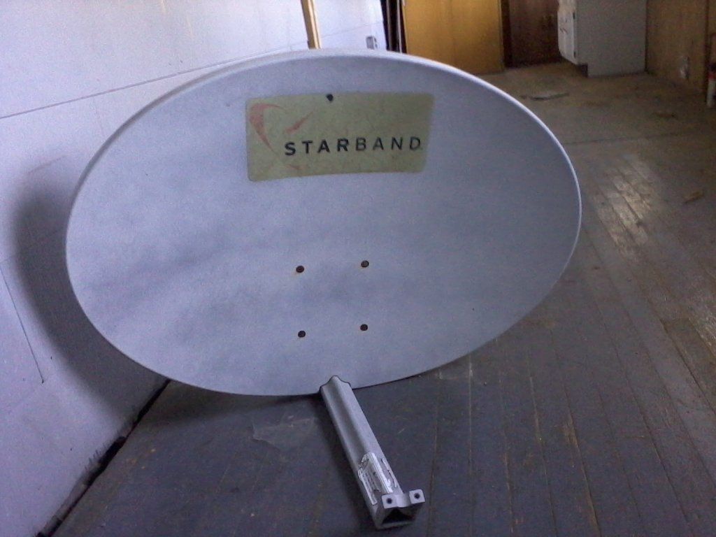

Hello. Looking to get some input as to if I can use this dish for fta reliably. Its a channel master dish. 36 inches wide. definitely not that tall though. More like the shape of a direct tv dish. just bigger.
Yes you can you that! :)
You got any pictures?
Look for some numbers on the back (molded right in the dish ) might be what's refered to as a 75e (37x27) "Elliptical"
Do you have the original feed?
well it says star band on the front. Definitely much sturdier than a direct tv or dish network dish. Bigger. I thought it was a prim star dish at first. I can take some picks later
Hmmm...Yes post some pics and any model numbers you can find.
If it is a commercial Starband it maybe ok.
The consumer ones are a little on the small side usually.

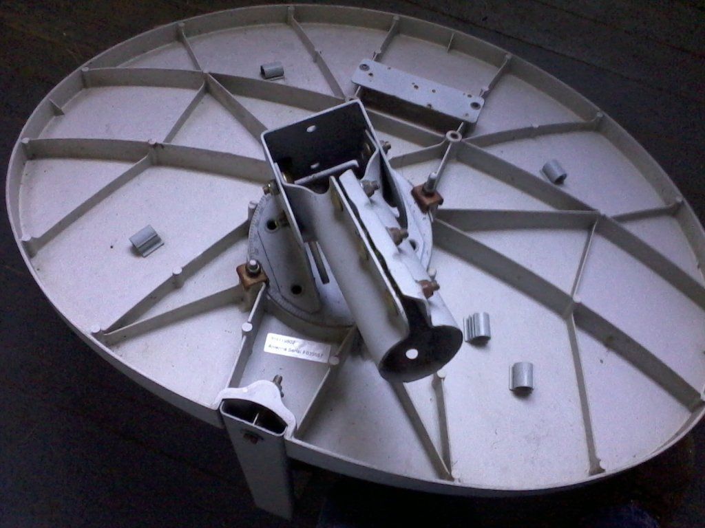

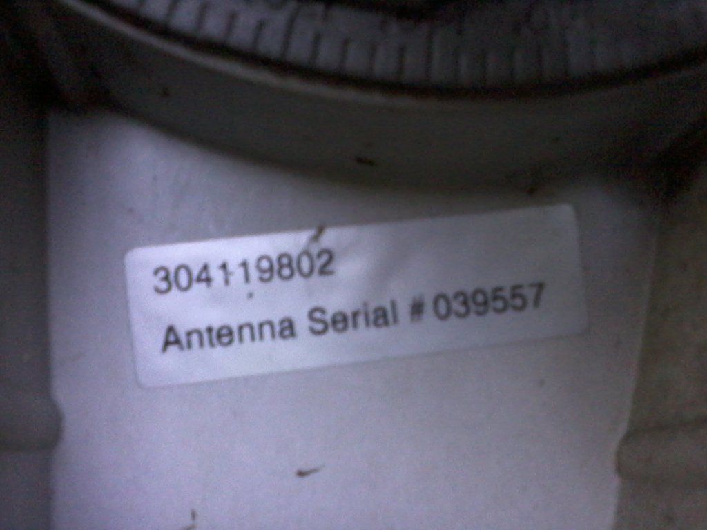

ok. Sorry it has taken me so long but I don't have internet at my new home yet. Here are the pictures I took..UPDATE. just relized my pictures didnt all get uploaded and some didnt show. Not sure whats wrong. But the part numbers 3041198 mold number 75e-1 made in the usa.

The degree scale is for skew angle setting only. The elevation is set with the side bolts and the azimuth is set by rotating the mount cup on the pole.
