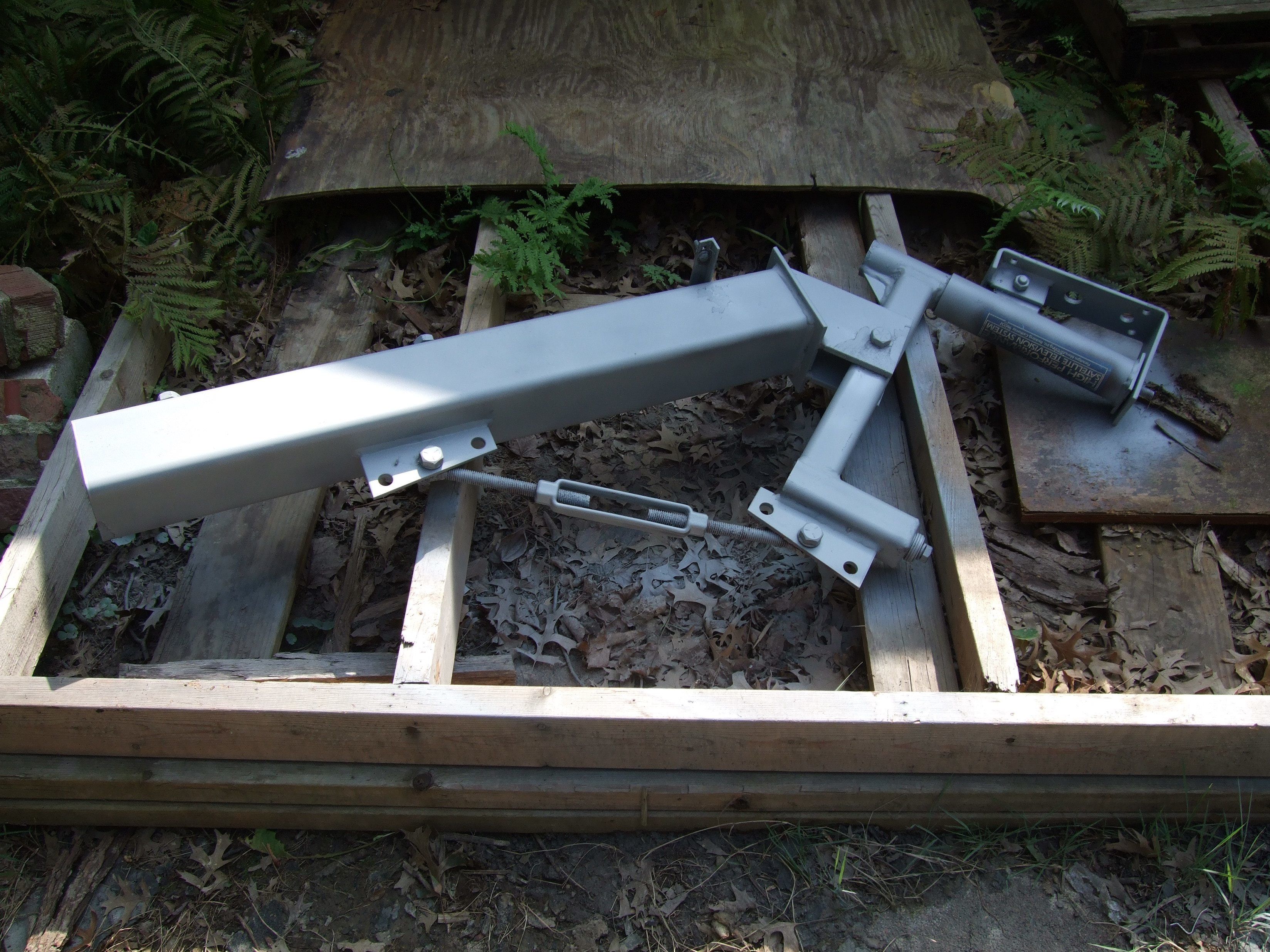

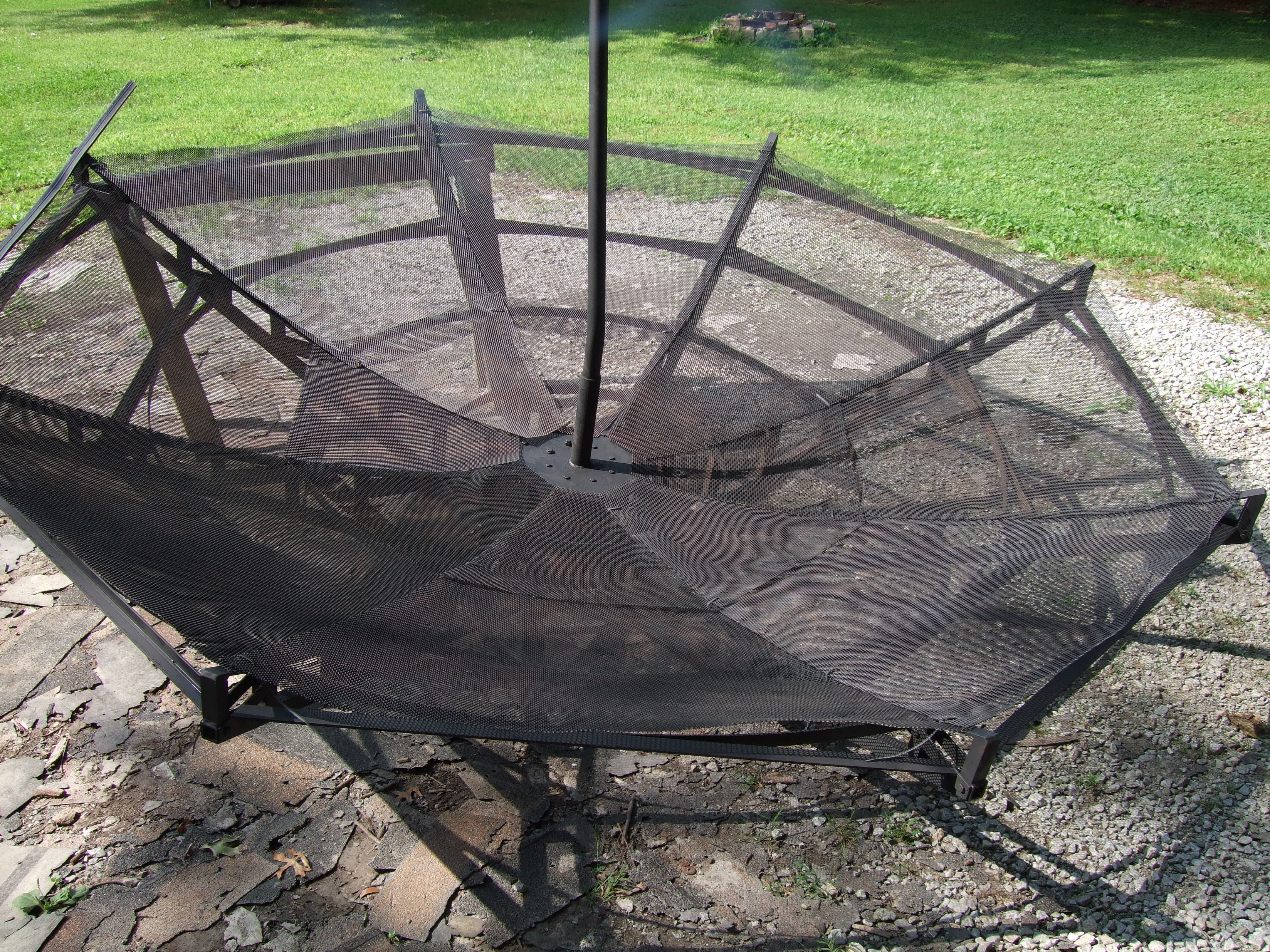

Ok folks I screwed up this weekend and spent $60 on the 8 foot dish I posted questions about last week. It was totally disasembled so it was hard to tell what I had. If someone wants it...come and get it. My wife and I spent all day Sunday and realized the dish and mount are way too heavy for what I need it for. The dish is together pretty much. The clips for the mesh were gone, so most of it is wire tied back together for now. Lets see I have the mount which looks to take about a 3 1/2" square pole...very heavy mount. The feedhorn cover is still there...no lnb.
There's whats left of an old Uniden accuator...looks shot. Also I replaced 99% of the bolts holding the dish together...lost more $$$. Looks like the dish post on another Paraclipse posting here....just a little rougher shape. Put together it's too heavy for me and the wife to mess with...If someone wants to come and get it....let me know:(

I tried to post a pic of the dish after I put it together and a pic of the mount. I never have uploaded a picture before so hope it works Blind
Looks like you will need a pole that is about five feet above ground. If it is an eight foot dish i guess you could go down to four feet, but that would put the edge of the mesh reall close to the ground.
I would install the mount first. Then I would fix up the mesh but leave off the bottom panels. That would allow you to use the cross ribs between the trusses as lifting points to lift and hold the dish while bolting it to themount.
