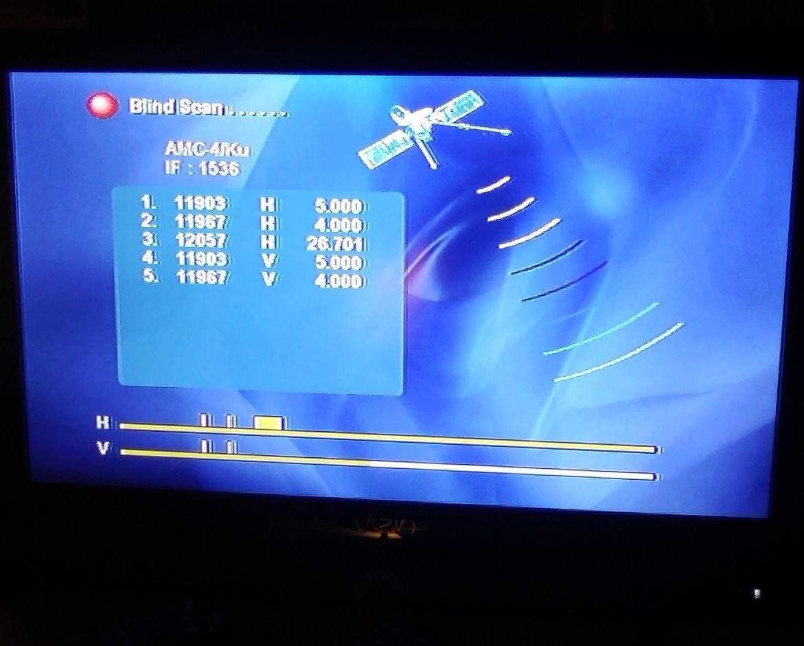

Yeah just move the dish to a sat that has both (say next door at 101W W4) and scan in C-Band. Then go to the antenna setup and find the AMC4/SES1 KU side. Make sure to have the LNB LO to 10750, 22k ON and then blind scan. You should get a bunch of channels on KU and then you can check what the signals look like quality wise

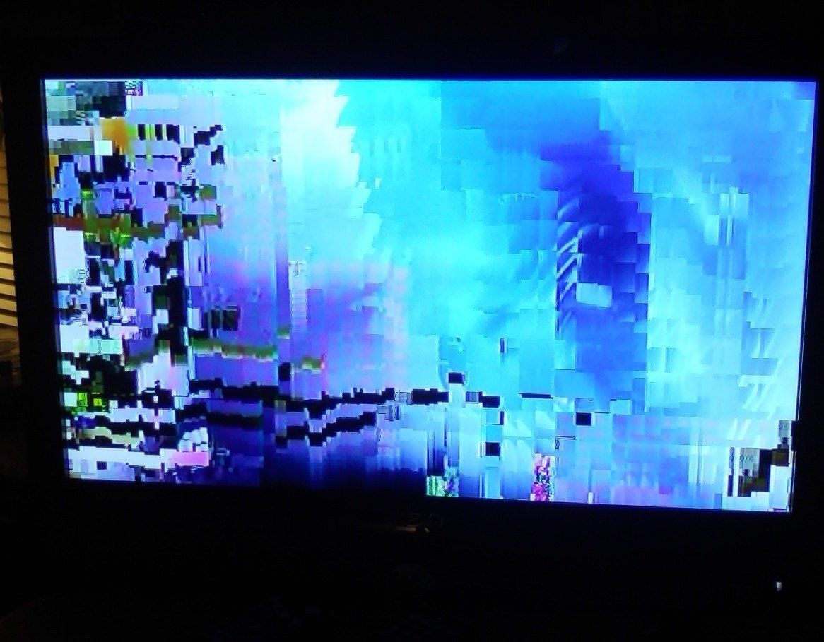

Hooked up the LNBF jumper scanned appropriate satellite. I'll need to do some work, it's all "tile" but...at least its there! (see pic.) However, I'm more worried that I have an LNBF that is going to be unstable. As I tightened the KU feed down, the whole nut that's against the housing rotated, meaning the feed INSIDE the LNBF is loose, and could be intermittent.
So, I guess I'll have to order another 621...or...what's the other one everyone likes? the 741? And, if I do, based on the build, shouldn't alignment in general be the same or similar in terms of physical install? Now I have the chance to make a good choice! (and I'll still try to tweak this one, too.....maybe I can make it run until I get the new one!)
tiling means low signal quality...so you're close but may be off by a smidge. I noticed the 1st pic didnt have as many H transponder items as I have picked up. I think there are 6 H transponders on W4

My 621 LNBF had a loose "f" on its chassis connector, and I suspected an intermittent connection, possibly contributing to the "tiling." (as shown in previous Pics)

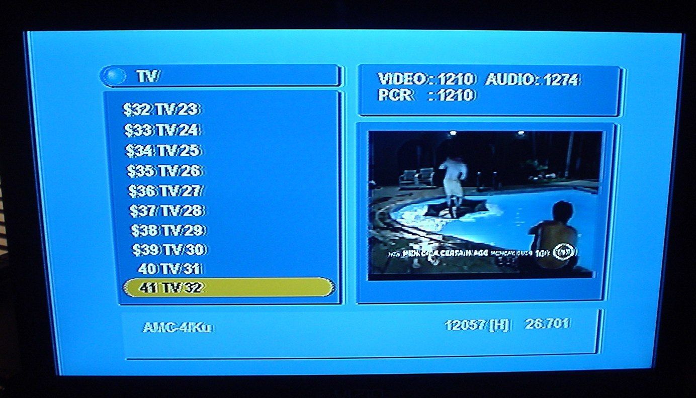

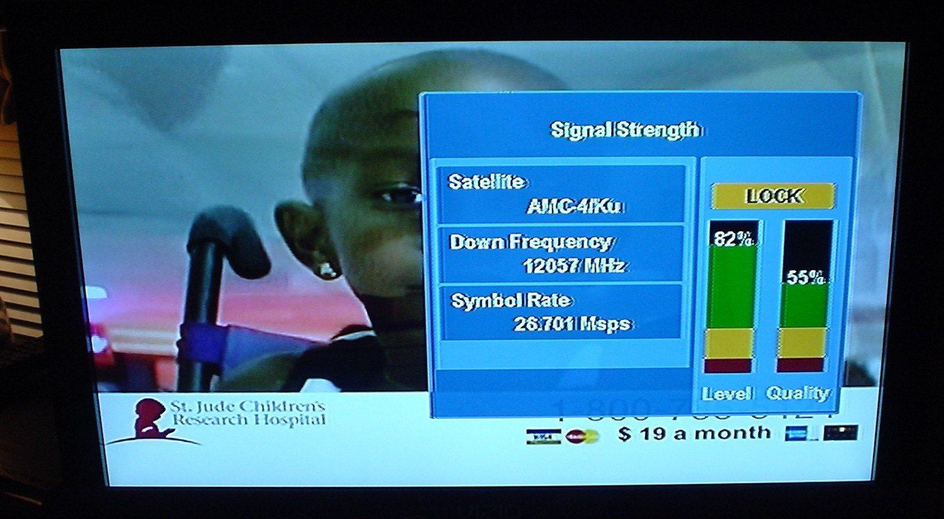

Onto Ku....a longshot at best. But, following instructions and going to AMC-4/W4 on the Ku side, I did a scan as shown. 41 transponders showed up! Then, going to the actual channels, for a "blind" alignment and on a rainy, cloudy night which, even on a birdview could reduce signal, I'm IMPRESSED.
After our radio station's weekend food drive is complete, will tweak a bit more and post results.
Anyone with a Birdview, and one of these modern LNBF's can retro fit with only honing out the middle of the original Scalar plate, and should get similar results. I'm sure we can pull a bit better signal with some time and work, but I'm very hapy with this "blind" alignment. Pun intended.
