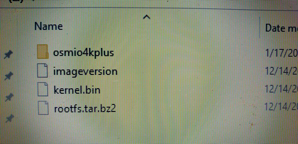

The attachd pic is what is on my usb drive...the folder in it also contains the same files...

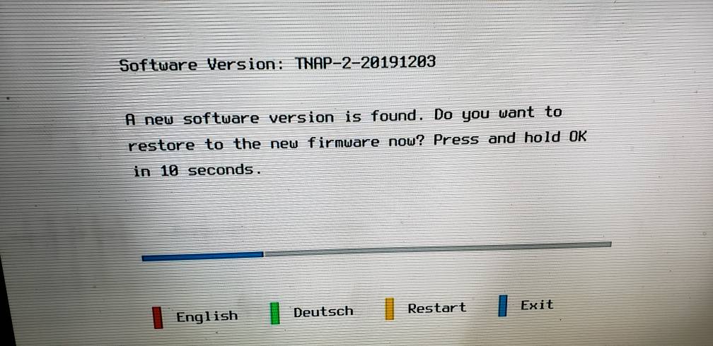

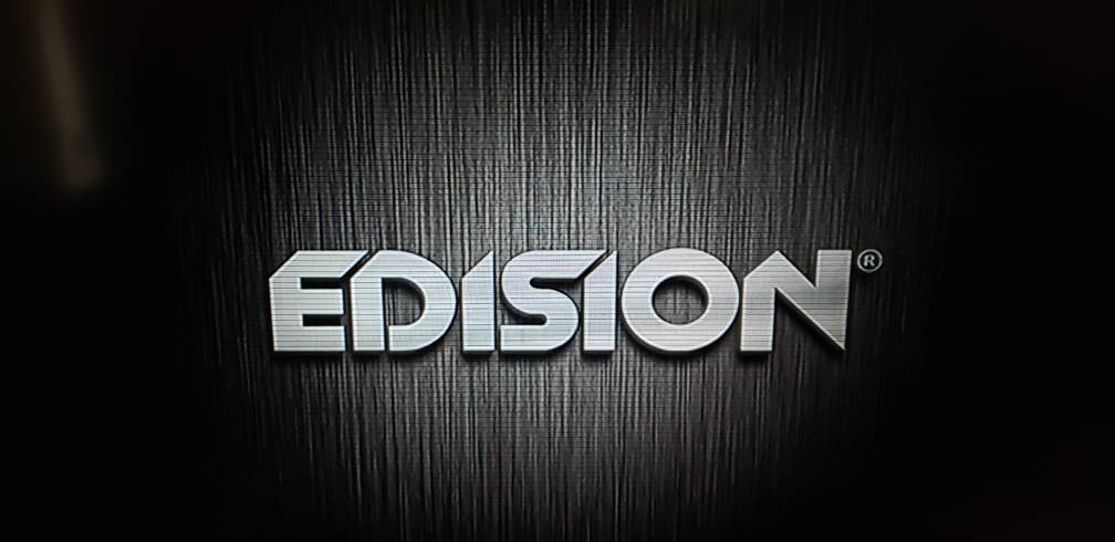

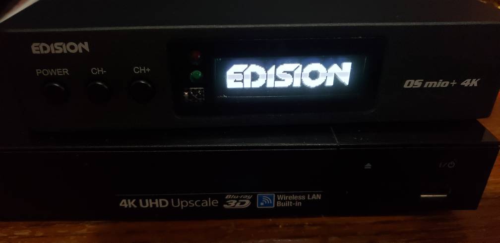

When i power cycle with it in usb...i get a screen that says new version press and hold ok in 10 sec...well it sits n sits on edision logo on screen and on box display...

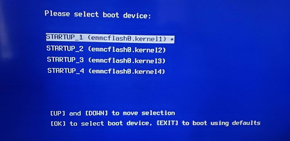

I power cycle and press menu..get the multiboot screen... pic below
But still no boot...i think its empty

Why the flash on the flash drive you are trying does not load is because there is no emmc image on it. it is a multiboot flash and that needs to be flashed with ofg write and the flash image menu. once you get slot1 working you can reload Tnap2 with the flash image menu.
I have it going again...i loaded satdream like you said..then i loaded tnap2 (slot 1)..its back to how i had it before i messd it all up...now im trying to put satdreamgr into another slot...
