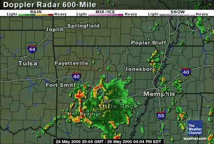

I am moving my dishs around today, working on getting my setup finalized. I have both my p* and my 76cm pointed at g10, with disappointing results. Neither of these two dishs are giving me enuff signal for a good lock on tp 11720v.
The p* with a 2700a hooked up to it, no switches in line, is giving me in between 17-32% sq. I have a lock, but I know if a gnat flies in front of the dish I will loose signal.
The 76cm with my satworks hooked up to it is only giving me a 32% sq, not enuff to lock. Both dishs are peaked for best signal. Has anyone else noticed very low sq on that tp today?
hmmmm...maybe this is why? :D;)
Uplink is in Little Rock
D'uh, that would explain it lol. Thanks Iceberg I should have checked the weather down there.

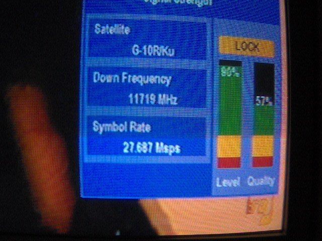

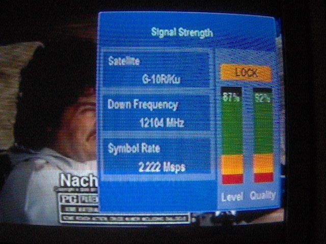

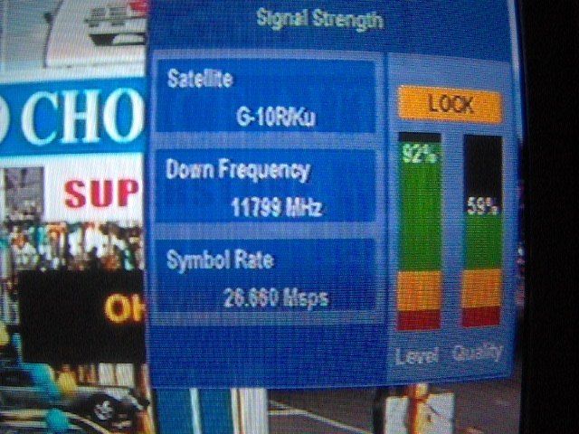

Thats what I'm getting with the 36" dish on G10 :)
(Pansat 1500)
