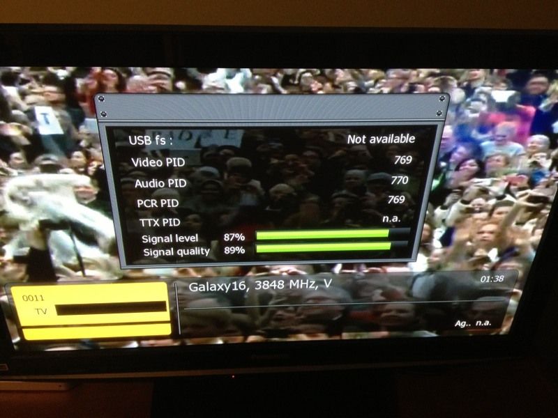

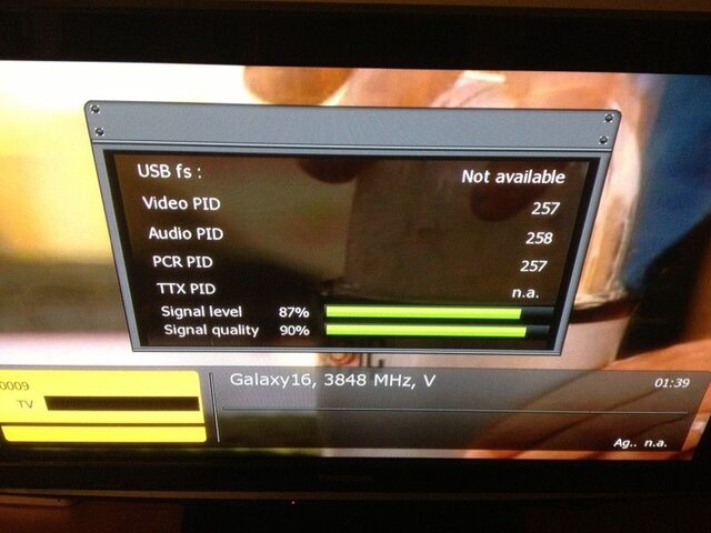

The channels in question came in thur a blind scan just fine.
