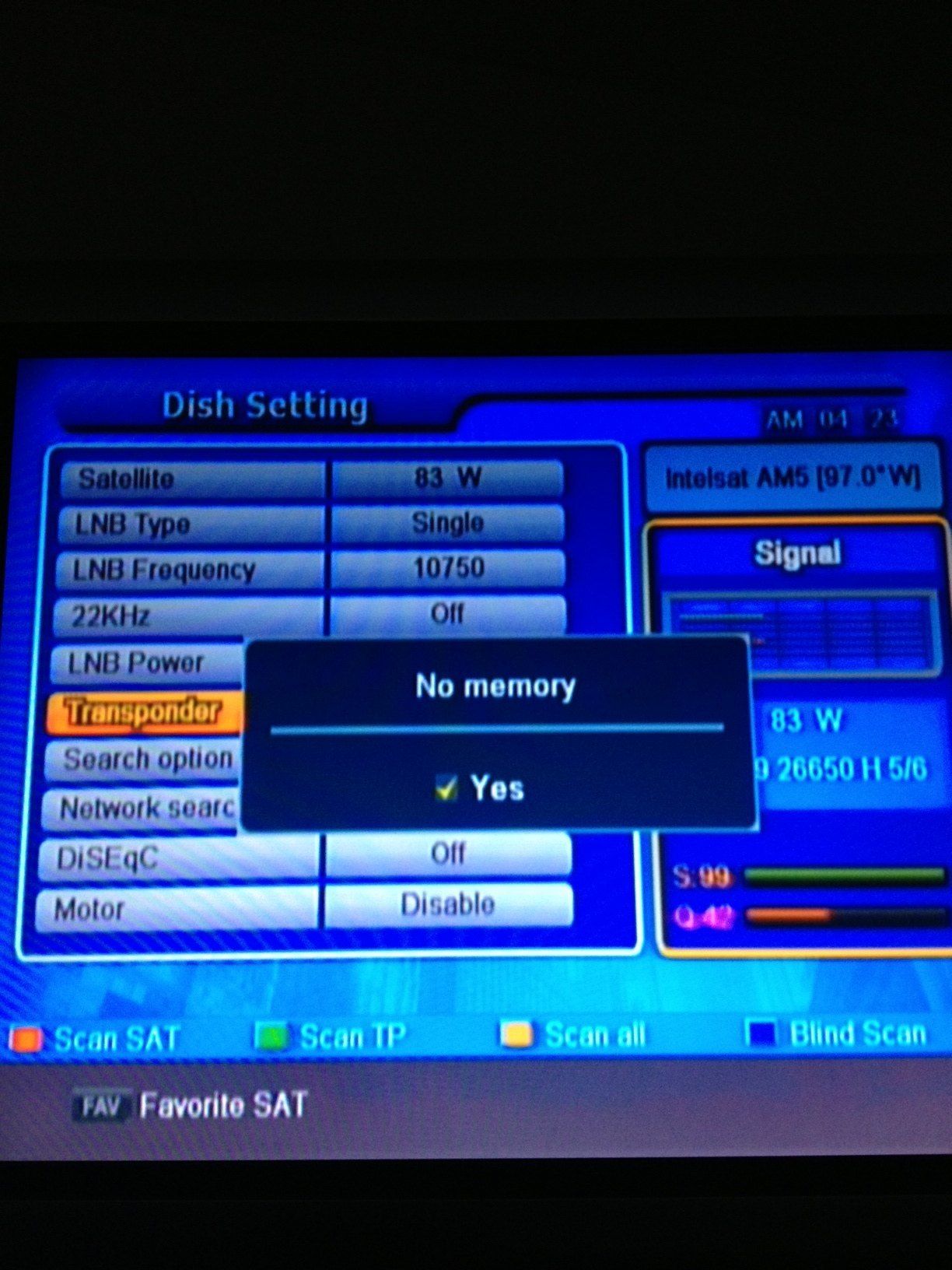

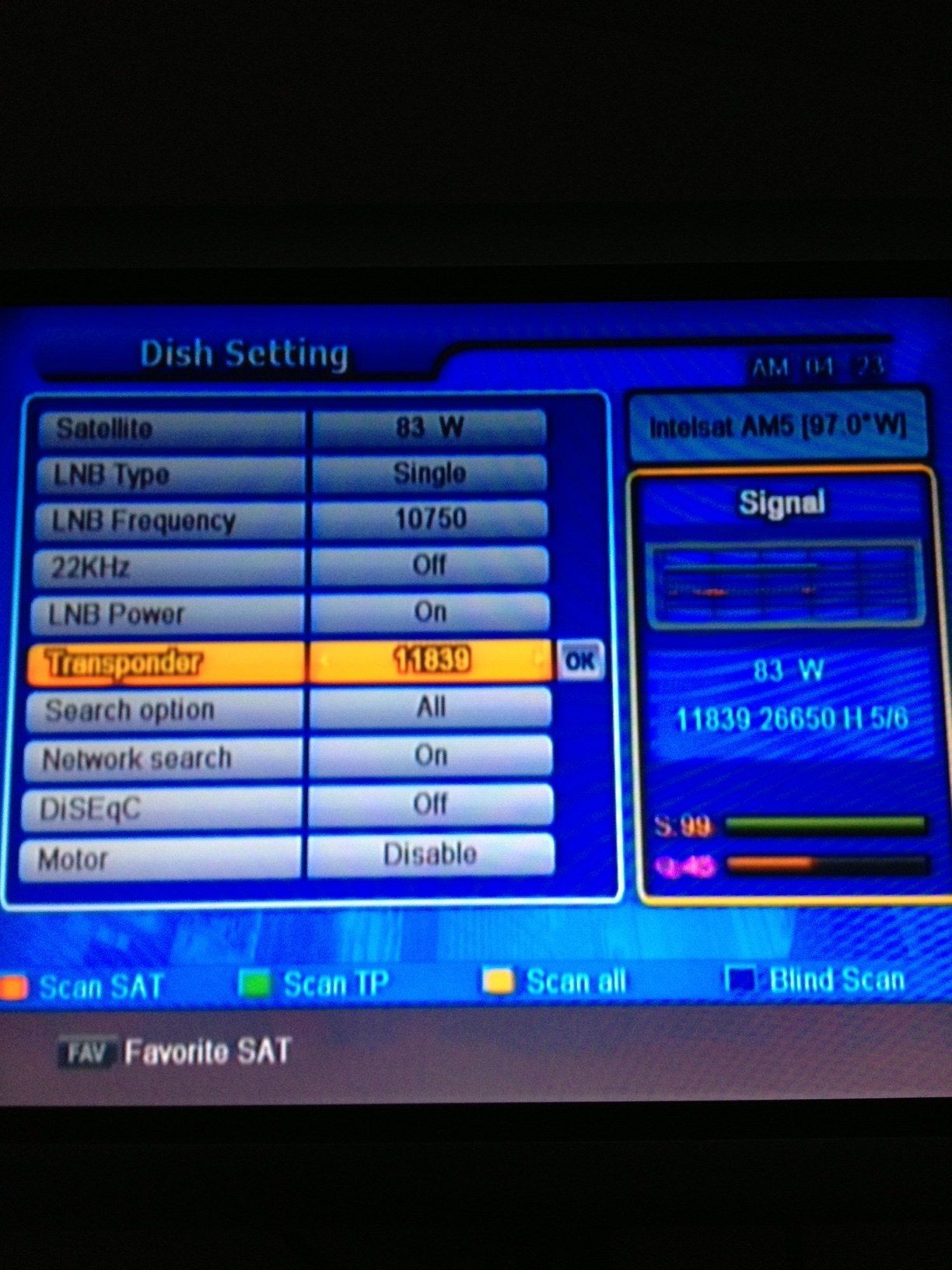

Im trying to do a TP scam, or any scan on 83W, I keep getting a screen message, "No memory" and a check mark beside Yes. And, my signal is 99 and my Q is 43... shows above where my S&Q is: 83W 11839 26650 H 5/6... BUT... above that it also shows: Intelsat AM5 [97.0 W].
I have 2 dishes set up, one for 83 and one for 97, right now as I write, I only have cable going direct to my 83...
Can someone explain what its doing, please. I can add pictures i guess if that helps.
disregard what it shows in the right corner....those satellite ID thing really has never worked here in North America
signal means nothing
quality is what you need
No memory sounds like you are scanning a transponder with no channels on it (like the TP you posted...its data)
G16 format
