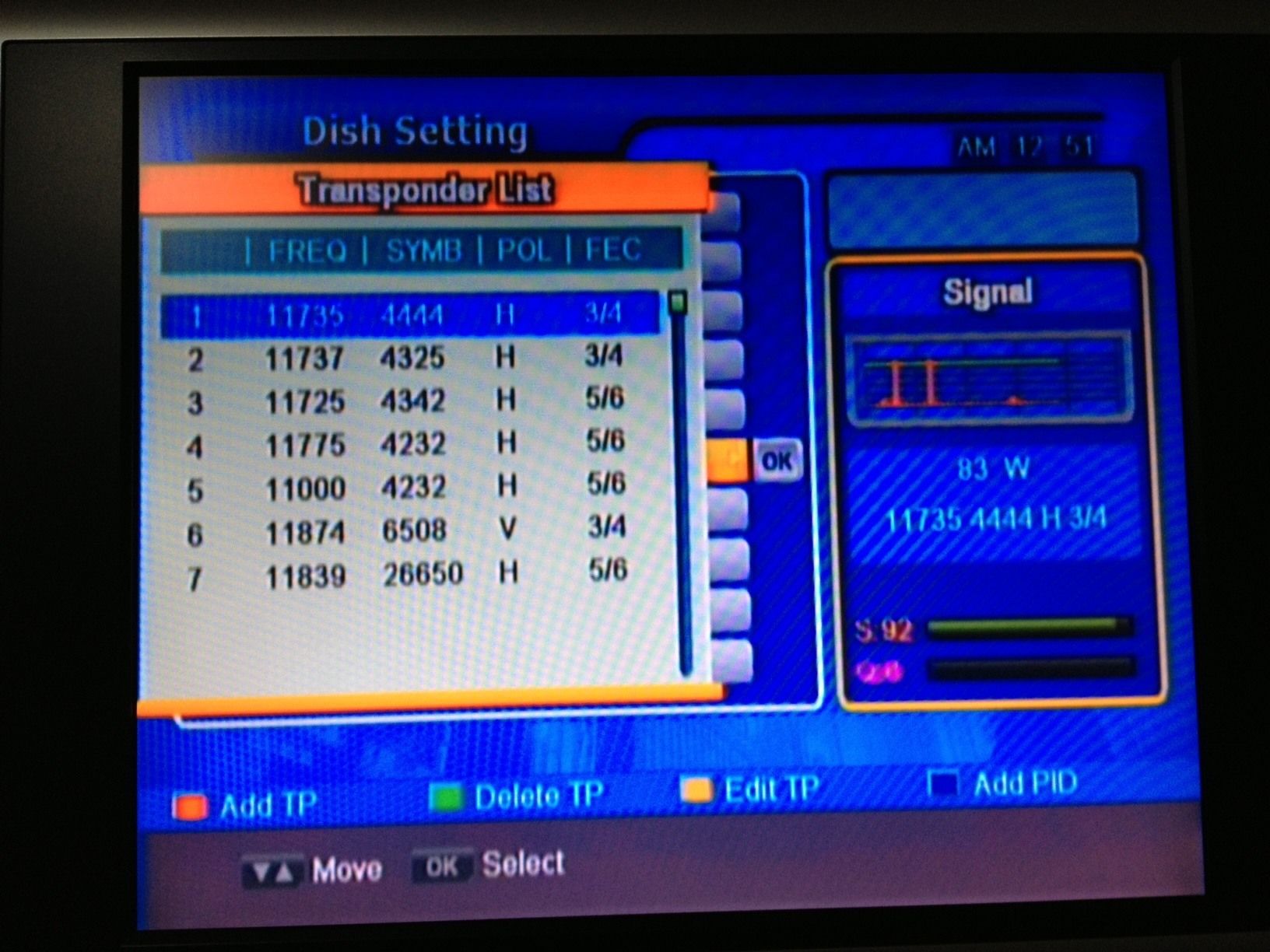

Ok guys... can you tell me this.. On 83W I use these TP's, and today DJdish advised my to use this one: TP 11874 V 6508, I figured the FEC of 3/4...
So my question is, What other TP's can I add to make it even better, and why was this one that DJdish suggested a V and not an H like the rest....
Here is a picture of the TP's that my system uses right now, can I delete the "not needed" ones?

Just to clarify, the tp I gave you as I mentioned was active only during the time we exchanged the PM´s, that tp is not active all the time, the tp that is to be active all the time on Ku with FTA channels is the one for RTV, Tuff and PBJ which is 11735 H 4439.
Some of the tp´s on a linear sat will be V and others H.
Just to clarify,FTA channels is the one for RTV, Tuff and PBJ which is 11735 H 4439.
Mine is set for that one : 11735 4444 h 3/4 , **Should I be changing it to 4439?
No that is close enough. My scans always say around 4439 to 4442.

Why don't you just go to the main menu, simply press the blue button and do a blind scan? In less than 5 minutes you'll have everything available on that satellite.

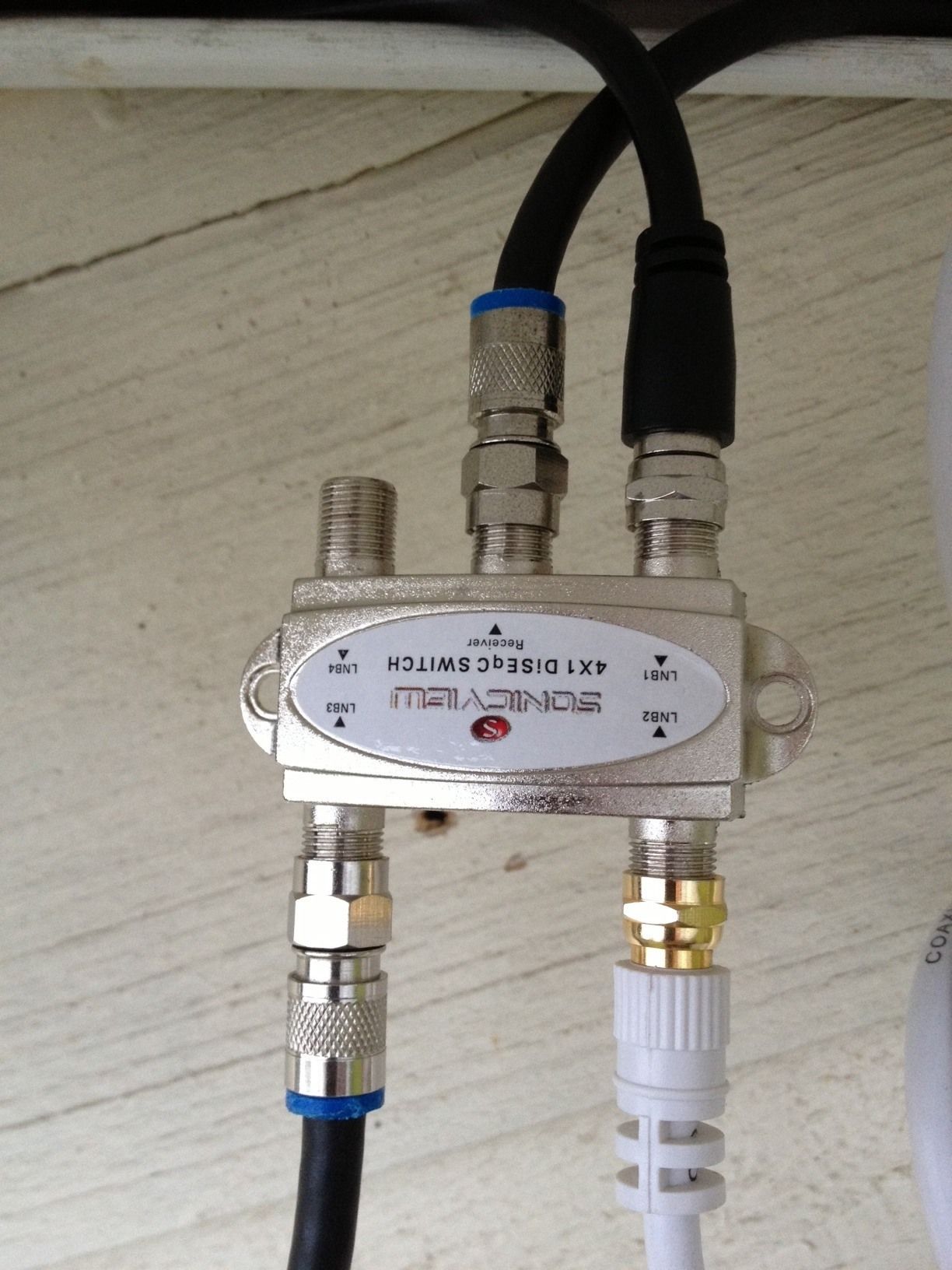

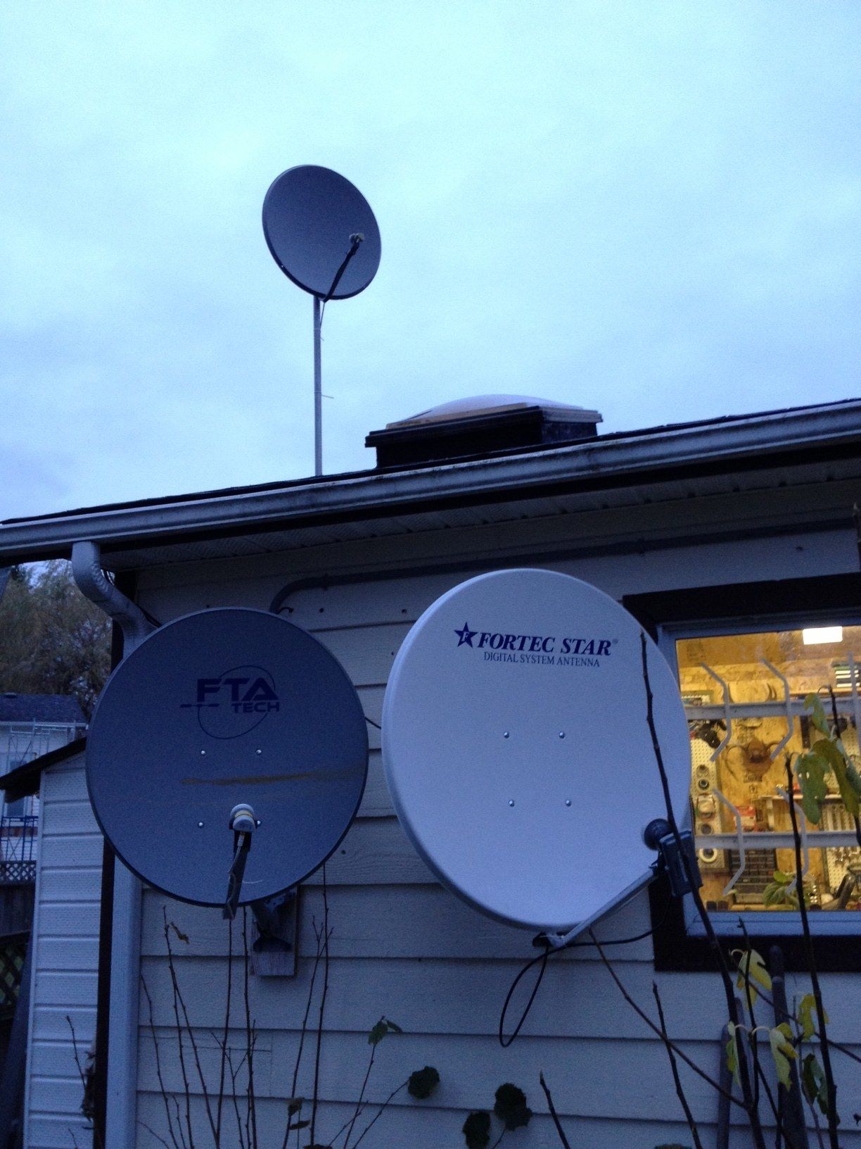

Here is my setup, on the SonicView SV360P.
The 3 dishes are: the roof top, 83W, on Port 1, got the dish free and bought a $9.99 linear LNB, the pole (@ $25.00) was fun to bang in the ground from the roof top, The FTA Tech dish, pointing at 97W, on Port 2, was also free, again I bought a $9.99 linear LNB, and the Fortec Star, 95W, on Port 3, got that dish for $10.00, plus 50' of cable, 2 Circular Dual LNB's (now for sale), a Switch, not the one I'm using, and the mounting hardware...
Here is the pic's enjoy.. thanks for all your help....

Thanks all, things seem pretty good with my setup now, besides 83W not working..

You need a linear LNB for that dish pointing at 95w
