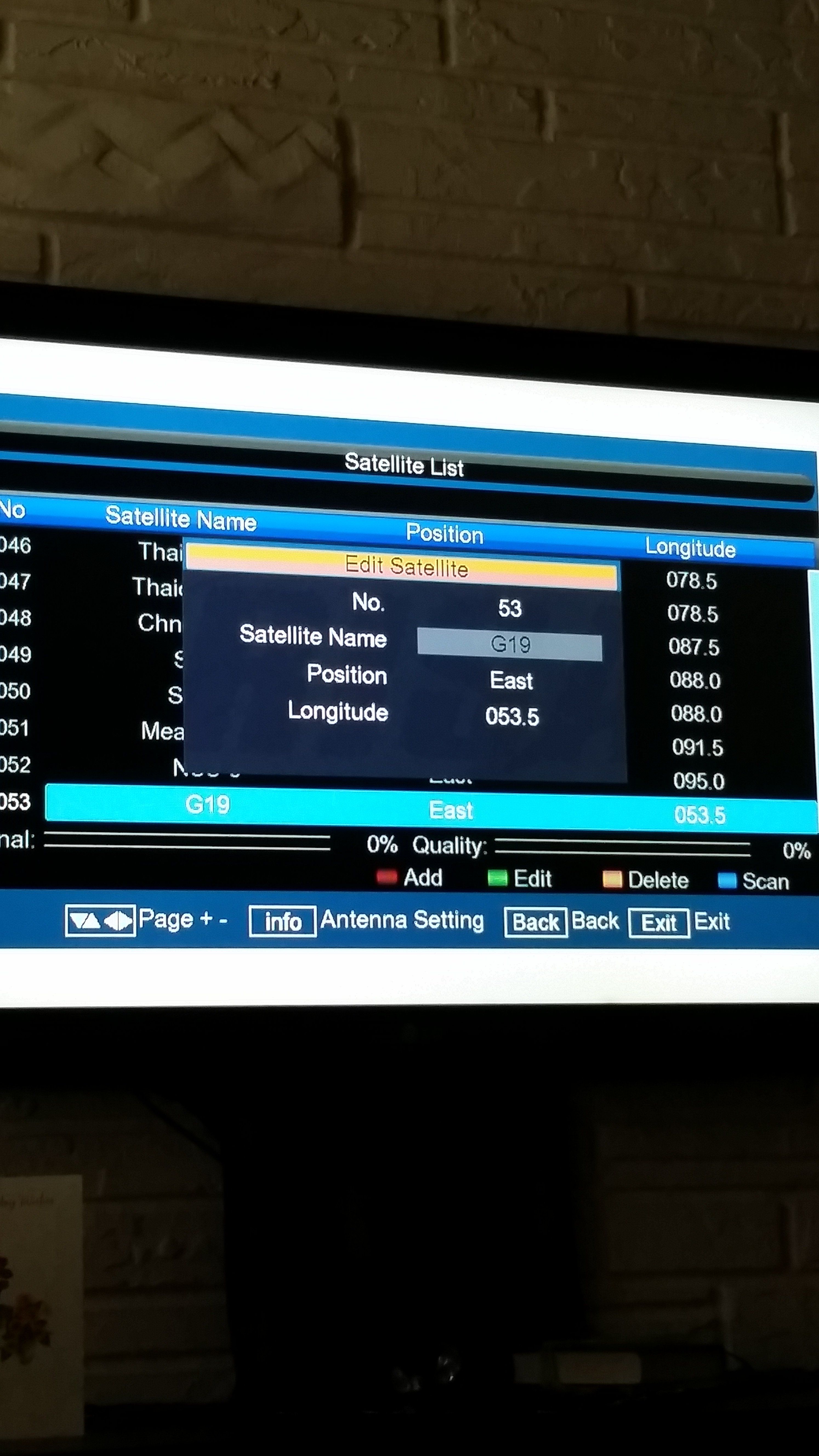

I have 2 Tokyosat 90cm dishes already mounted 2 days ago, trying to get these to receive galaxy 19, it's making me crazy please help. I don't know if my skew is off or if my wiring from lnbf to switch is wrong or if I'm aiming wrong or what

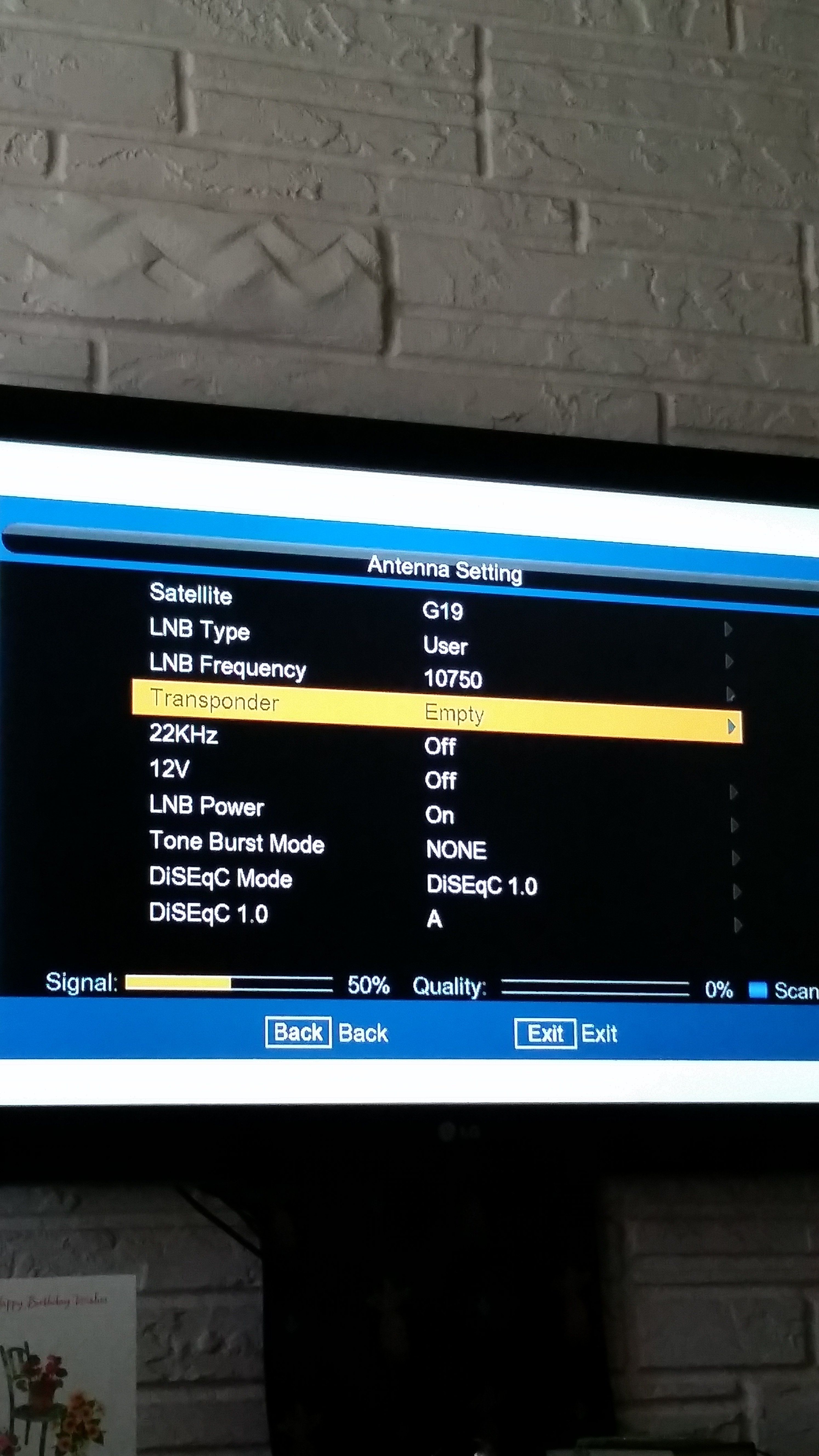

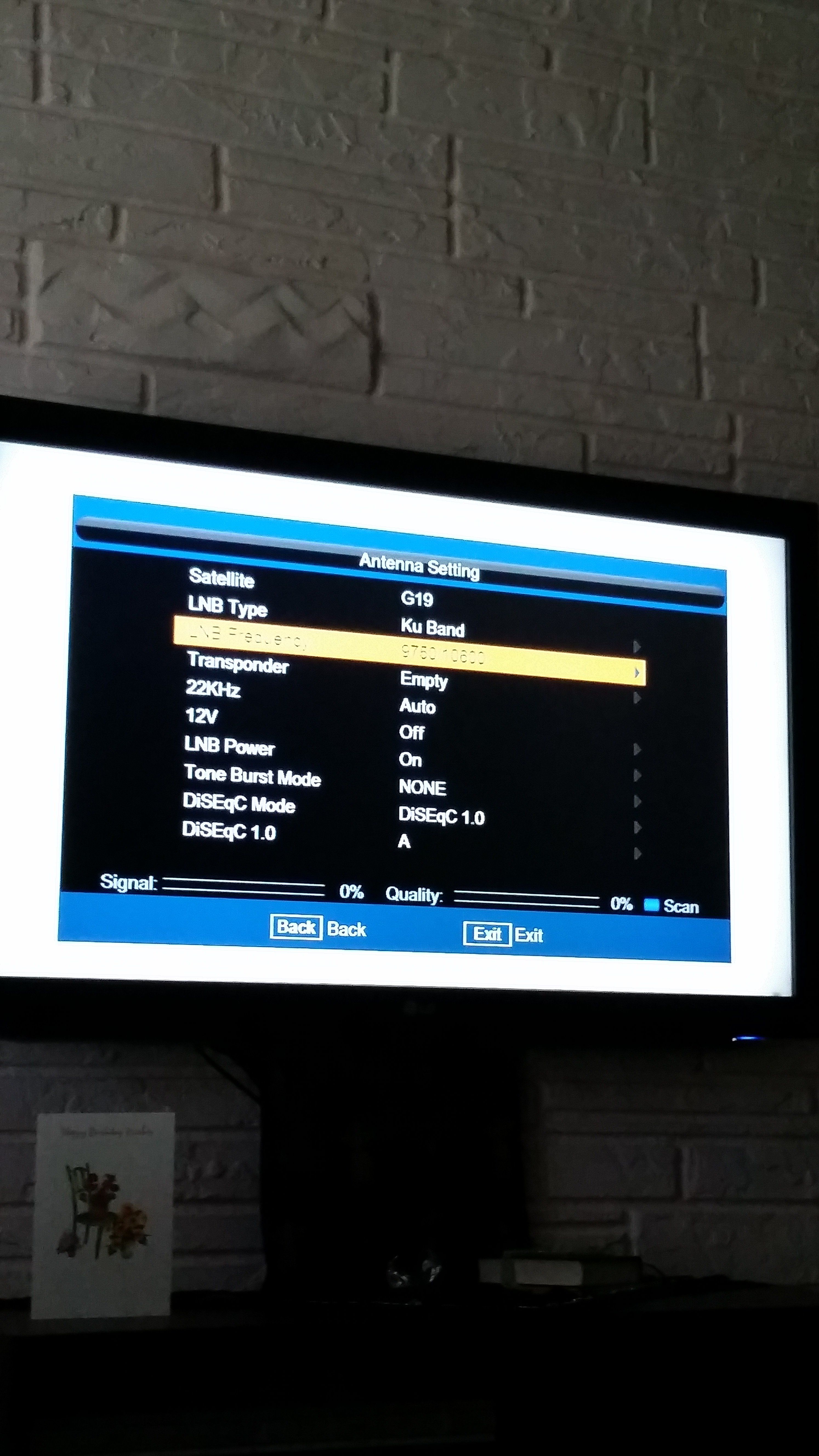

What is the LNB type selected on the G19 install menu screen?
What is the LNB LO frequency setting on the G19 install menu screen?
What transponder is selected on G19 install menu screen?

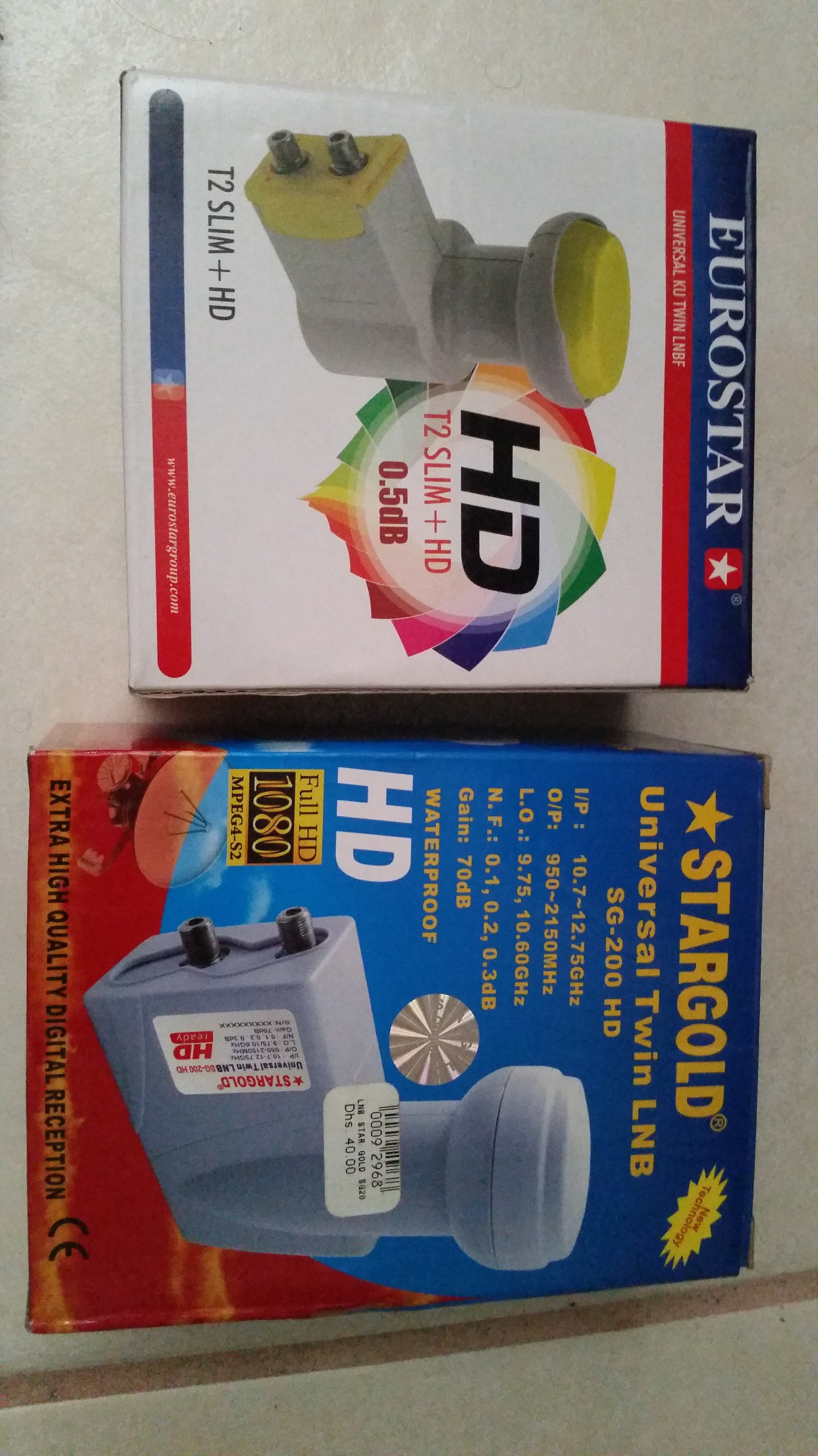

The receivers are arisat AR2000 mini HD and Newmax 774 mini HD, lnbfs are stargold SG-200 HD and Eurostar t2 slim+HD

In addition to the rest of the questions... This receiver is not distributed in the North America, does it have Galaxy 19 satellite in the install menu and pre-programmed Galaxy 19 transponders?

You need to figure out how to add transponders in those receivers.
The receiver will not provide a Signal Quality reading unless an active transponder is populated in the list. Find a menu screen for adding transponder parameters and enter:
Transponder Frequency: 12152
Polarity: Horizontal
Symbol Rate: 20000
Then save and exit back to the install menu and make sure this new transponder is selected from the list.
I'm not seeing a LO and the lnb type has ku, c and user

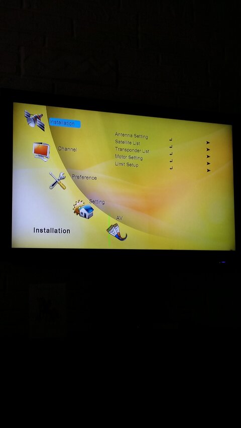

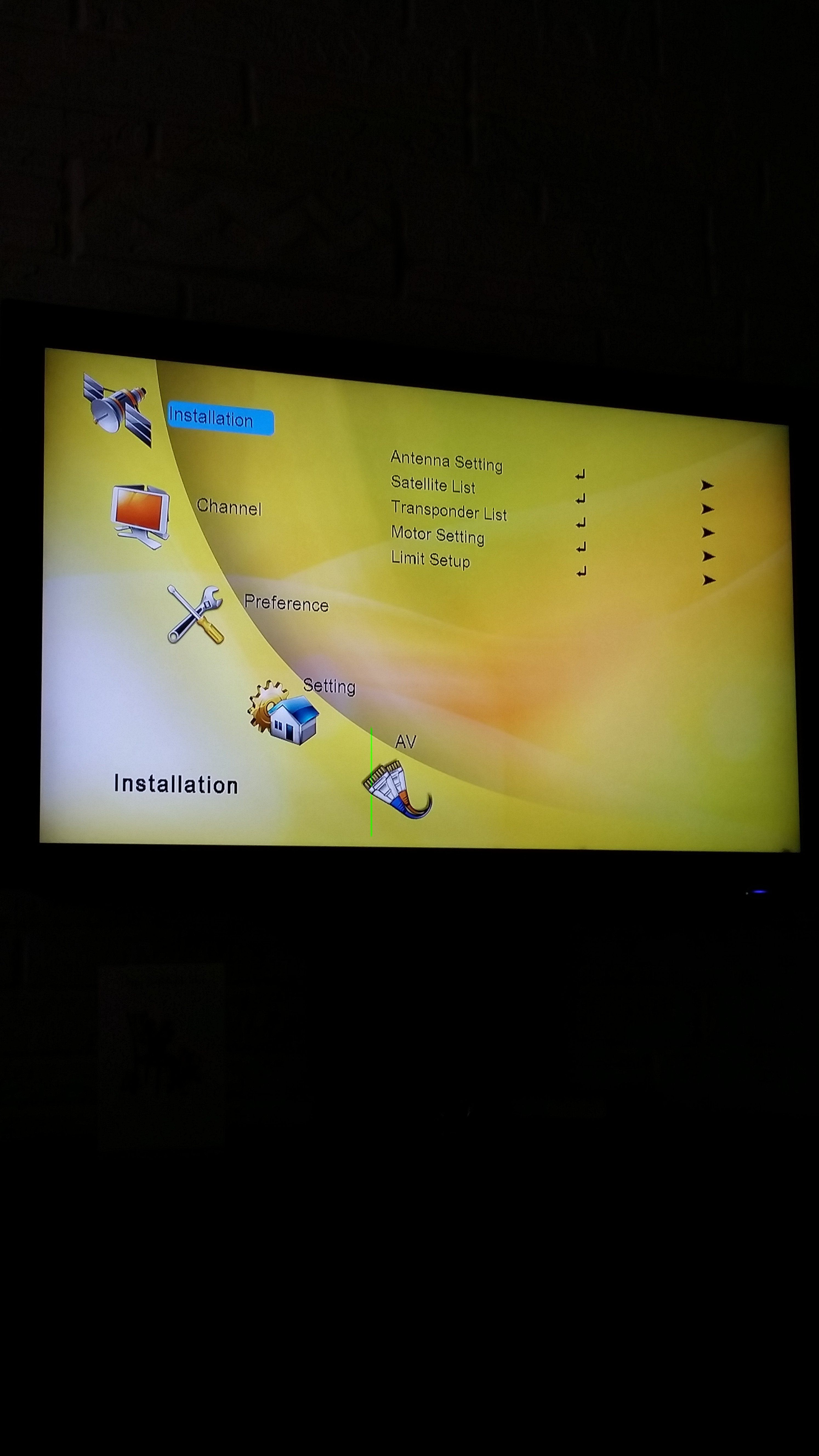

Kira, do you know if there is an on-line owners manual for those receivers.
Ok, gotcha there. Now what
Likely in another menu screen. Many receivers allow the user to add a transponder in the transponder or TP scanning screen. Usually the user cannot add a transponder in the main install screen.
Is the dealer where you purchased the receiver not available for technical support?
The dealer is in the middle east and I'm in florida. This set up was a gift
You will need to figure out how to enter the transponder parameters that I provided. Without a TP entered, the satellite cannot be located.
Snoop around other menus or even try highlighting the transponder line and pressing OK to see if another window opens that will allow manual transponder entry. Maybe the steps for manually adding a TP is in the manual?
See if there is a way to add a new one in the transponder list menu item.
