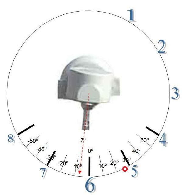

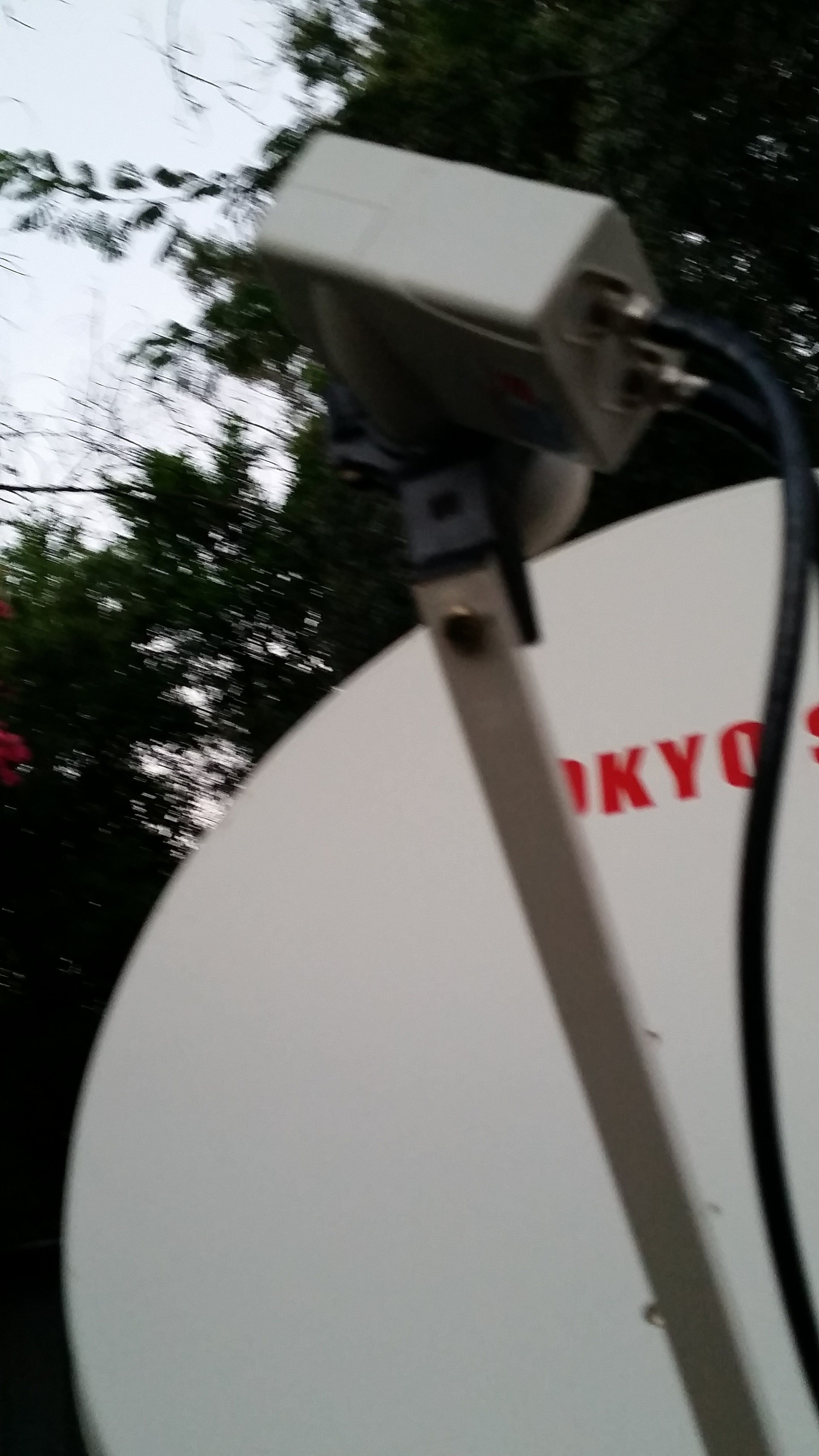

+25.1 degrees of skew should put the coax connectors on the LNBF at about the position of the red O on the diagram, unless the LNBF is marked otherwise.
Unless that LNBF is designed different, it should be "0" with the coax inputs at the very bottom.

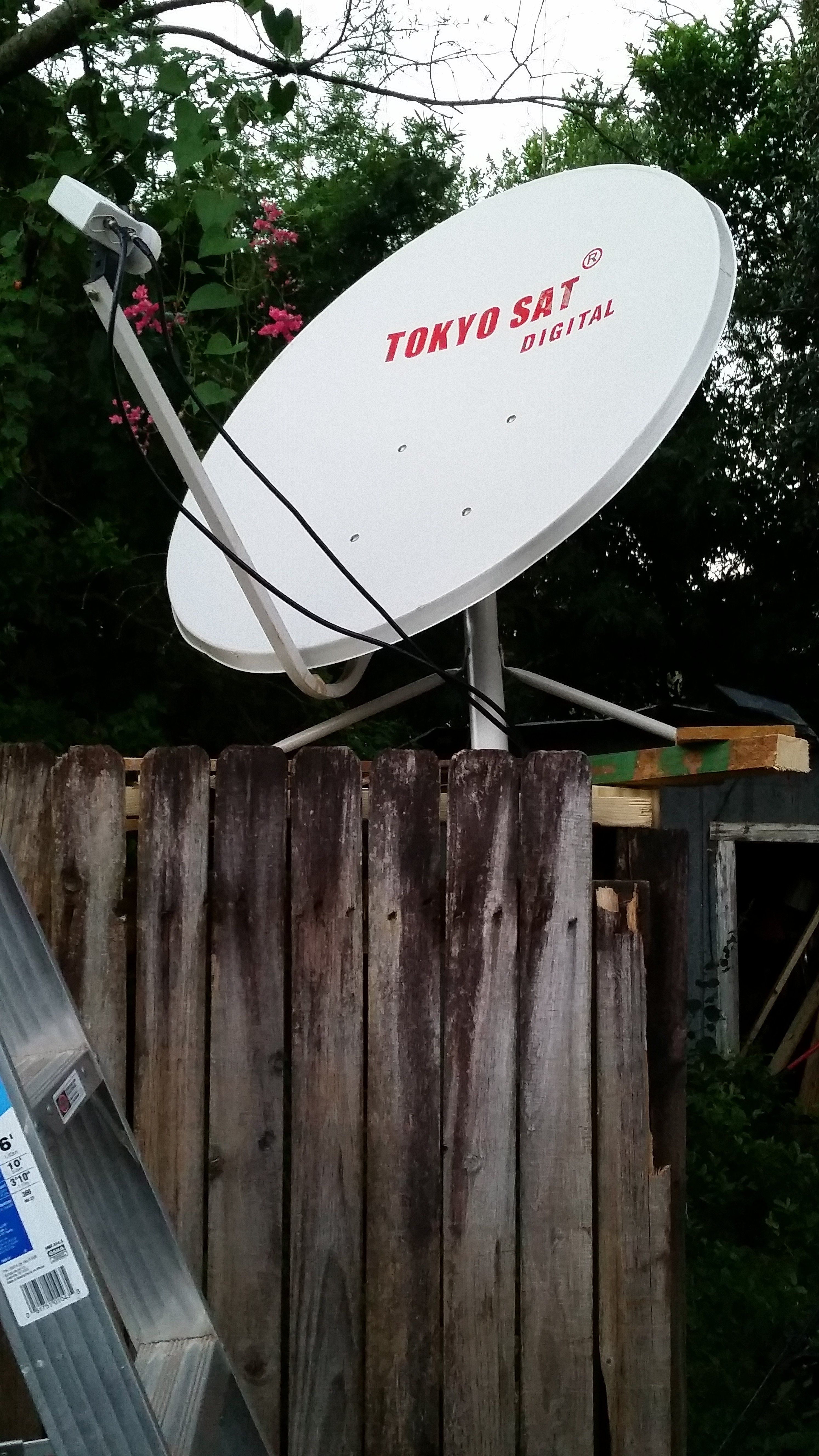

One more thing I noticed, I don't see a TV outside near the dishes.
How will you be able to see the signal bars on the TV when you adjust the dish?
Hahaha yeah I can't, I move it and run inside over and over, alllllll day I been doing this... since yesterday :(
Much easier to:
Bring the tv to the dish.
Hook the LNBF directly to the receiver. (You may see signal then, if you do then this will show that you may have an issue with the existing wiring from the dish to the receiver in the house)
No switches or splitters anywhere in the line?
I have a tiny tiny TV a friend was getting ready to throw out. I love that thing for aiming out at the dish.
Its near impossible to aim for me without the TV at the dish. On a good day I can get aimed in about 5 minutes, then another 10 minutes of fine tuning, done.
Bring the Big tv to the dish, aim, then enjoy beverages outside while you watch the new channels!:clapping
