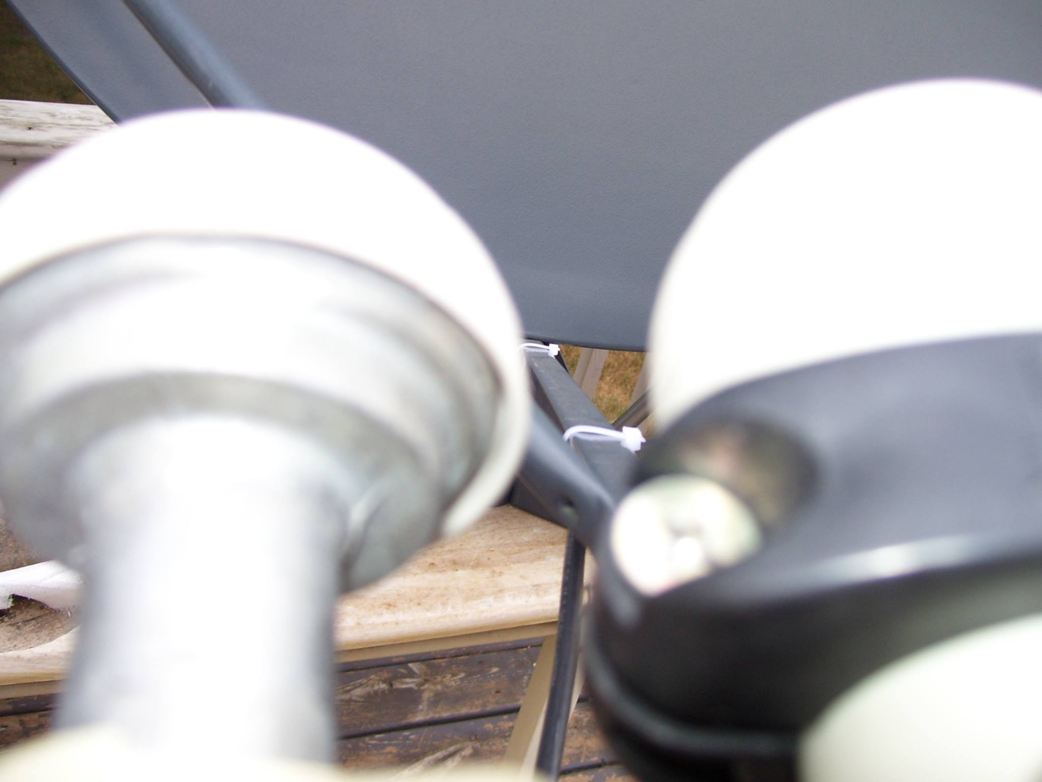

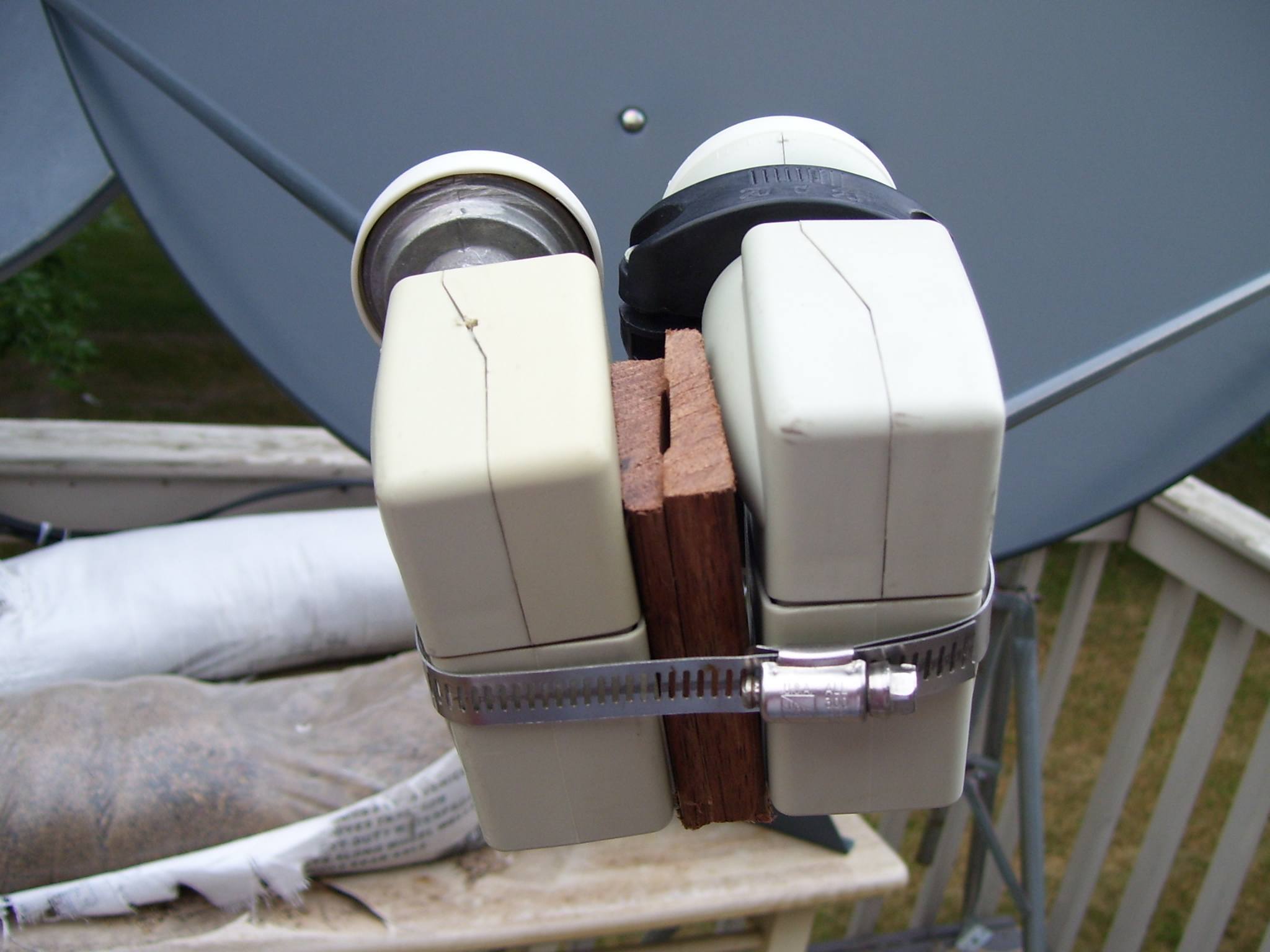

Here is a old pic of when I had 2 LNB's aimed 3.8 degrees apart (107.3 & 111.1 for Shaw Direct sub) on the 1.2 meter dish. Now the LNB head is pretty big there but if you got a newer LNB that isnt so wide it would probably work

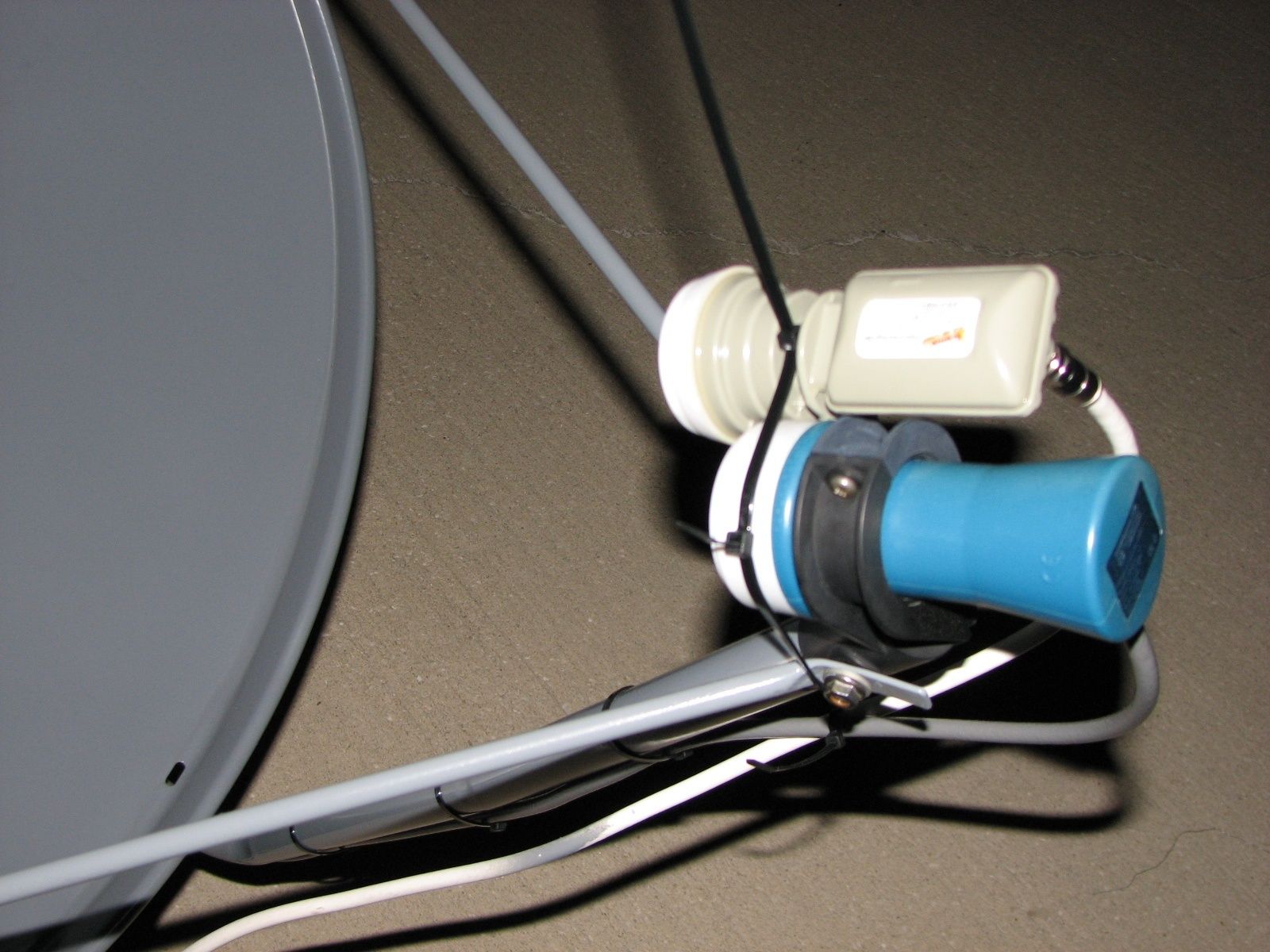

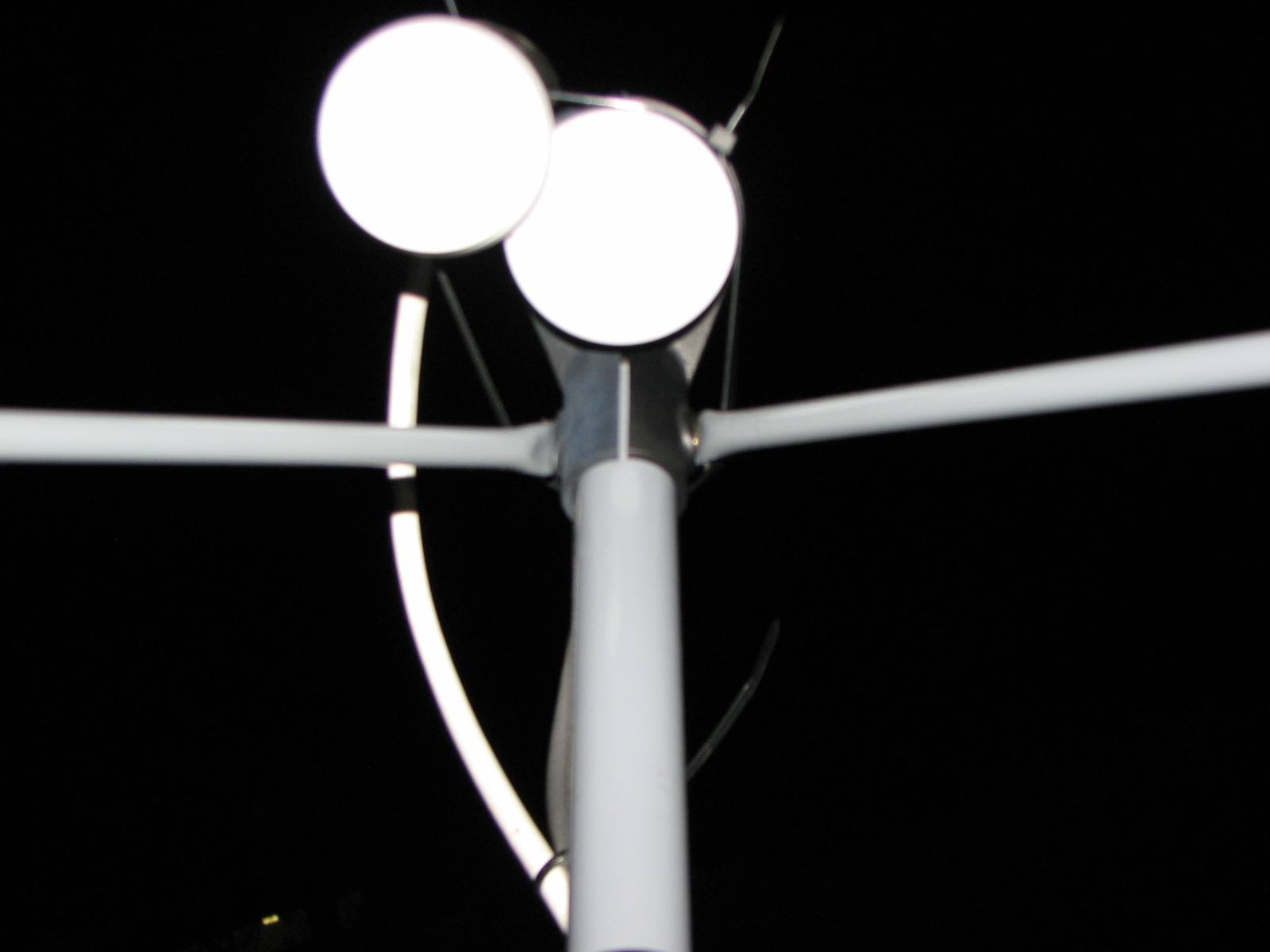

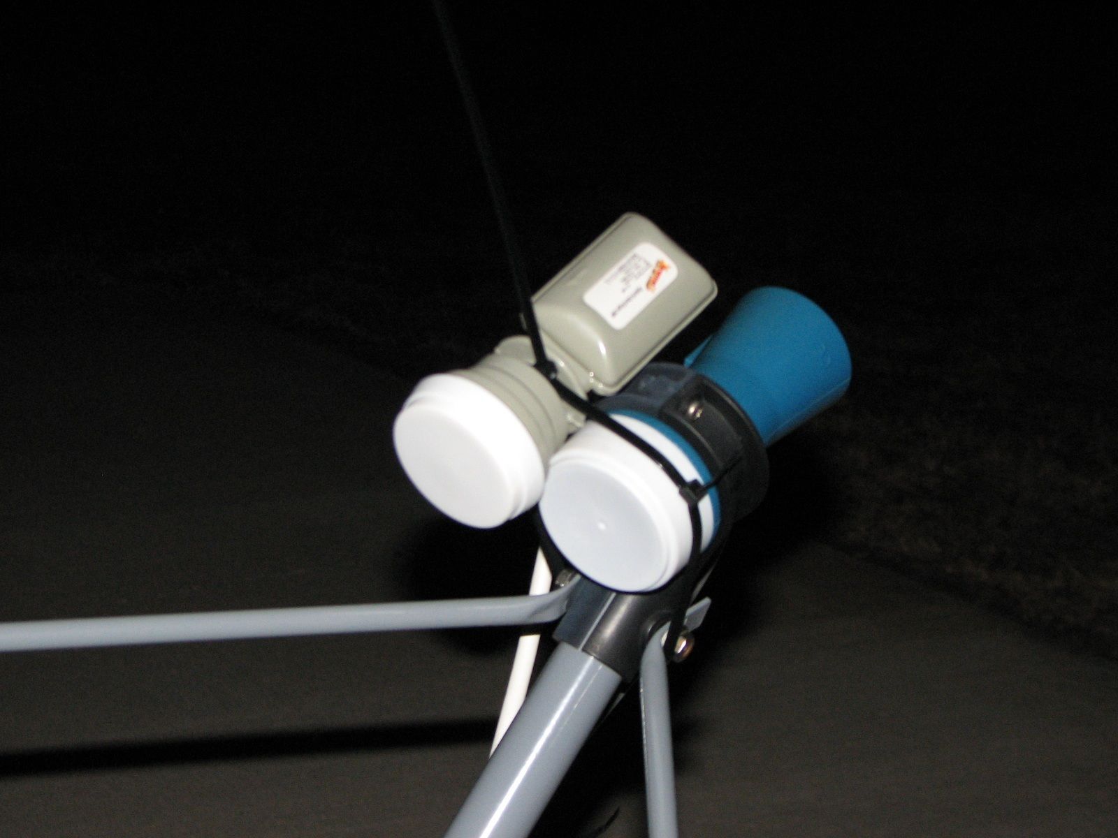

Wescopc took two GEOSATpro bullet LNBFs and used a belt sander to grind down the housing and scalar to receive 2 degree separation satellites. Can be done with modifications!

Hi, I did a 2-degree experiment once, and it worked for me. BJU dish, pointed at 97w, receiving both 97w and 99w. 99w quality was 45-55, if I remember correctly. I think quality would have been better if I had those small bullet lnbfs.
If you just want CCTV off of 95w then I think it can be done since it is so strong. I would leave the LNB for 97w in its regular spot and tuned in as best as possible. Then I would take a cheap LNB, hold it near the 97w LNB and using the receiver or a basic meter find the best 95w signal. As stated previously parts of the LNB scalar rings would overlap so you are going to need to grind off a section of them on the 95w LNB. As long as you don't grind into the feedhorn itself it should still work pretty good.
