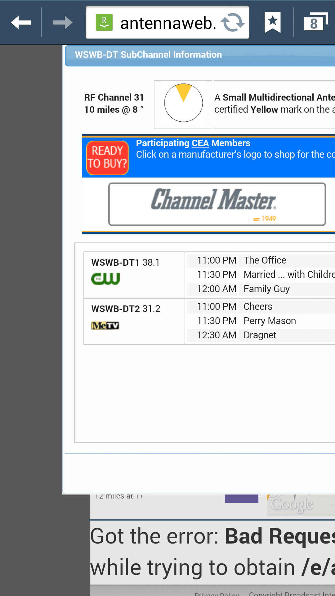

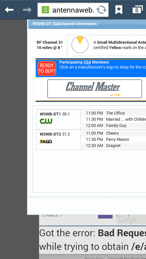

So not that I doubt this works since I did it and can clearly see that it works.... but... 38.2 is actually 31.2 here locally but still rf31. Screenshot attached. Where exactly does the 38.2 come from. (Just trying to understand)

I went by the info on Rabbitears.info website. That site states WSWB being broadcast on 38.2 RF31 for WB/S.
