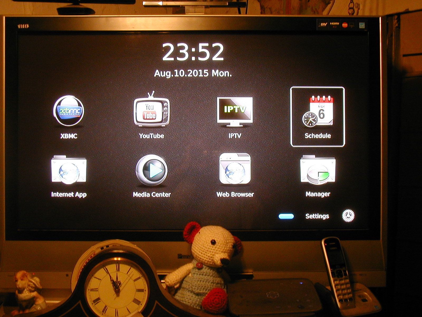

That's odd, I don't have it in the menu anymore:
XBMC, YouTube, IPTV, Schedule, Internet App, Media Center, Web Browser and Manager. If I remember right, it was somewhere on the right side.

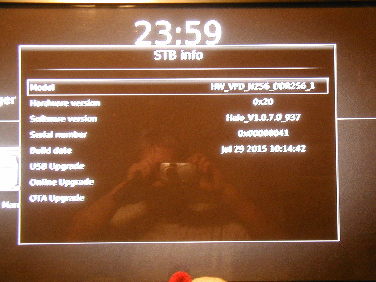

Crappy picture and you can see my ugly mug reflected on the TV, but you can make out the firmware version, I hope! :)
Hmmmm, I don't have schedule on mine. That space is where I have iTBN but I do have 937 because it shows in the STB info as 937, I do have the MUTE capability via the GOTO button, and I can record both manually and timer. I was at 898 and I put the 937 on a flash drive, I upgraded via USB, but I did not do any Factory Default restore when I upgraded. It worked so I just flashed the new upgrade and that was all that I did.
I have the mute capability with the GOTO button and can record manually too, I haven't tried recording with a timer yet. I upgraded via USB too, I don't think I did a Factory Default restore either at that time. I did backup user info before flashing 937 and restored it after. Before the 937 firmware, I had the 935 firmware installed.

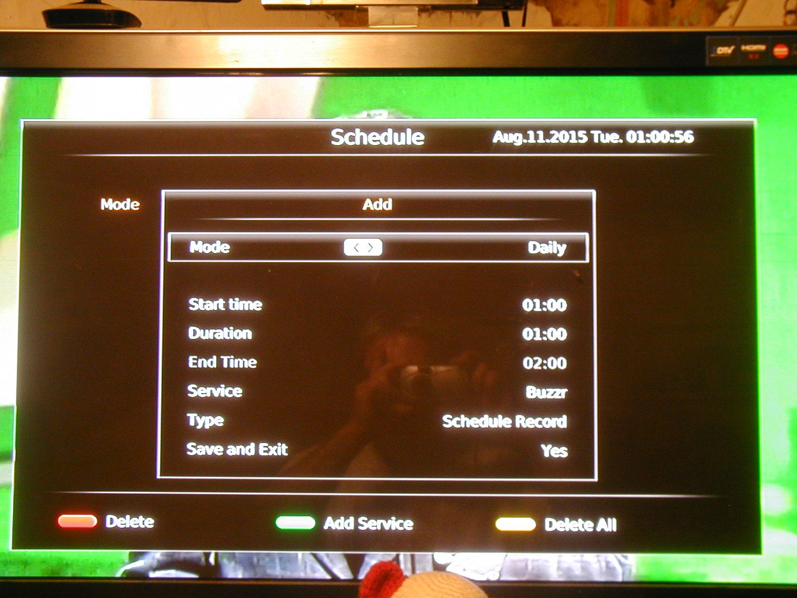

The schedule icon looks to be for recording, I'll have to give it a try:
