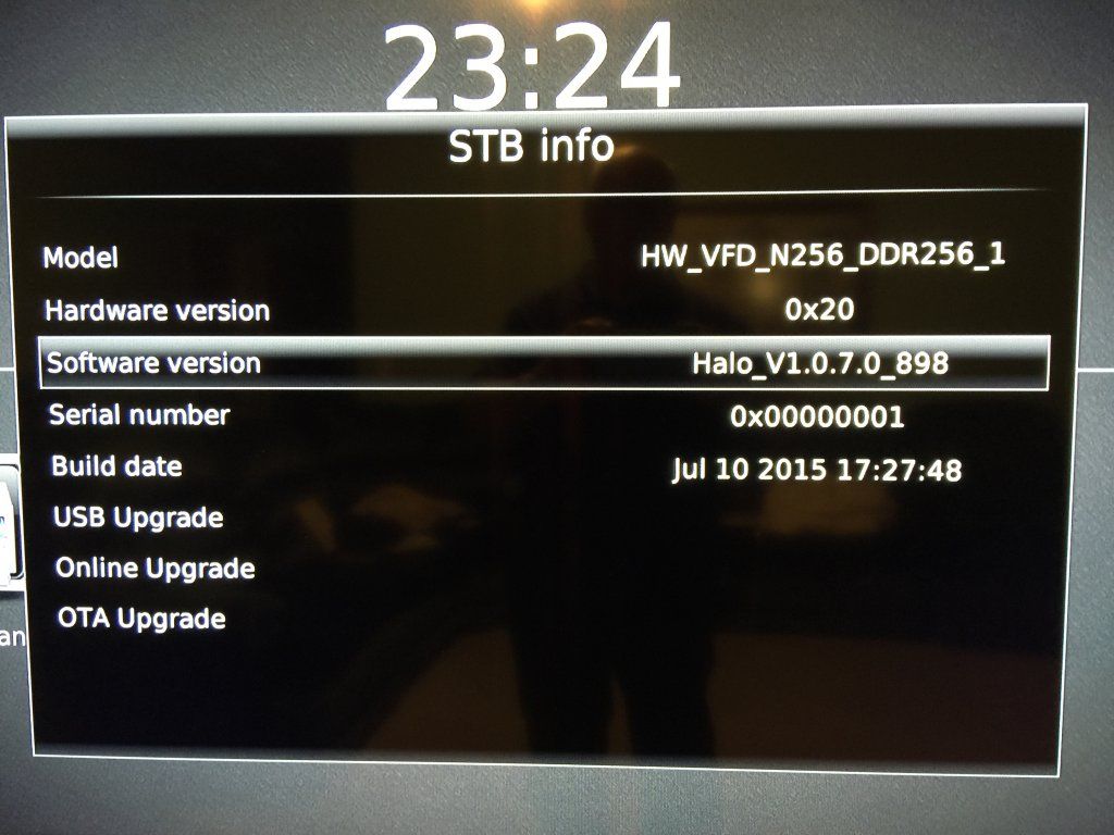

I've been able to successfully install dishes with 1200, etc. receivers for some time. (about 50 total: did one today) I've had support from many on here. Thanks. This is a mission for me to allow folks to see G19 and a hobby to learn new things. This receiver (3500) is my current 'new thing' experiment. Aaron sold it to me being open to the fact that it was still in progress. I went up to Conyers about 6 weeks ago to install a system and was surprised to see the user had paid a little premium to get this receiver. I turned it on and was totally lost. It showed channels and he was fine to dial the channels he wanted. I haven't heard from him since.
I got mine and plugged it in and found the same. It has been in the box for a little while. I am in no way ready to understand all the things Brian has been talking about on here, but would like to be able to do the things I dan do with a 1200 as well as do IP streaming by ethernet to this receiver.
So, from reading, I think I could update the firmware by internet. If someone could give me a recipe for updating it, please do.
Thanks, Bill

Bill, please call me at the office, I will walk you through.
888-483-4673 my extension is 8203

Do you have to receive ku-band to be able to get the satellite update? I am C-band only and from what I remember reading it was sent via a ku band satellite.
The online update is available for everybody, the automatic Glorystar online update will be released as the new public versions become available.
The FTA software is available on demand. I should make version 1045 available tomorrow on the FTA side.
The satellite update is only available on Galaxy 19 97w and will be available on Optus D2 152E Ku.
The 1045 Firmware has been enabled in the FTA firmware if you are connected to the internet. Please go to Menu > Manager > Version > Online Update and you will find the 1045 in the Firmware dropdown.
Let me know if you have trouble doing so.

I got 992 for a download - what am I doing wrong?

I was able to upgrade to 1045. Thanx.
