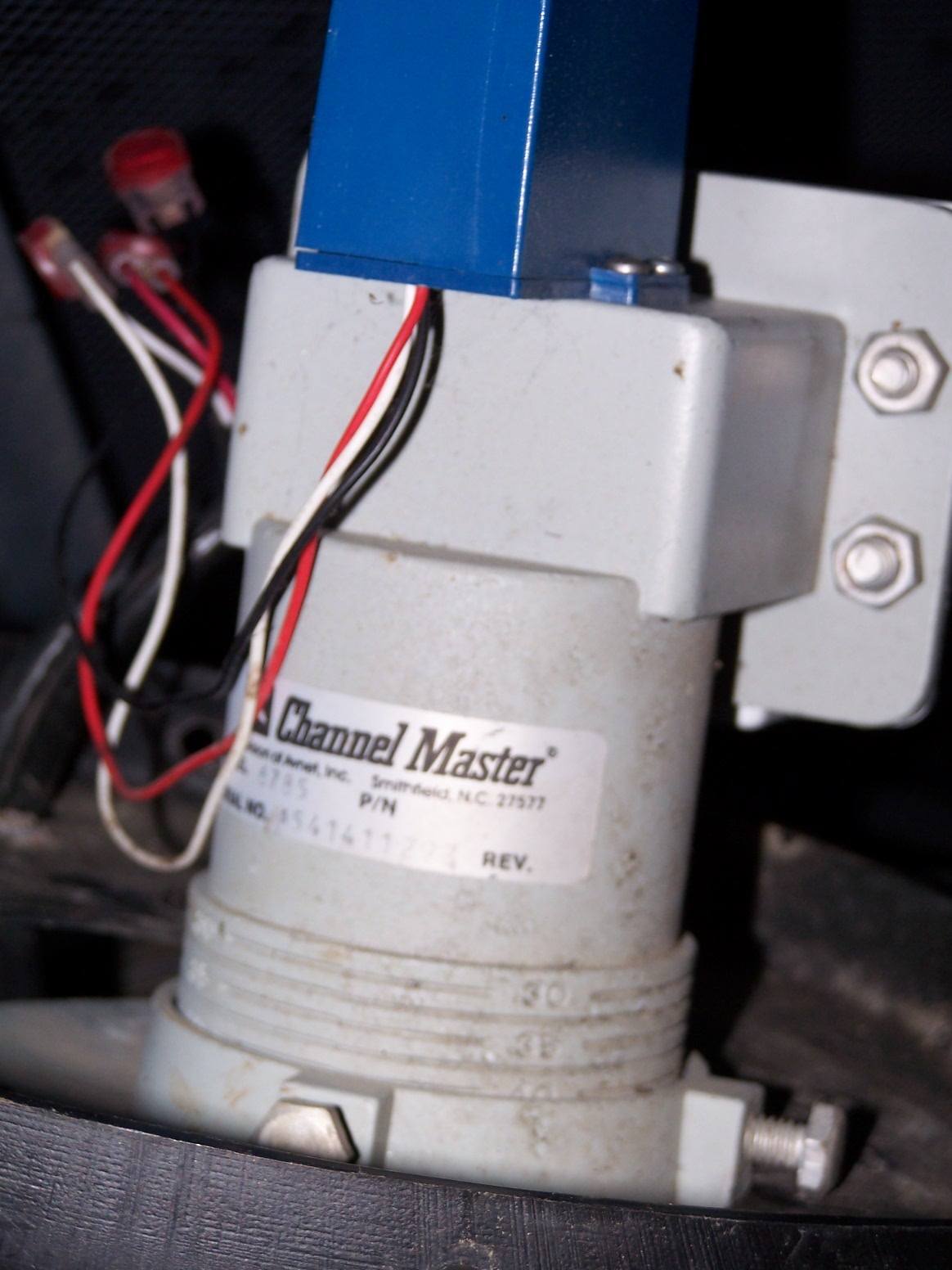

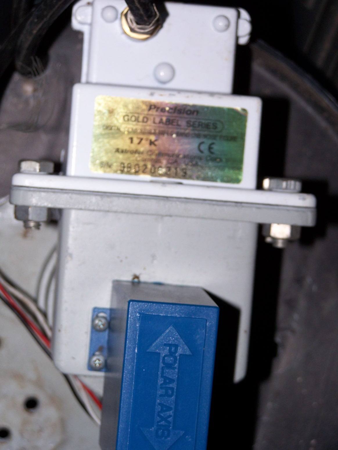

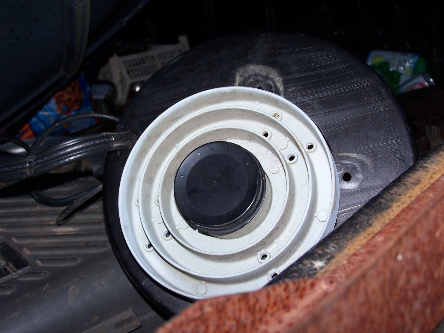

Well we got the dish home,on top of my Volvo wagon.My car is now known as the Swedish turtle!I'm posting pics of the feed horn.I also most likely messed up the alignment but My husband did do a compass reading before we started.we are going back Tuesday to cut the pipe the guy that installed the system was a real pro,all the hardware is zinc coated so it came apart very well.I also got about 50' of ribbon cable as of right now the feed and motor are still hooked to the cable so I can note what goes where.To answer the off grid questions,we have a 7000 watt powerboss generator with a honda engine and a lincoln welder/generator,we have 2 120 watt solar panel not up yet!and 4 6volt solar batteries and a maxx inverter.To any one thinking of getting a generator don't waste time just get a Honda or at least a honda engine.:)

That's a Channel Master C-Band feedhorn assembly. The LNB is a made by Precision and is rated at 17k. I don't know much about Precision LNB's, but the 17k makes me think it's OK. The blue piece is a servo motor/polarotor, it's what changes the polarity from V to H or H to V. The DVB Receiver you said you were bidding for, will not work the Servo Motor, or drive an Actuator. But, you can get a V-Box to drive the Actuator, and if you can wait, Sadoun is coming out with a new model (newer version) of a G-Box2, that will drive an Actuator and control the Polarity from a servo motor. There are a lot of us waiting for this model. I think it's supposed to be on the market in October?
You could also get a different type LNB, an LNBF like the BSC621 or the C/K1. They will do C-Band and Ku-Band, with voltage switching, and the Receiver you bid on would work with both of them for changing Polarity. Good Luck!

Now Kzinbastet on all my dishes I use that channel master scalar ring with the 3 1/4 bolts that holds the feed, to center the feed throat in all my dishes here, an that was 1 of Channel Master great designs that they had. an if you need a comparison of signal quality from the 621 to the ortho, can give them to you, would not be fair to compare with the Co-rotor due to the gain of the dish it is on. hope all helps you to make you're shopping list up, an all the best to you an you're family, an getting you're dish up an running.
