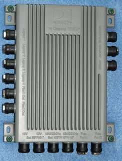

Does it look like this...or maybe they put it in a weatherproof box..

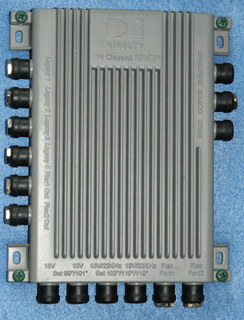

Sure looks like it. As I remember, it appeared mounted 90 degrees clockwise from your picture and I think all the top inputs were capped off. I could probably take and upload a picture but then you'd see how badly my house needs a paint job. :)
the fact that is outdoors is not an issue, the problem is the way it was mounted. With the left ports facing the water
