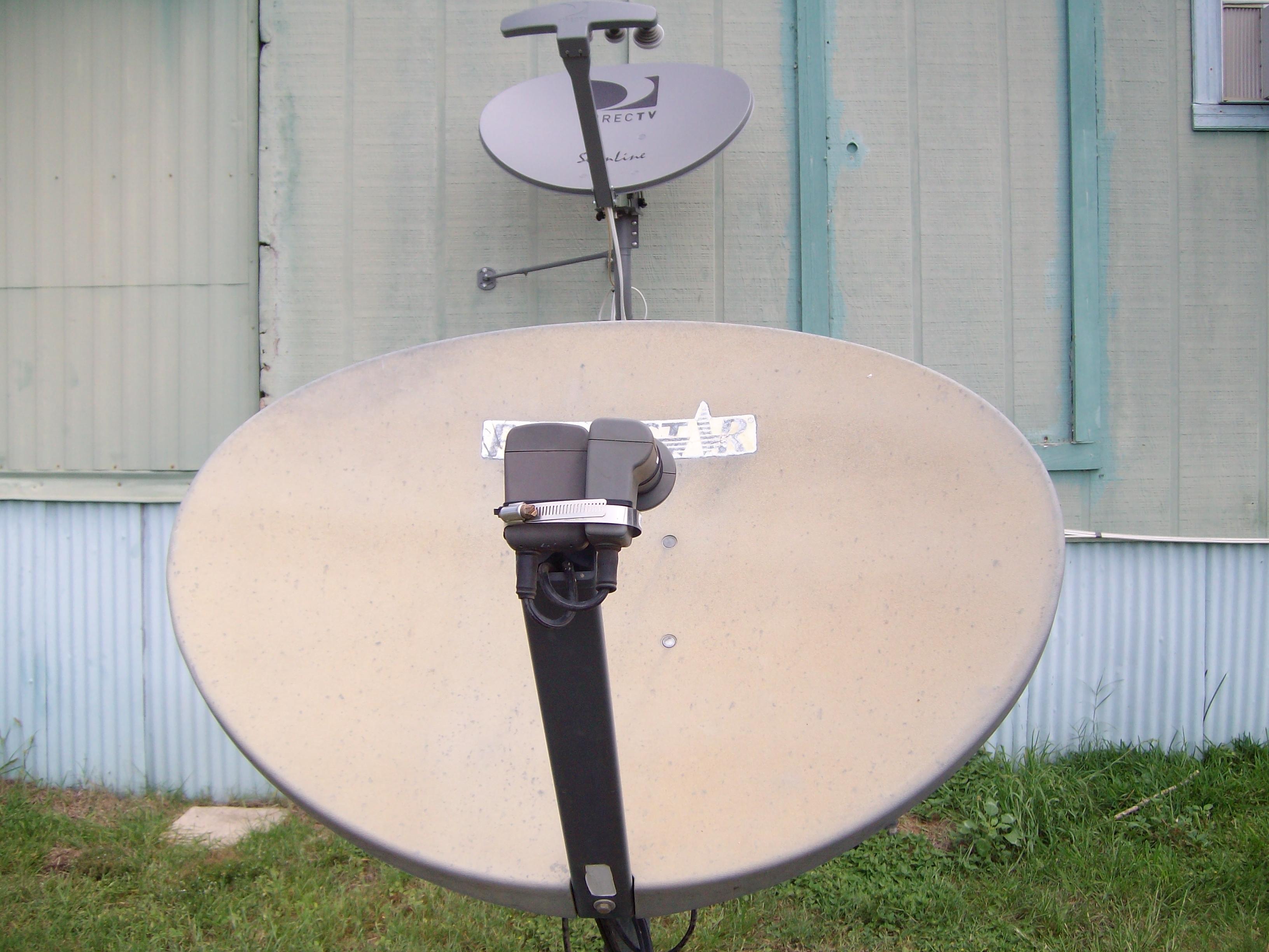

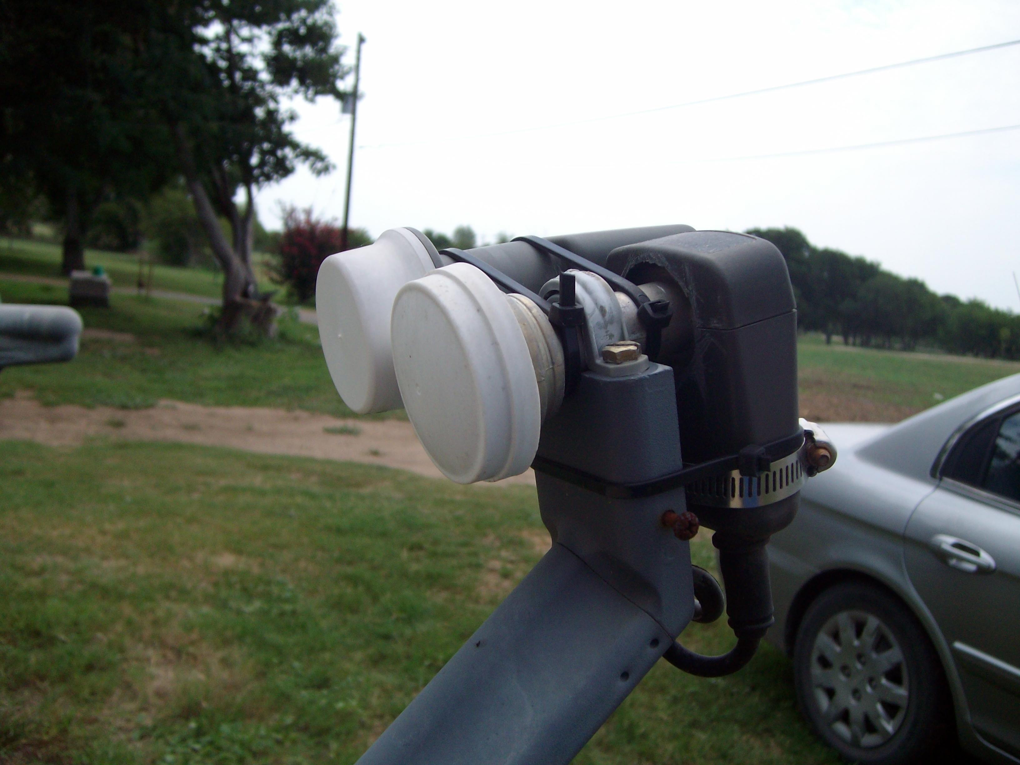

I'm using 2 of the Spitfire LNB's one of the LNB's has the plastic removed around the neck so it would fit into the slot on the Primestar arm. I have the dish peaked on 97w. I then connected the other LNB to my receiver tuned it to 3ABN and held it along side of the 97w LNB moving slowly until I got 3ABN lock in and then strapped it to the other LNB with no space in between and added a switch and I had all the Glorystar Channels.

taelon721,
Here is my setup
