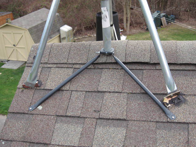

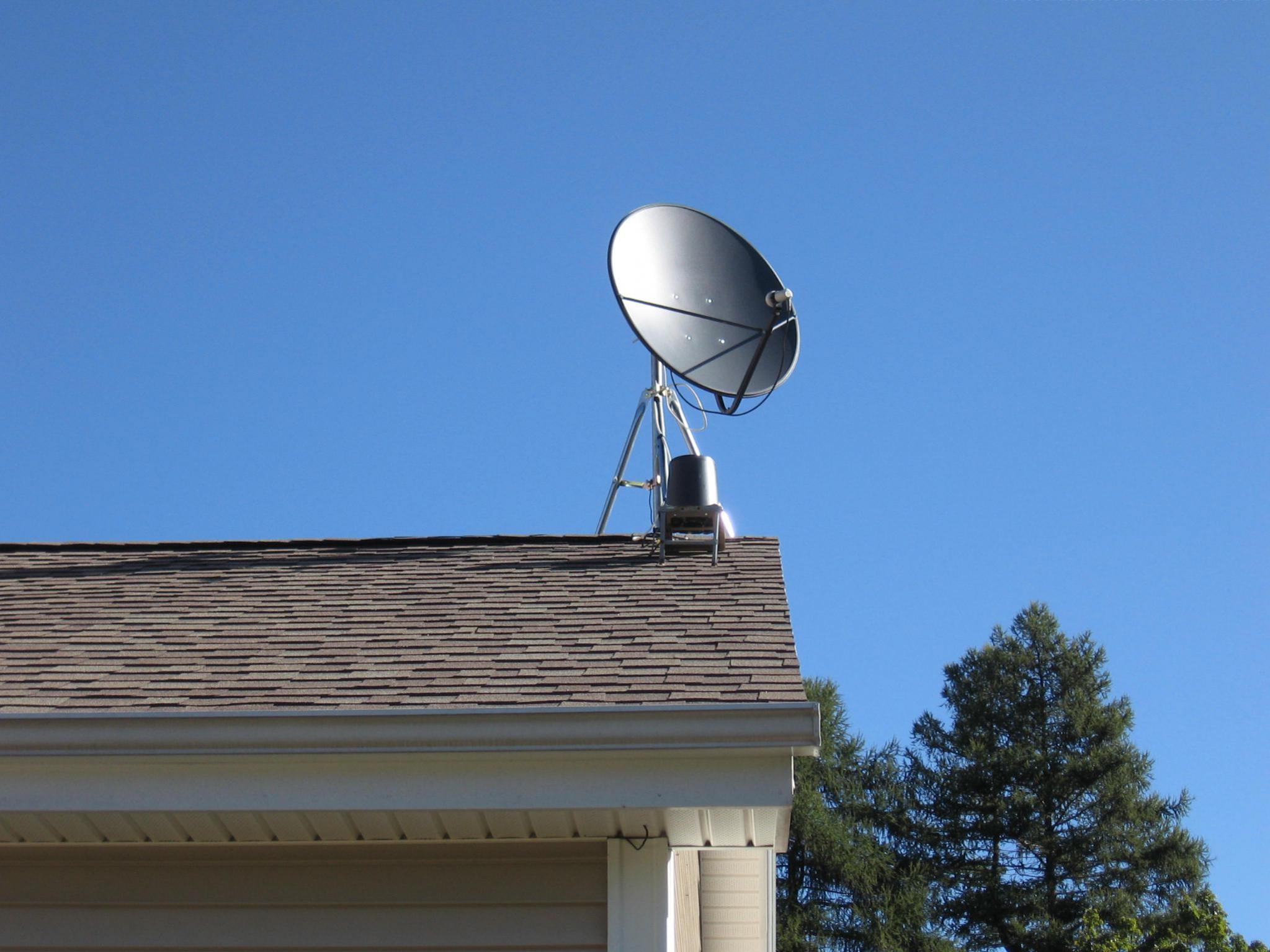

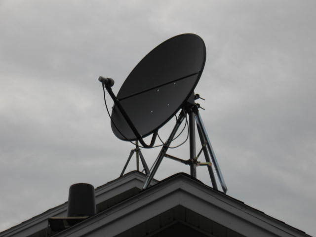

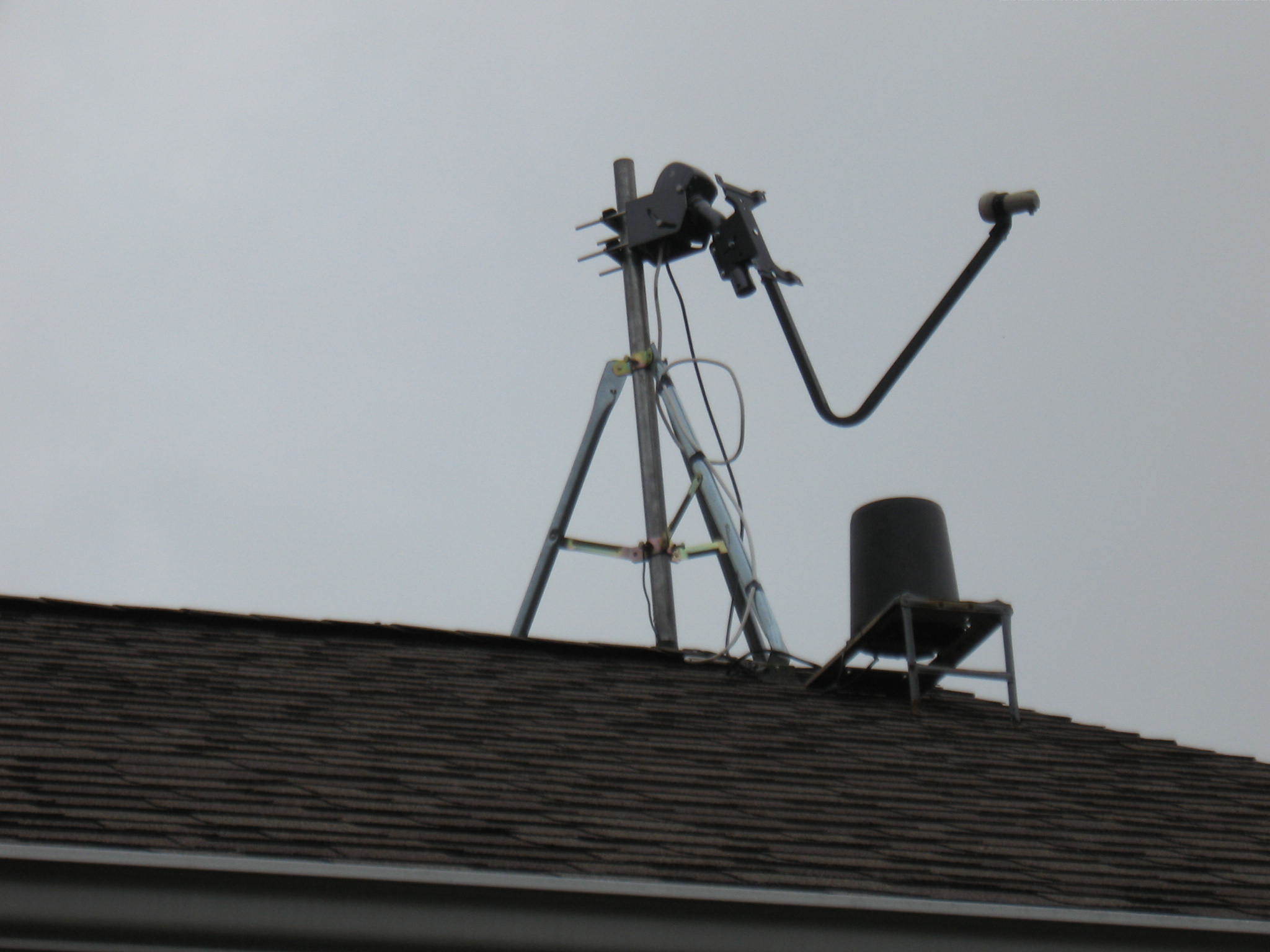

I bought my whole ku system from sadoun back 4 years ago!Still working fine.Heres a few pics of dish mounted on my garage roof.I used a 3 ft tripod which was alittle shakey untill i added extra support to the bottom of the mast.

For your first fixed dish system, and later when you add a motor, it will be much easier to have easy access to it.
It's much less frustrating if you don't have to pull out a ladder or stand on your head for alignment and tweaking.
FTA is not quite like aiming a TV antenna.
Even if your location would benefit from a roof install, get some experience mounting your dish waist or chest high.
Some members have mounted their dish to the back or side of the house.
You'll have to decide if that could work for you. :)
