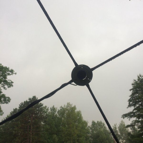

Well it's still raining and I kinda messed around with it and well I still got no go. From what I have found out is that my meter doesn't like to beam it in but my receiver does. What is even more odd that when the receiver gets a signal it only stays lock for only like 25 sec and drops and comes back and drops and comes back. I'm not sure what that's about.
Is the wind also wagging wet branches in front of the dish bore sight? If so, there you go. Though with most c-band signals, you should be able to keep a lock in quite a downpour, IF everything is tuned up right.

If you're taking the photos through the hole in the center of the dish, it seems like the feed horn is tilted a bit.
That was a problem I had. I finally used the inclinometer both horizontal and vertical on the scalar to make sure both angles matched the backplate angles. That is a bit hard to eyeball as it's entirely subjective but using the meter to get the angles to match worked just fine. Of course the OP's dish doesn't currently have a backplate on.....
Well guys I got it working and the skew was off well a lot [emoji50]. I'm not getting all but most transponders now. I guess some r more tricky then others. And yes the lnb wasn't sitting in straight so fix that and is well now
