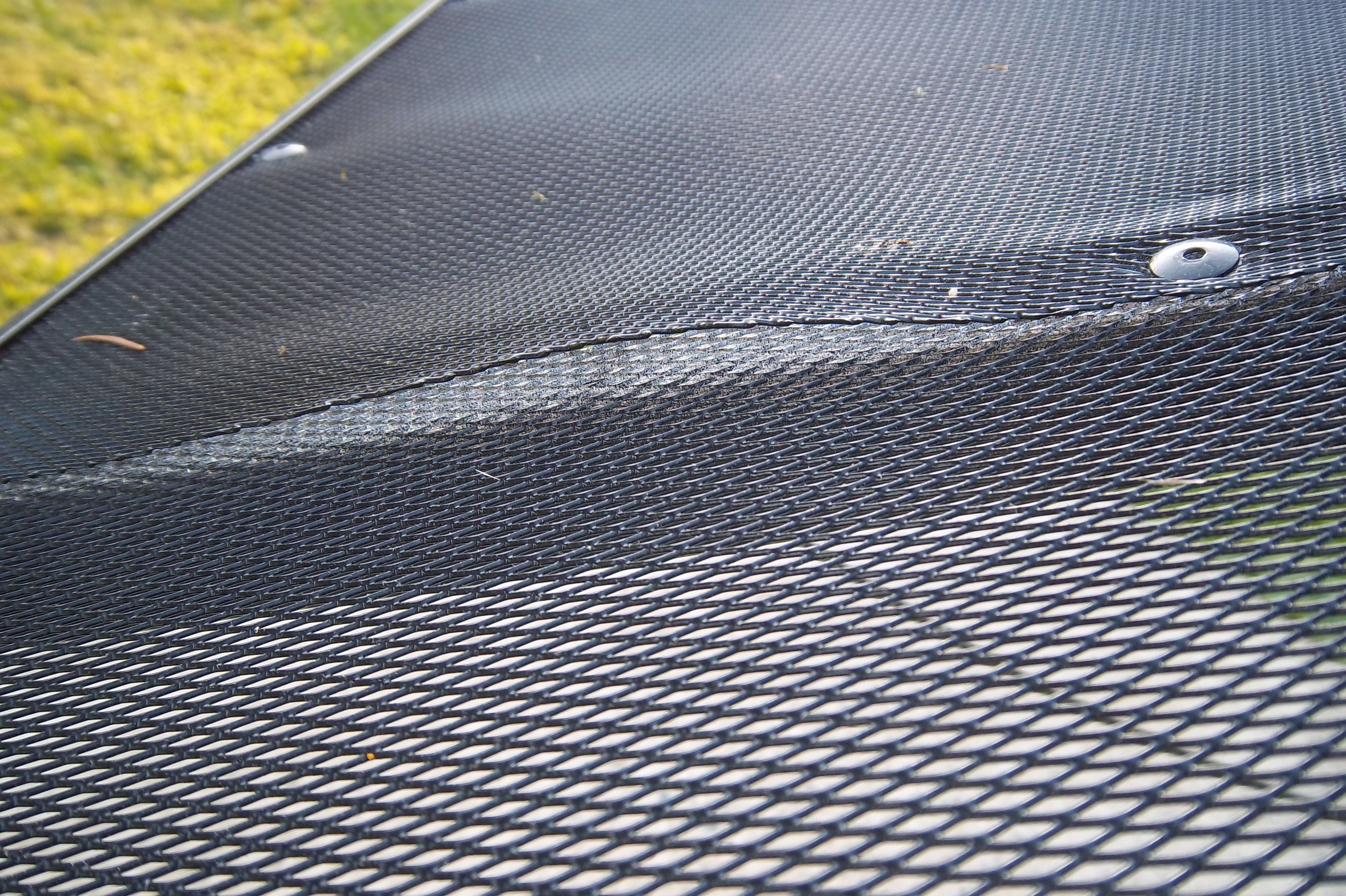

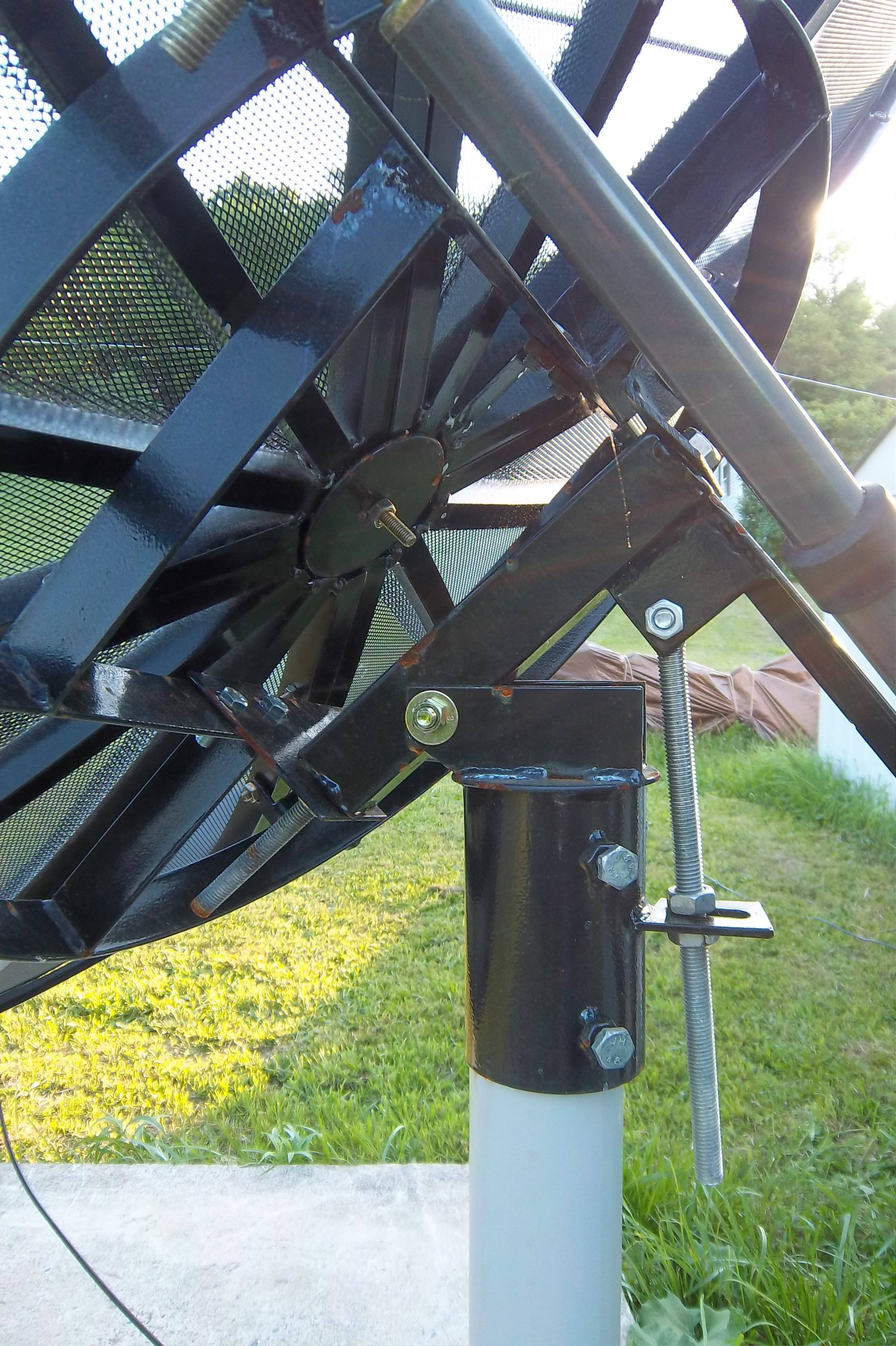

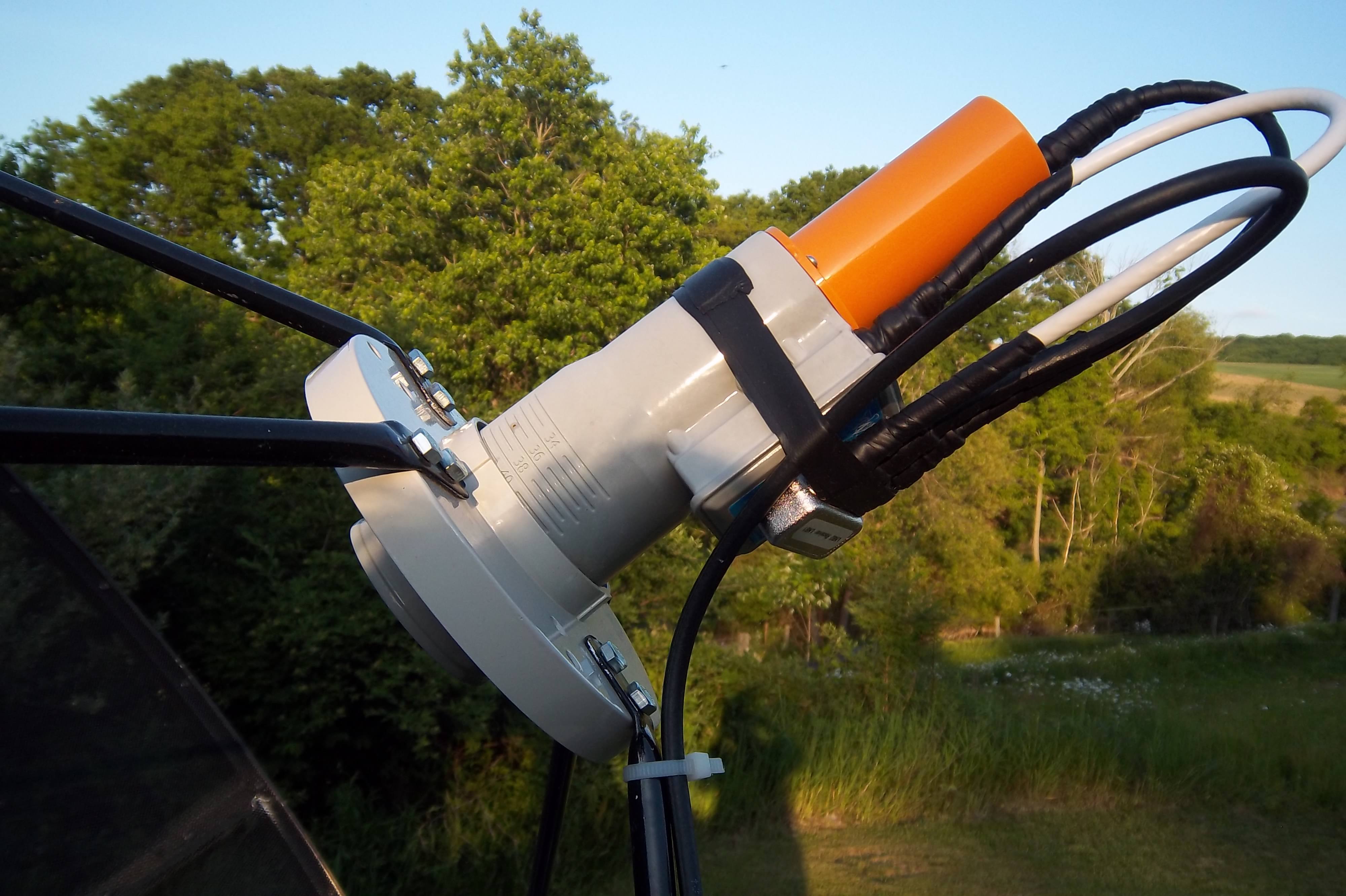

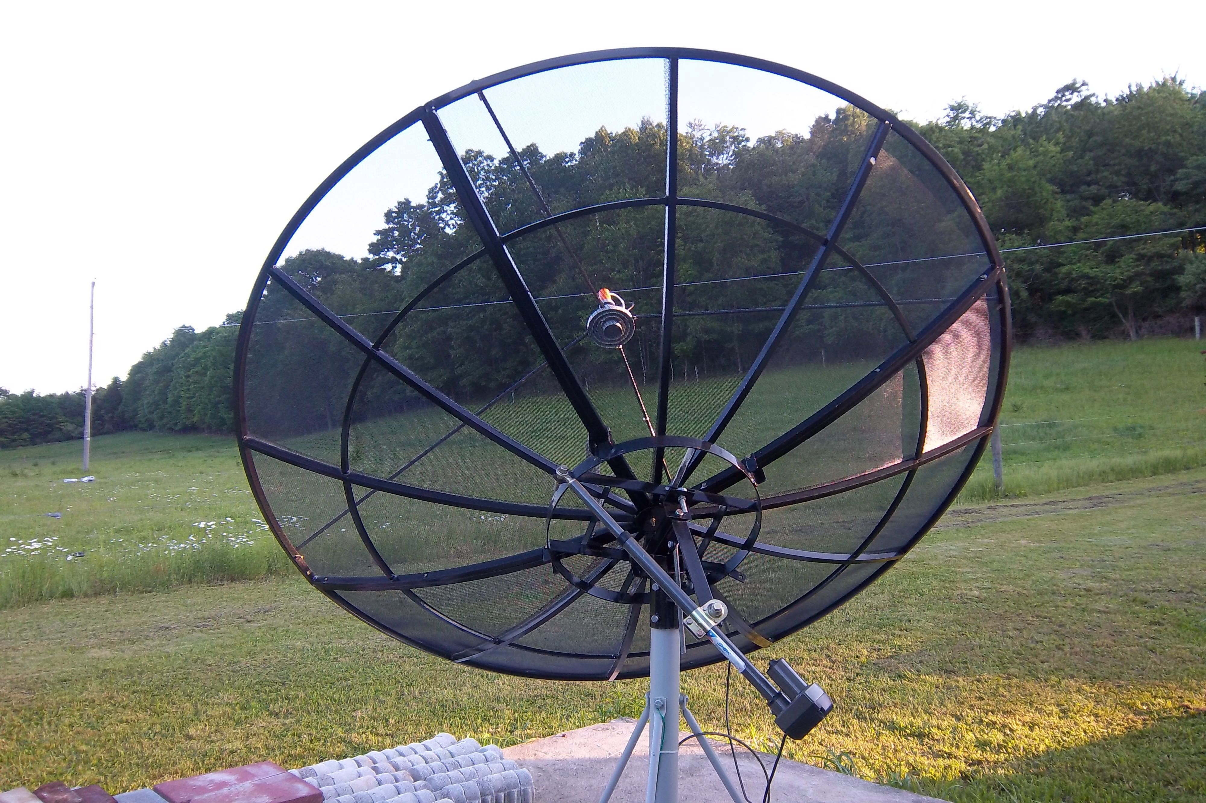

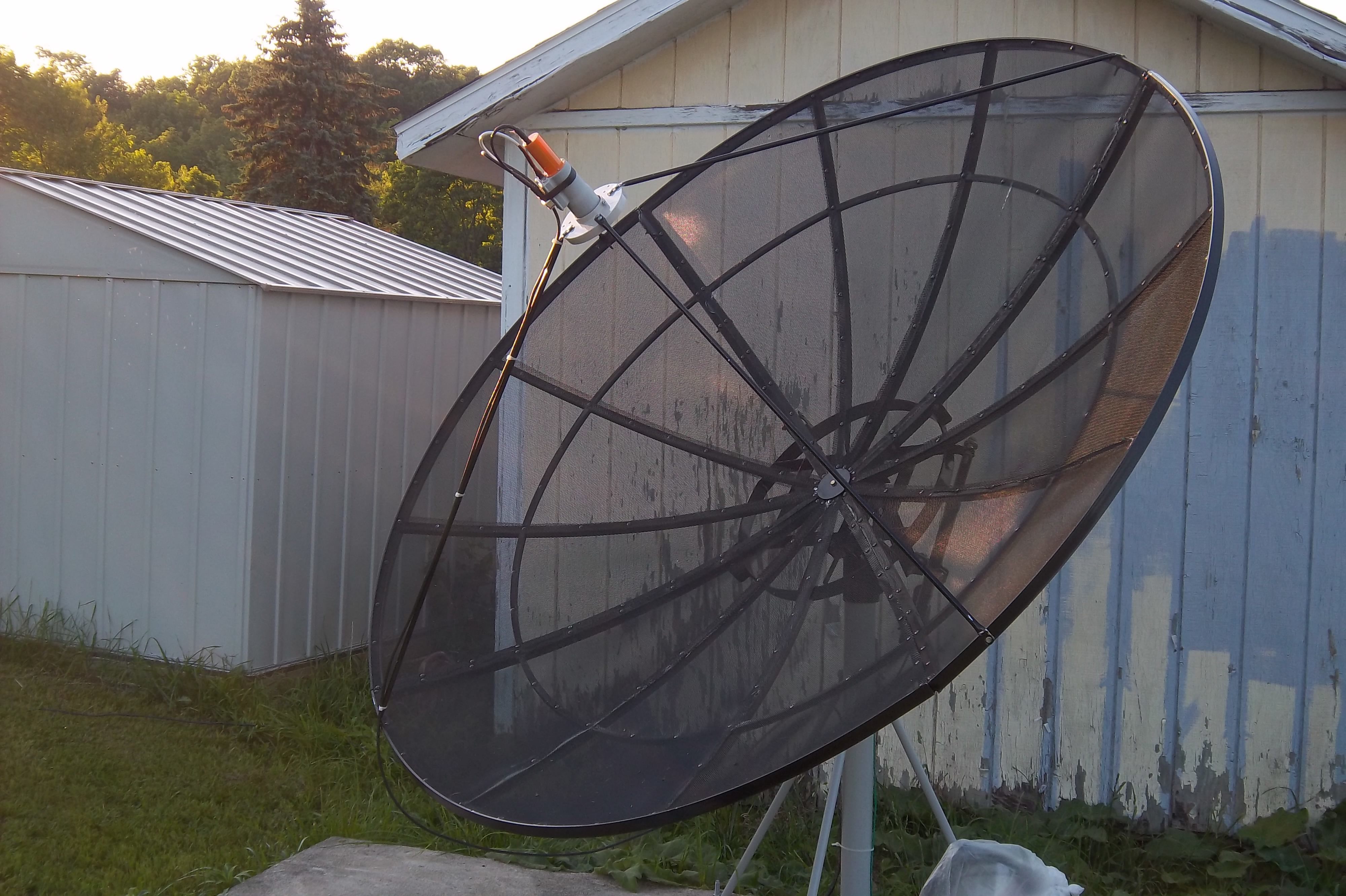

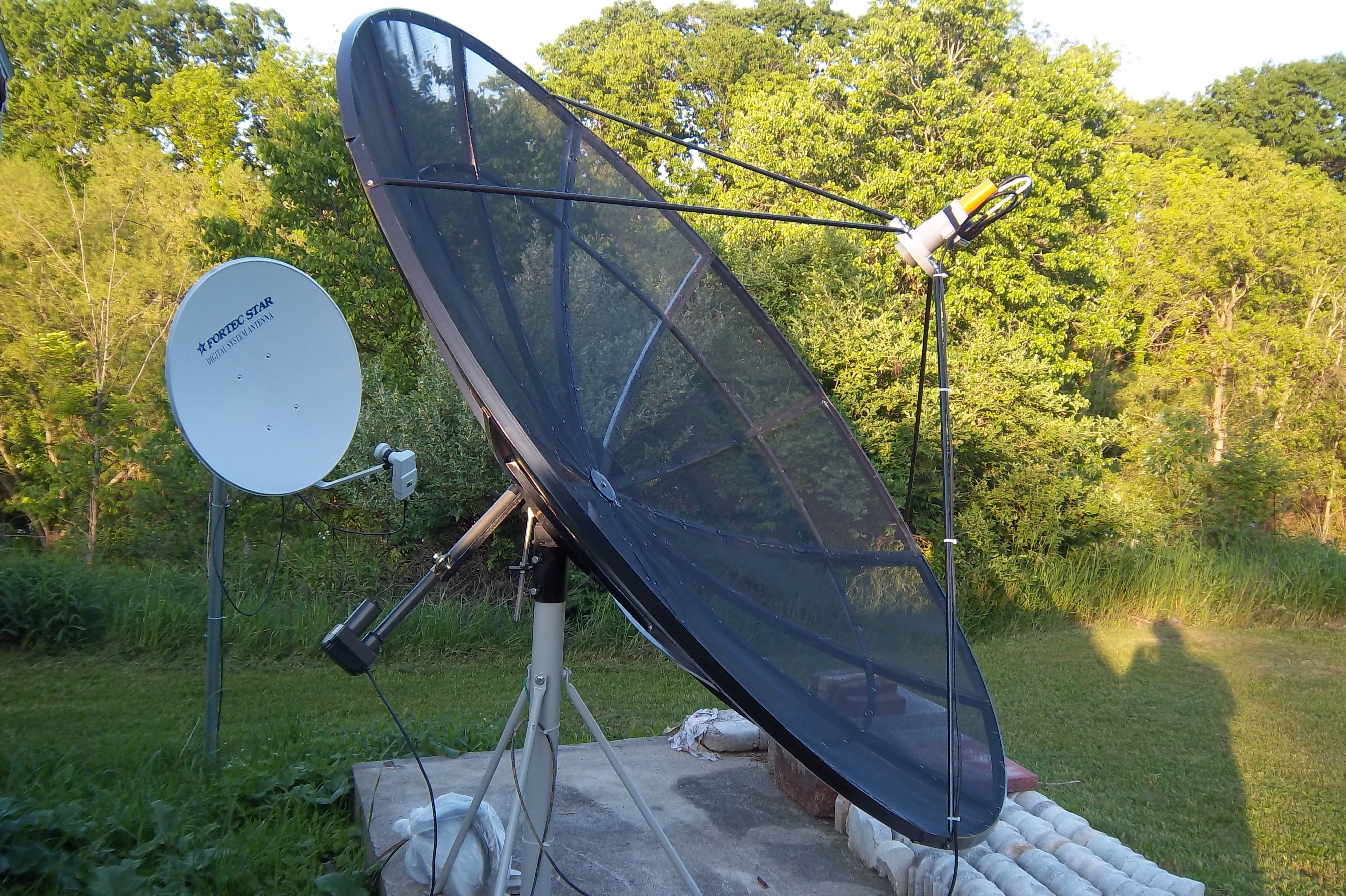

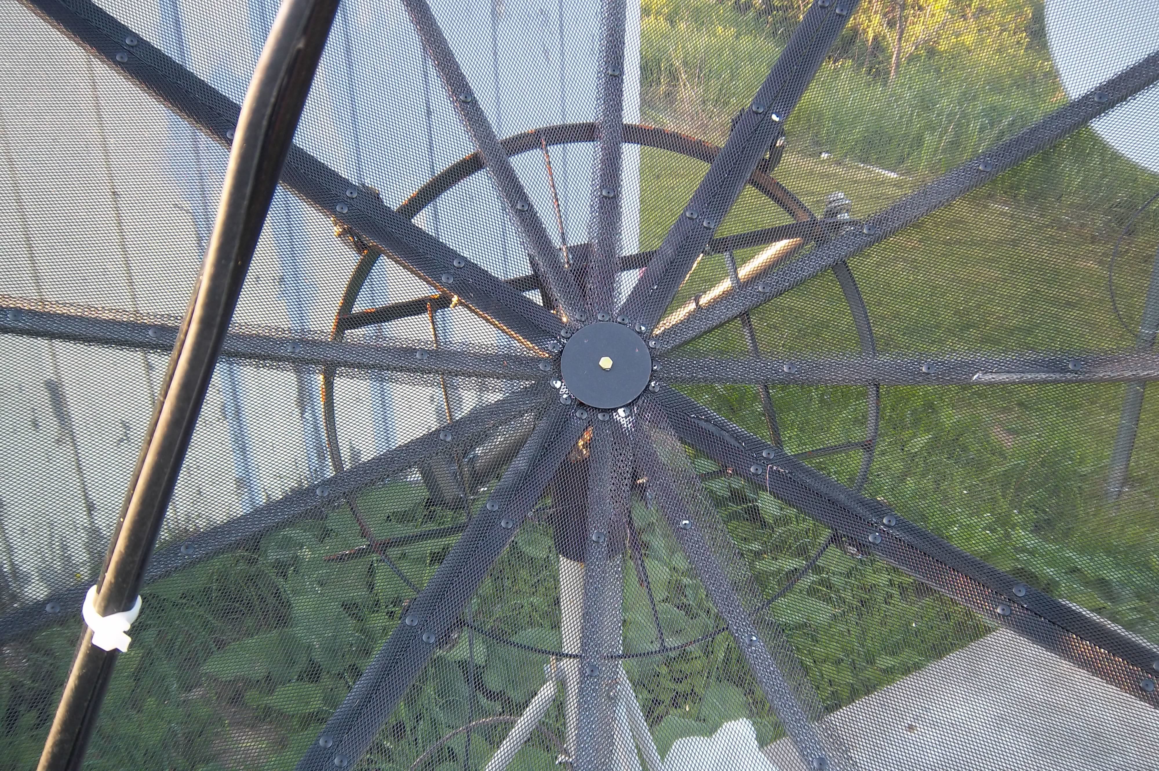

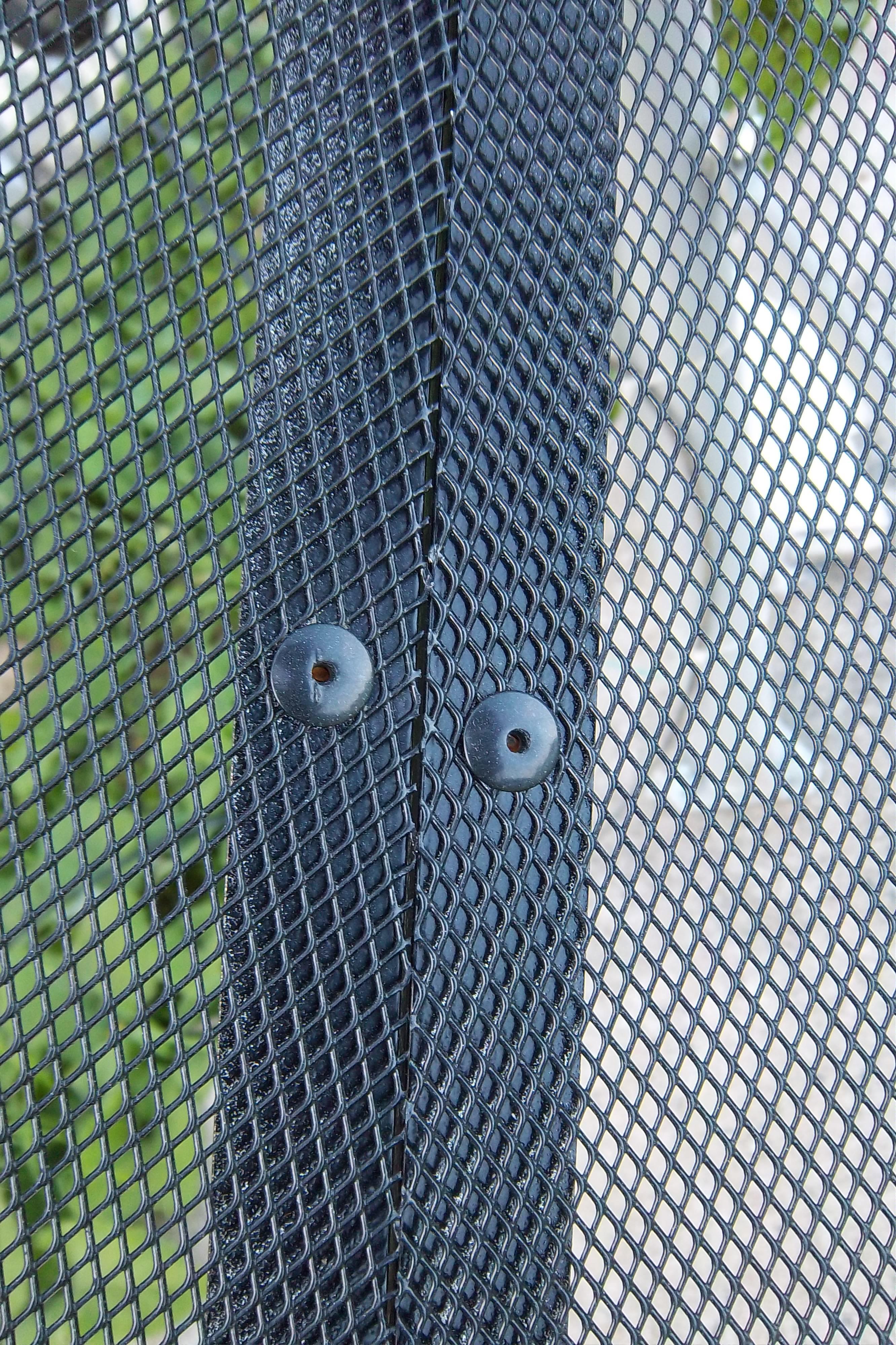

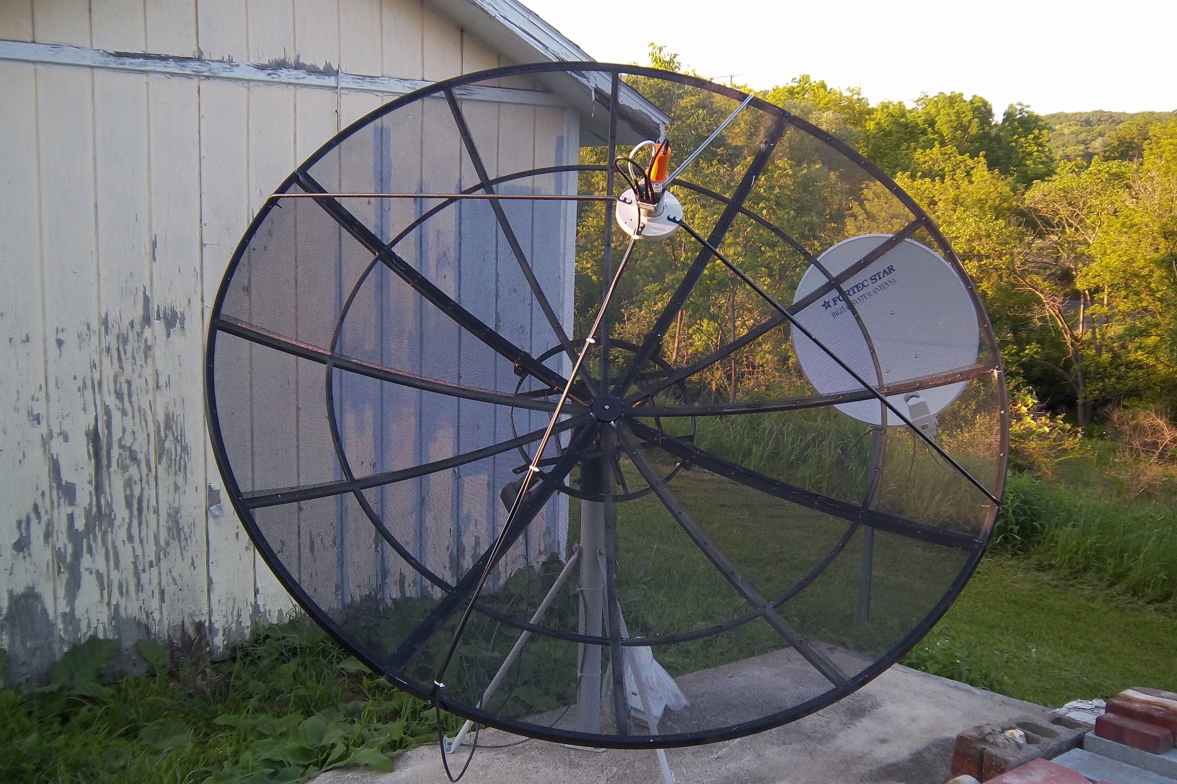

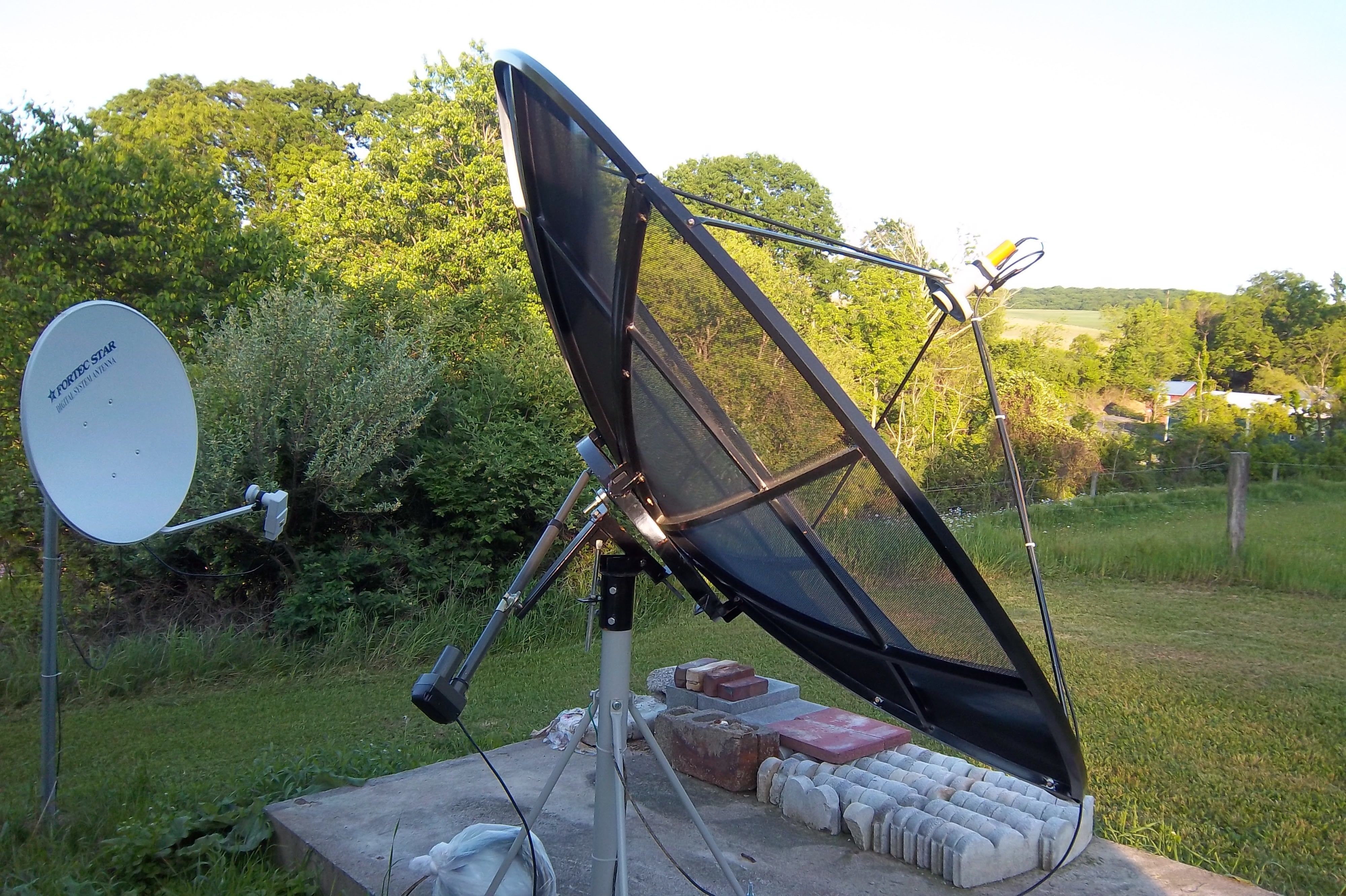

Hello everyone! I just wanted to post an update on the 8' mesh dish I bought from Tek2000 a while ago. Well, I've had it up and have been using it for a few weeks now and overall I'd have to say I'm happy with a few reservations. I'm using an 18" actuator to scan from 55.5W to 125W with a WSI NS741 C/KU LNB and an X2 Premium receiver. I can lock most everything I would like to get with the exception of a few S2 channels. For example, I have not been able to lock RTV on 87W but I am able to get the S2 channels on 3743V on 87W. Receiver did show signal several times but could not lock it. Also, not able to lock 3780H (S2 NBC) on 105W. Granted, I have not done any serious tweaking (just got it on the arc and working) and I do have a long run into the house (about 140 feet) so maybe that accounts for some channels not locking. I have not tried getting KU yet. As far as quality, I'd say it's OK. There are few places on the dish where the mesh is not flat on the frame so I guess I will need to put a rivet here and there. Also, there is some rust showing on the ring where the paint chipped off during setup that will need touched up. Don't see any on the dish itself as it appears to be all aluminum. My personal opinion is the mount could be improved but it does work. I have attached a few pics of the dish. If you would like any other pics let me know. Please feel free to comment or ask questions.

From the pics it looks to be quite shallow, which would be a big reason you are not getting the RTV stuff. But for the price still not a bad deal.

Looks good!. Lucky you to have that great view of the arc and for the price it's a nice setup. I saw one of the mesh bulges but that seems like it can be repaired. Maybe try a line amp out of the LNB for the long coax run?. The whole setup looks cool and congrats on getting it up and running!.

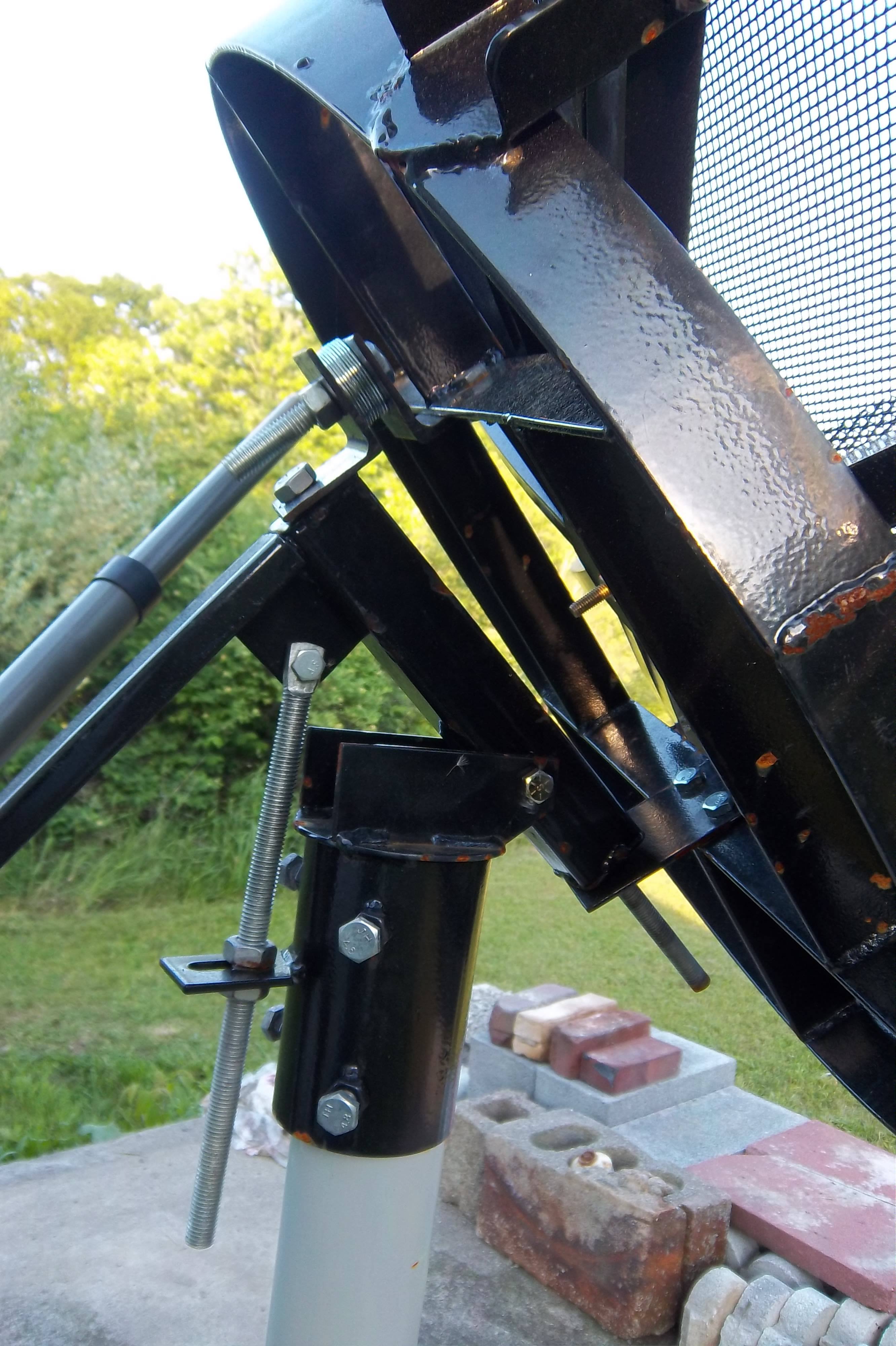

Protect those polar axis pivot bolts with some grease ASAP. (Looks like no bushing or bearing??) Don't need them wearing out or freezing up. I'd lube them first with something that flows fairly well the cover them up with wheel bearing grease. Maybe even 'needle' some into the gap between the moveable and stationary parts? I'd also use some (at least WD40) on the elevation bolt threads and nuts. Then check/reapply twice a year.
I've believed that little horizontal 'tab' for the elevation adjuster is a weak spot. Seen them broken off many times BITD on others 'economy' dishes. If you have someone lift or push down on the dish and can see it flex at all (I.E. wind forces): Our 'Permanent Fix' was to weld on a vertical tab in it's place and use a turnbuckle in place of the threaded rod..

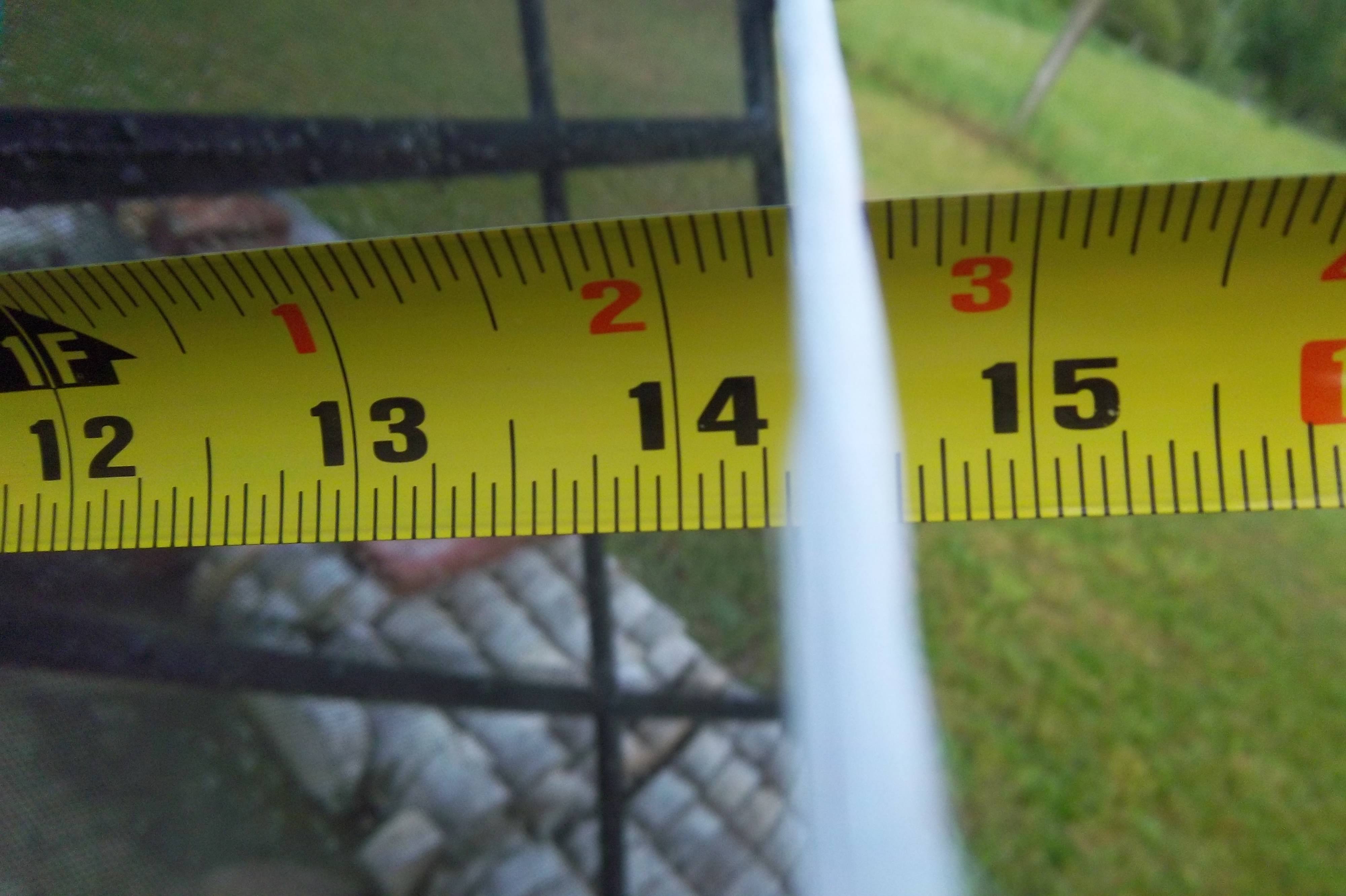

How about, while you continue tweaking the dish, post some specifications? especially dish depth. (string across face, measure from string to bottom center of dish) And best focal length, when tuned up, dish to front edge of feed throat? And how 'close' was it as originally assembled?

Yep, still lots of tweaking and weatherizing to do. :rainThanks for the great tips! I will keep an eye on that elevation tab for any sign of weakness. By the way, there were two bushings (which appear to be brass) that tapped into each end of the square tube on the polar mount. Definitely feel the mount could be improved but it does work so I guess it is what it is unless I get brave and replace it. I will get some specs and more pics up as I go. :)
Put a string on face of dish and measured it tonight. It is about 14.5" deep. Also another picture of dish that shows depth better. 100_1444.JPG 100_1415.JPG
