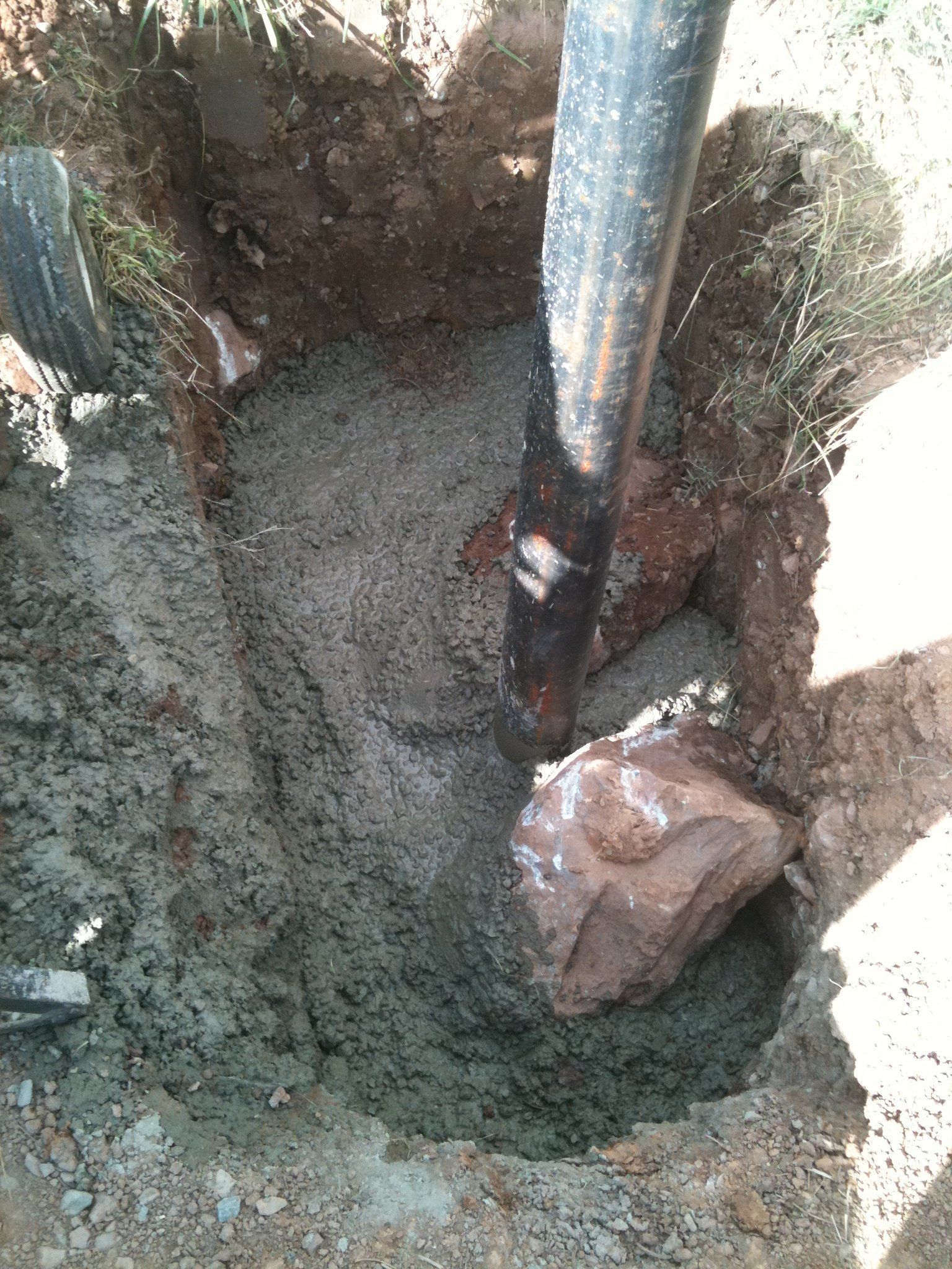

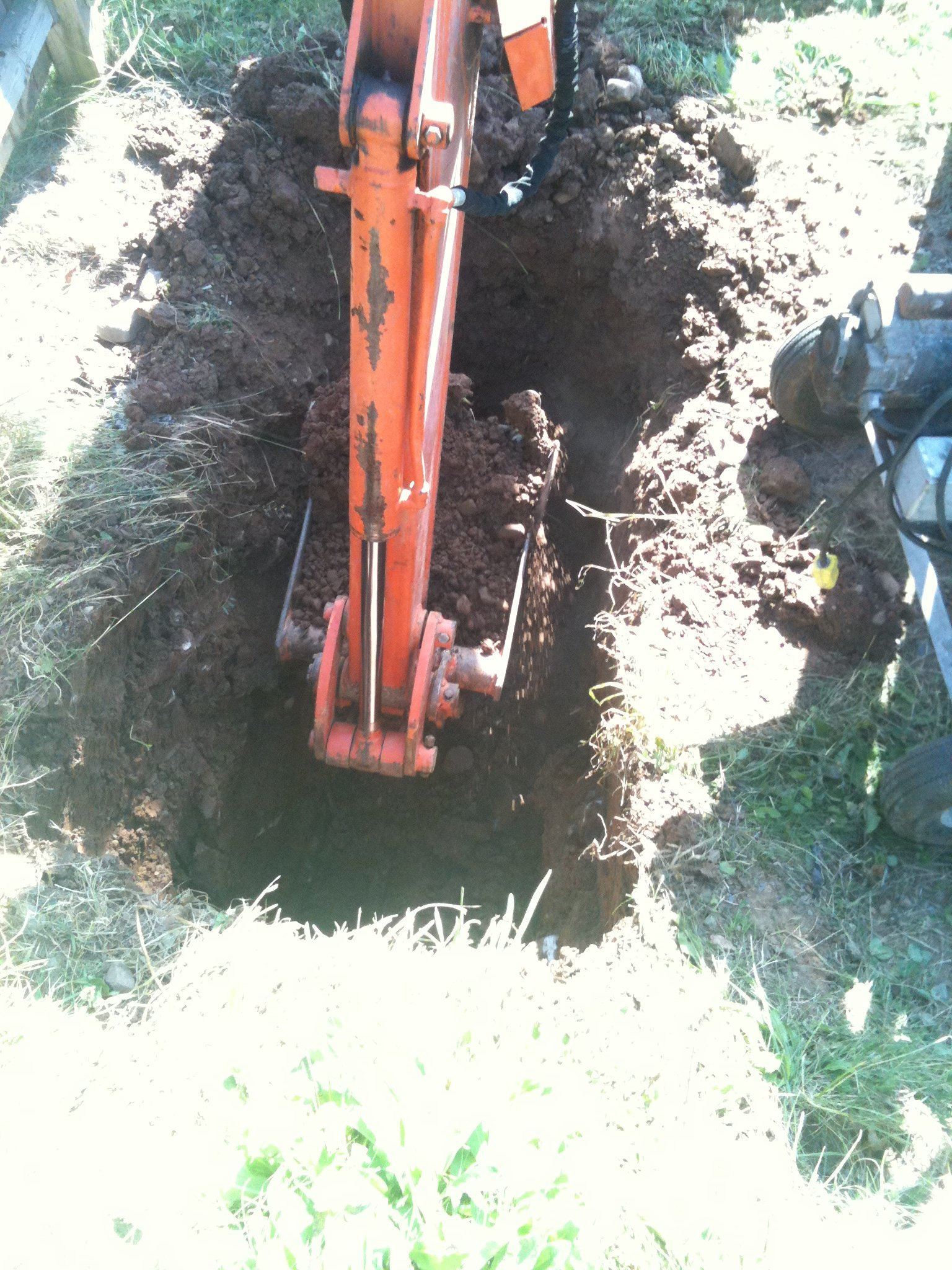

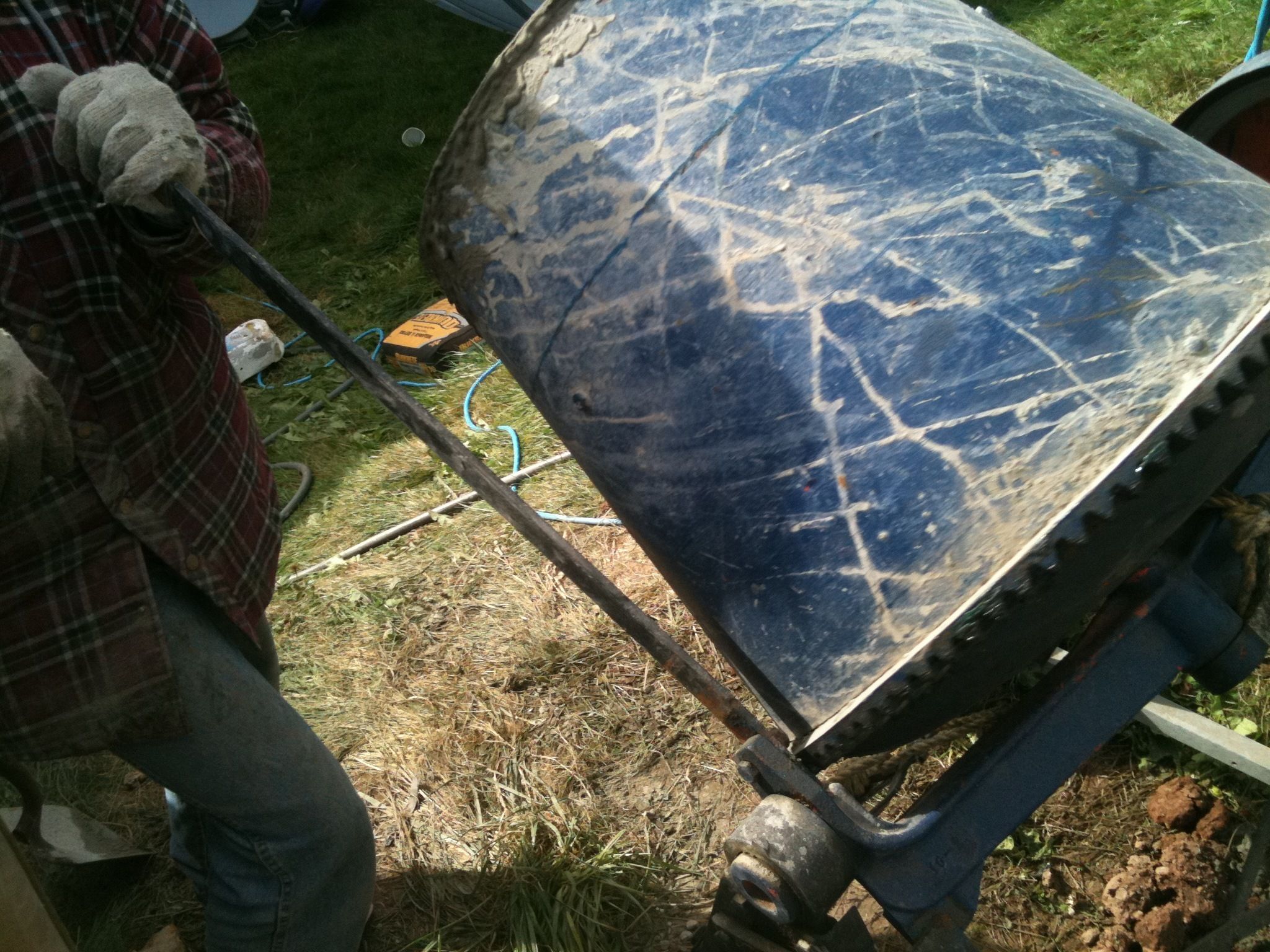

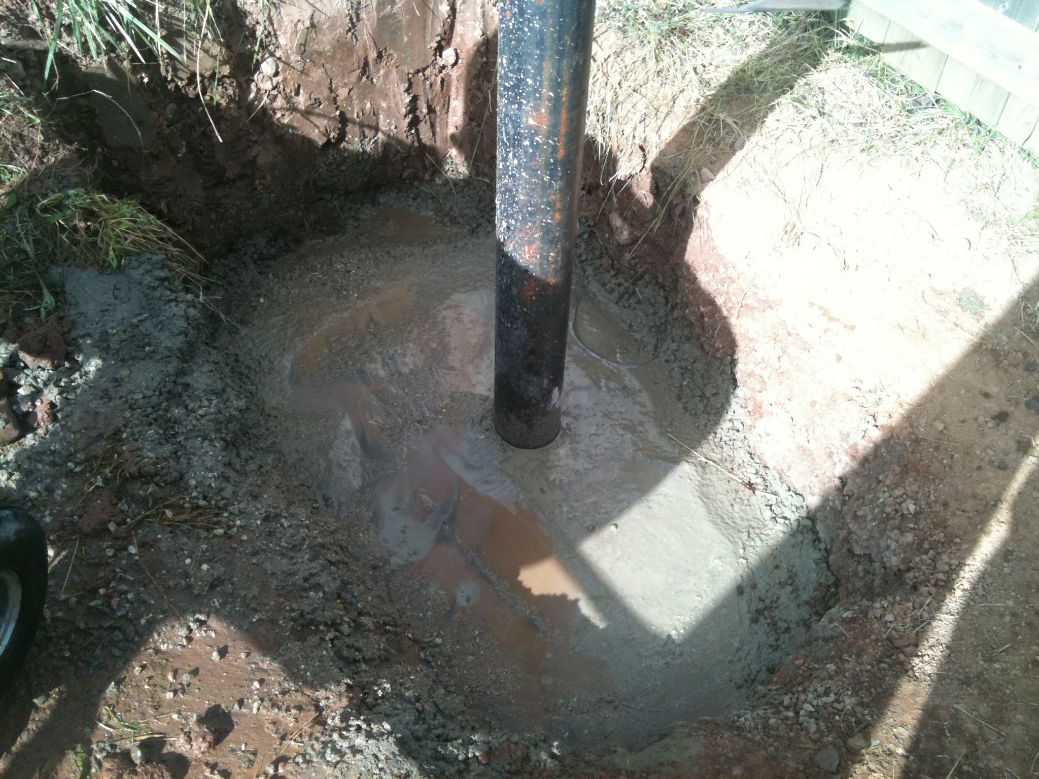

Because of the size of the dish and size of the pole (sched 80 4.5" OD 17' tall) I wanted I got a guy with an excavator to come over to dig the hole. 6' deep, 5' long, and 3' wide. The rocks... man oh man the rocks. I know why there's a hill in the back yard now. 45 bags of premix later and 20 cubic feet of backfill over the top the pole is in, with a big spur at the bottom. I knew I'd have to wait until Monday to get the dish up. The pole is 5 feet in the ground, 12 feet out.

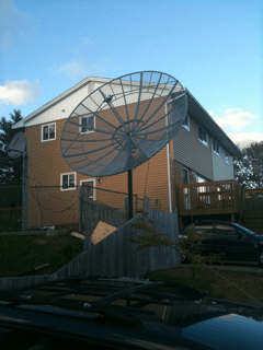

After a couple of hours extending actuator wire and a bit of tweaking it's up I just got back in about 45 minutes ago after having a lamp out with me. It's tweaked, peaked, and doing great! All my 9/10 S2 transponders have jumped 20-25 points on the Azbox over the 7.5. That with the dish being a bit warped. String test passed though. I can grab NBC on AMC 18 now and I could barely get 54%. Now I get 80%. Most 9/10 fecs are 85-90%. I only got as much as 71% before. I also can get another 4 degrees of arc, over to 123 before the house is a problem. And Anik F3, I could only get 28% Q on the Azbox but now I get 80%.

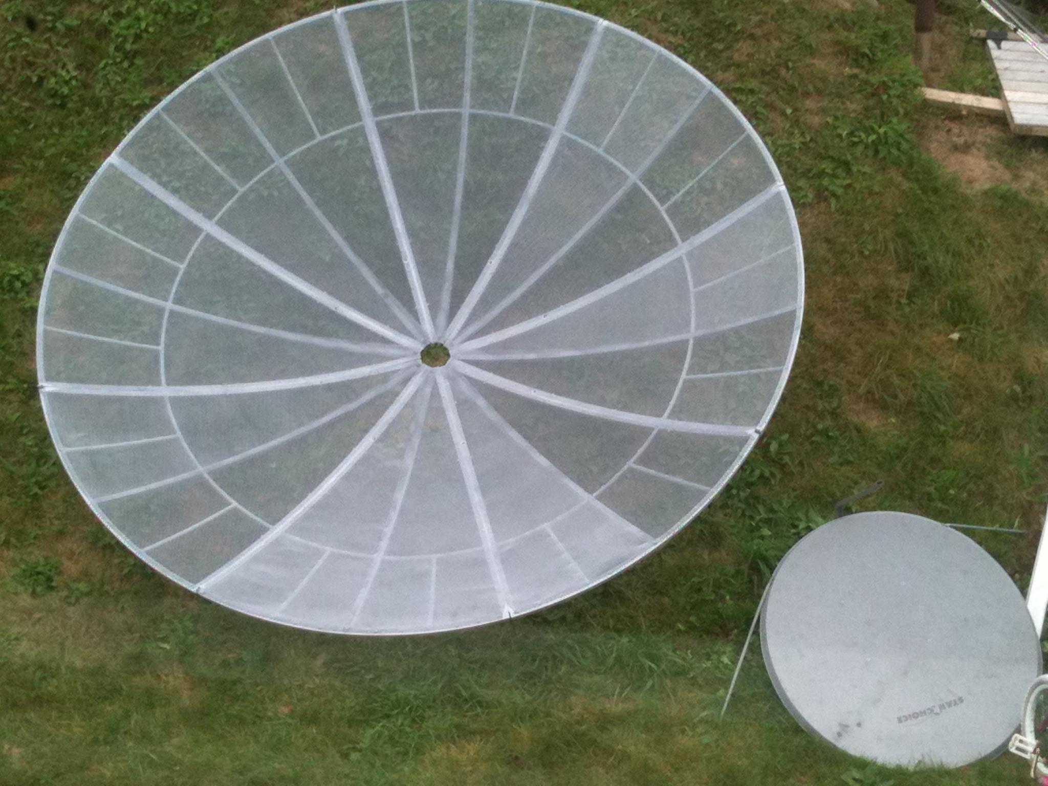

After ever bit of crap today at least it worked out. I've got some pictures here. The first one is the BUD next to a 40" StarChoice round. A few of the hole and concrete pour. The only ones I don't have is of the dish going up and of it actually up. Got too dark. I'll post that tomorrow.
