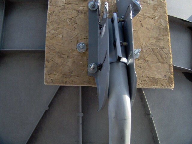

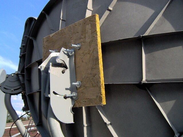

Well I decided to put my Primestar dish up today. Now the only mast I had was a Dish500 mast so I couldn't use the 2 3/8" holder for the P*
So I found an old bracket for a 24" dish and sawed the arm off. Got some longer bolts and ran over to my dad's (he's the handyman...not me) :D
Cut a 12" x 12" piece of plywood and drilled a few holes. Insert bolts and voila....lighter bracket :)

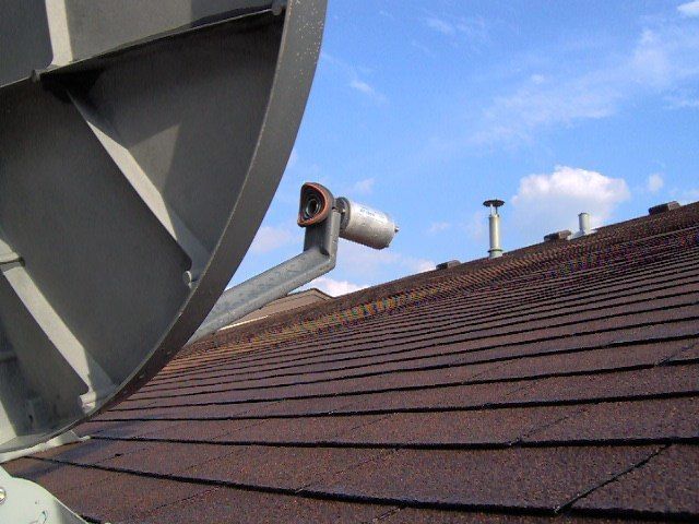

BINGO...you were right Al. I had removed the LNB portion a while back to try a different LNB with the same flange. Well when I put the P* LNB back on, I installed it with both coaxes the same level. Undid the 4 screws and turned it 90 degrees so the coaxes were up and down and boom. Now its working fine :)

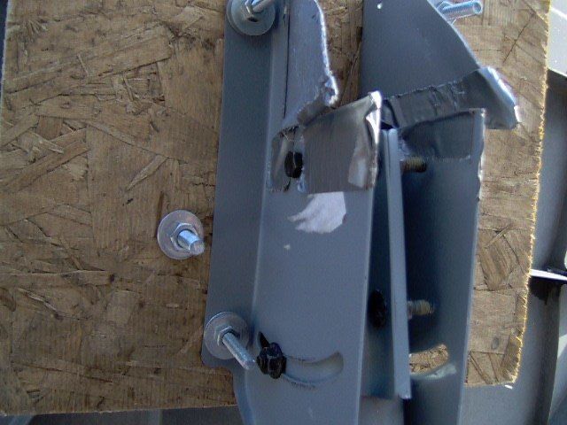

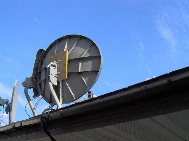

Here's some pictures of the modified P* dish fitting on a 1 5/8" mast :)
On the 3rd picture, you can see part of the bracket sawed (the top portion). The 24" dish I use to have was attached to a motor and to get the motor to fit properly I had to hacksaw part of the bracket and "fold" it down :)

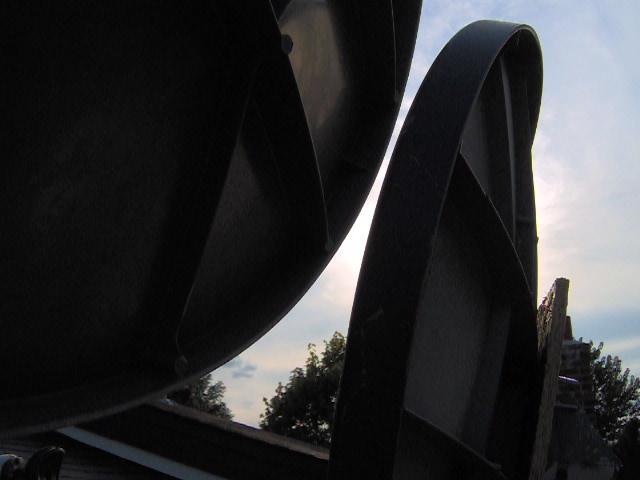

Lat picture shows how much room I have before it hits my StarChoice dish. I can see IA6 before it touches the SC dish

Nice pictures! Good idea! So IA-6 @ 93ºw is as far east as you can go with it?
IA6 is as far east as I can go before it hits the SC dish. If I put the P* dish in front of the SC dish, I could see from AMC4 west. I don't know har far west I can go because the pole is a little small and the dish may hit the roof
Its at IA8 right now. Was going to climb on roof to take pictures of the front but roof is really hot.
