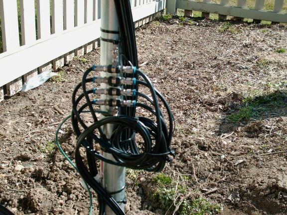

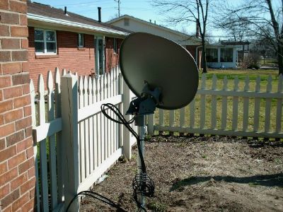

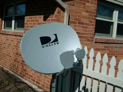

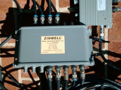

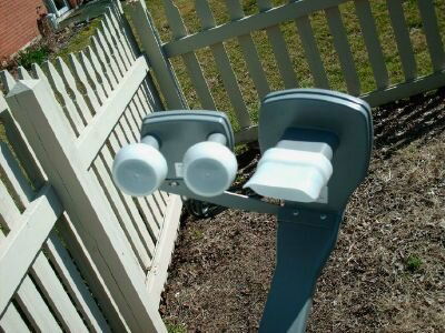

I got my new dish on Saturday! The installers BIRDOG signal meter stopped functioning so he used a crappy channel master thing powered by a receiver. He says he will come back this week once his BIRDOG is fixed and fine tune the dish once more.

great install. im not being picky, the only thing i do different, the multiswitch. i mount all mine vertical, not horizontal. other than that, again, great install. congrats.
Thanks! The multiswitch is actually mounted vertically, i held my camera sideways so you could read the sticker on the switch. Thanks for noticing and for the tip!
dragon...
I was looking at his pictures and I noticed that the grounding blocks were attached to the mast. I hadn't considered that and I think it's a good idea and will do that when I upgrade. But I have one question. I see that the ground wire is still run, I assume to a pipe or a ground rod. Wouldn't the mast itself serve as a grounding point since it is in the ground? Does putting it in concrete make a difference on that?
ground rods per the national electrical code go down 8 feet and are copper. my own thoughts , i agree with you.

I had my installer ground to my mast as well since it is 8+ feet in the ground. But he also ran to the main ground. I wish D* would have a house box like the cable companies do to put the multi switch in so it is out of the weather. Think i am going to go find one myself, unless I can bribe dragon to come over and help me move it inside this spring!!! I already know he like I.C.Light!!!

I will pm you my address. Will it be big enough to hold that massive multiswitch?

I agree! I think D* should have a larger box than cable does to hide all the ugly coax cables. I doan't have a basement so outside is the only place for me.I think I'm going to get an outdoor telco. box to hold all om my sat stuff too. I had a thread a while ago, but it didn't workout! Someone said to go to a hardware store and they would have stuff like that. I have one of those plastic cable boxes but it doesn't have enough room for the new multi-switch.

To make my multiswitch waterproof.....I installed it in a exterior lawn sprinkler box....Home Depot had them on sale a few months ago for about $10.00.....works great.
