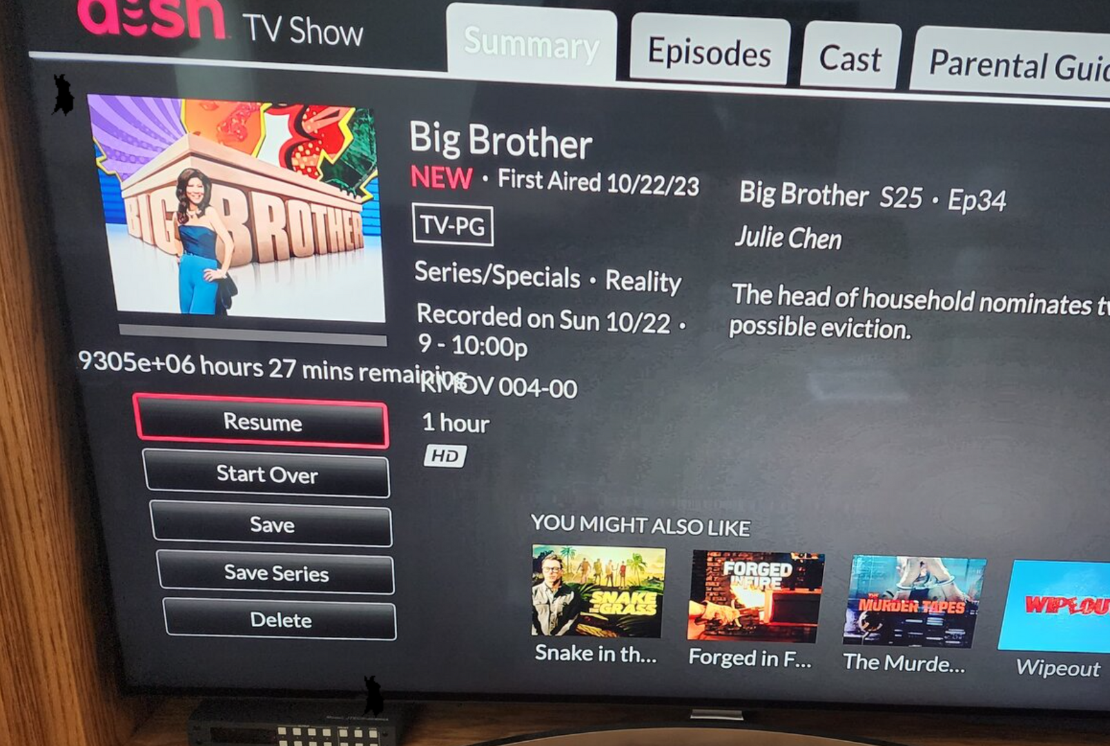

I've also never saw anything more than 980 hours remaining although the longest recording I have is 2.5 hours and normally my recordings are 1 Hr-2.5Hrs long so 9305+e6 hours remaining is 9,305,000,000 hours remaining.
